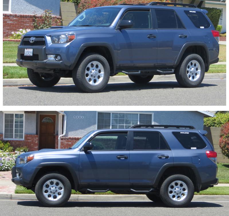

Replaced mine with 5100s the first month, slightly firmer and feeling of better control. I'm at 0.85 in front, no spacers in the rear. Photo is before adding AT tires.
