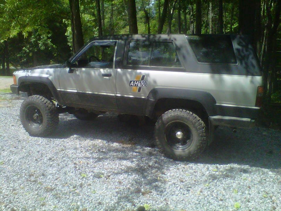

31's will still look alright with a 2 in lift. Power will feel better, but your gearing is pretty low if you go down to a 31"
85 with 3in lift on 31s
31's should look right at home with 2" lift. They looked really oversized on factory height, wven though they were a faxtory option. It's a lot of tire.
