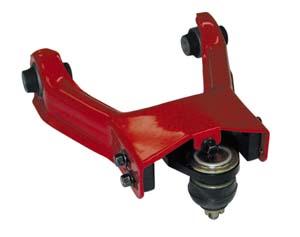

Light Racing UCA's Light Racing UCA - Adjustable Upper Control Arm Set
Camburg Camburg Upper Control Arms - Uni-Ball
Total Chaos Total Chaos Upper Control Arms Set - Early Tacoma & 4Runner
I would love to hear what you all have to say about them, make me the best recommendation. I'd like to get a kit that has all the replacement hardwear so I don't re-use the old stuff.

I had the the Total Chaos UCAs on my Tacoma. They are great, really well made, got me aligned where I needed to be and helped the suspension flex a little better.
The Uniball is exposed, you have to clean and lube it regularly. I highly recommend the stainless steel uniballs. I got the regular ones and they deteriorated from road salt pretty quickly. Had to press them out and replace with the SS units.
LR usually run the cheapest and several people really like them. How much time do you spend on trails?
When I build out my t4r (soon), the front end is going to include TC UCA's. The uniball construction is the way to go for lifted and extended travel. Total Chaos UCA's cost a bit more than others, but for good reason.
I had Light Racing UCAs on my Tacoma along with extended travel Icon COs.
The ball joints failed and did so WAY too early in my opinion. The idea behind the LR construction seems good, but I had bad luck with them holding up.
LR offers the most fixed adjustability (if that makes sense), but uses a ball joint. The way it is set up though you still get more down travel than the factory arms. Ball joints are also sealed vs open like the uniballs in TC and Camburg.
Camburg and Total Chaos are almost identical in design. If you don't believe me go find a store that has them both, or find vehicles with them. I've looked at them in person and couldn't tell a difference really besides color and I think the Camburg arms have a brake line bracket. Camburg is cheaper and uses a different company for uniballs I think. Either would be a good choice and both now have zerk fittings for the bushings. You really can't go wrong with either option.
Icon offers a sealed uniball, but is not worth the hefty price in my opinion. Other than the sealed uniball they are comparable to TC and Camburg.
I have the TC arms and have Tundra billies and springs on the third perch and I was able to get my truck aligned to spec with these arms. I don't have issues with the springs contacting the arms or spindle either. This has been reported with every aftermarket UCA though depending on the setup you have. I like TC arms a lot and would recommend them to anyone.
