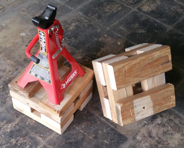

I had to take it to a shop, since the old shock mounting bolts were shearing off. The only complication I didn't foresee was with the lift, my jack stands are now too short and I had to get a new hydraulic jack. The old jack won't lift the frame high enough.
Somewhat OT, but I had this problem and in case the OP encounters it I wanted to share my $10 fix:
Ive got to make some of those. I am uncomfortable raising a 3 ton jack stand to its highest setting... not very safe.
