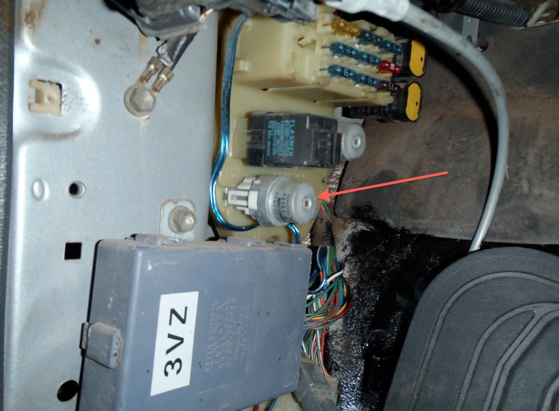

I want to check it but have no idea which one it is or where it is. May be causing my misfire? It's definitely something electrical causing it.

We have a 1990 3.0, and the EFI relay on it is located on the passenger side fender wall of the engine bay. Definitely worth replacing, and having a spare in the glove box.

FWIW: The efi relay either works or it doesn't. If it didn't work then your engine will not start. I don't think that your EFI relay will cause a misfire. The EFI relay is nothing more than a switch that sends power to your efi system (just the ecu I believe).
Not always, if the contacts are corroded, they can cause a whole host of gremlins that are near impossible to track down. The relay is inexpensive enough($12), it should be considered a maintenance item(ie every 60k or 10 years).

Grab a multimeter and test your efi relay to rule it out. There's a test in the FSM for that.
I would be willing to bet that you fried a ground or hot wire somewhere in your wire harness. Follow your wire harness from the wires that you connected and inspect the wires for any hot marks in the sleeve and look for any bad wires and ground spots.
