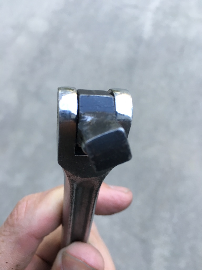

Good call on the 1/2" breaker bar. I initially tried using my 3/8" breaker bar, and let's just say the results were not pretty. Still need to see if Craftsman will warranty that bar out.........
I stepped up to a 1/2" breaker with a cheater and broke them loose. I am not in the rust-belt, fwiw.
