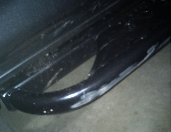

I price shopped sliders and found Shrockworks Step Sliders to be the best deal.
They are already powder coated and they ship fast. I had mine within a week of ordering them.
5th Gen Toyota 4Runner Rock Sliders, 2010-2019
Install was a ***** but buying longer bolts from the local hardware store made everything easier / faster.
I'm glad I had them on offroading in the Ozark National Forest a couple weeks ago as part of the Rendezvous in the Ozarks. They protected my truck from getting body damage.
