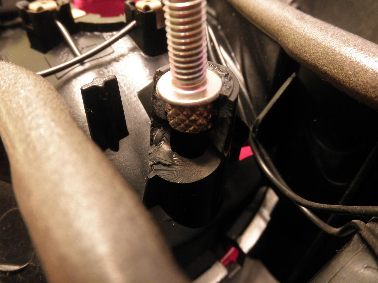

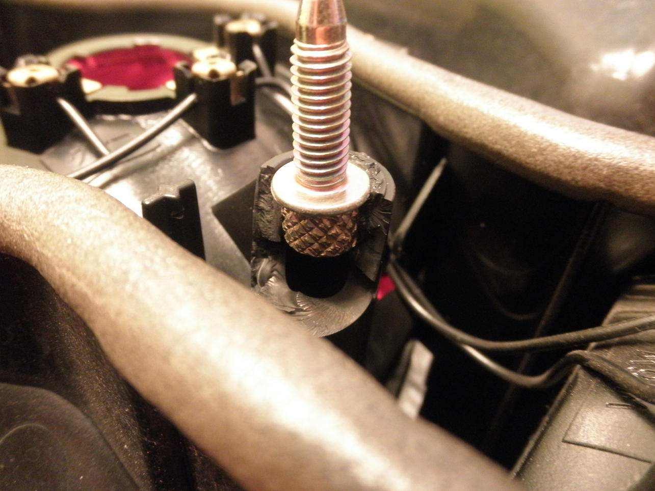

I bought my LED rears about a year ago. When I went to pop out the originals one of the studs broke out. I am going to re-install the original taillights and need some suggestions on what adhesive to use to hold the post.
Unfortunately I lost the piece that broke out. Any suggestions on what to use to fill it in?
Thanks.
use jb stick first, and plug the holes, then use the jb weld for permanet fix, i do the same when i retrofit my hid projectors.
I would wrap the plastic boss with masking tape, not tightly, like around where the missing plastic would be. Then fill it with a two part epoxy.
