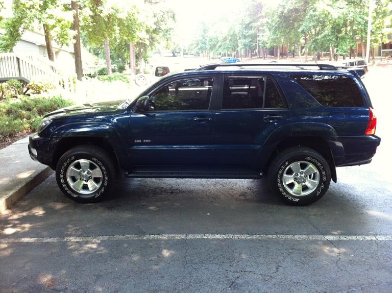

Here is a recent photo of mine with 1.5" rake and my 265/70/17 Bridgestone Revo 2s installed. In this picture I have my 5100s set at .85 which is the 2nd notch (1" lift). I also have the 1.25 All-pro spacers installed in this photo.
Measurements are 35.5" F and 37" R (Its on a hill so it looks more even than it really is)
Thanks Sonic, your runner looks sick. Believe me when I say I've done a TON of research on this subject but it seems like everyone gets something different each time. The reason I'm doing the FJ coils w/ Billies is because it fits my needs (level front, slight overall lift). I really want it level, maybe a 1/2" rake at the most. My biggest pet peeve with the 4th Gen is that "station wagon" look with the stock suspension. I loved the aggressive look of my stock 3rd gen.
