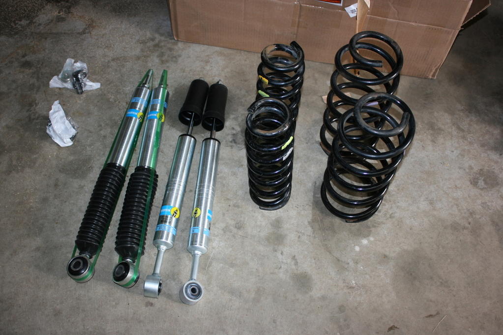

Well, I was able to get the fronts installed (1.75 setting) and it looks perfect. Didnt get a chance to do the rears but we're completing those today and I'll post pics. Got hung up yesterday helping my buddy weld some brackets on his Taco. His setup is freakin' ridiculous. It's basically a mini trophy truck now. I'll post a few pics late...
Got 'er done
Finally done! And wow what a difference! I would like to thank ARK_SWAMP_RIDER and others for giving me the idea of going with a FJC / Bilstein setup. I swear I was addicted to looking at his thread and others who have done the swap. :thanks:

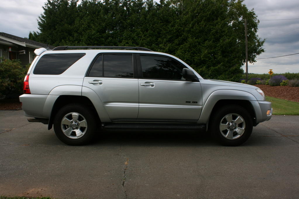

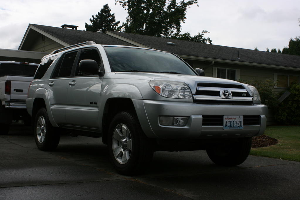

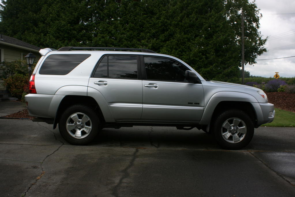

I'm pretty sure the suspension we took off was the original so it had 95k miles on it. It was soft, mushy, and made my runner look like a station wagon. First impression of the new setup is amazing! It sucks up bumps way better and gives the runner a smoother ride in my opinion. Makes it feel more like a truck (I know those two sentences don't go together but they do). And of course, it looks so much better! I'm glad I went with the 1.75 setting as I got about that in lift up front, leveling the truck out. Here are my before and after measurements:
Before
front pass: 33.5"
front driver: 33.25"
rear pass: 35.5"
rear driver: 35.5"
After FJC/Bilstein 5100's (1.75 setting)
front pass: 35.25"
front driver: 35.25"
rear pass: 35.75"
rear driver: 35.75"
I received approx. 2" of lift in front and only about .25" in the rear. I love the new look and it just feels so much nicer. I also, plasti-dipped my emblems, removed the running boards, and adjusted my headlights down a little to compensate for the front lift. What do you guys think?

Looks great. 1/2" of overall rake is exactly what I wanted to see. I can see right away that you have more space in the front fender than I do. Only 1/4" in the rear is suprising. I still dont know how I ended up with 1" rear lift from the FJ springs. Looks like I can probably be safe with going up 1 notch and not having to lift the rear.
Those 1.25 spacers will get those wheels pretty level with the fender. It looks much better after that IMO. Then what is next tires??? You will be able to go up a size or so now that you've got it lifted. Put a little more meat on the rim.
If you plasti-dip your wheels you should think about doing the headlight black out mod too. It would look good since you seem to be going with a Silver/black theme. It sounds hard but its actually a piece of cake and cheap too.
That photo looks like its on a hill can you take one on a completely flat surface so we can really see what the rake looks like? Oh and how do you like the new ride? I noticed a big change in the way mine handles. A lot less body roll and nose dive when I brake. Plus going from 120k miles on the springs/shocks to 0 miles made those bumps in the road feel a lot better.

The photo was taken on flat ground, I think I was just leaning a little (maybe after those beers we drank when it was finished). I'll be taking some better pics when the weather clears up, we've been having some weird summer weather this year in the Pac NW...the ride is AMAZINGLY better. My stock suspension had 95k miles on it and like you said, going to 0 miles on it, what a difference!
Looks great, man! I knew the 1.75 setting would turn out better :) Thanks for sharing the pictures. I bet now you are just praying that those tires will just wear down FAST!! LOL
