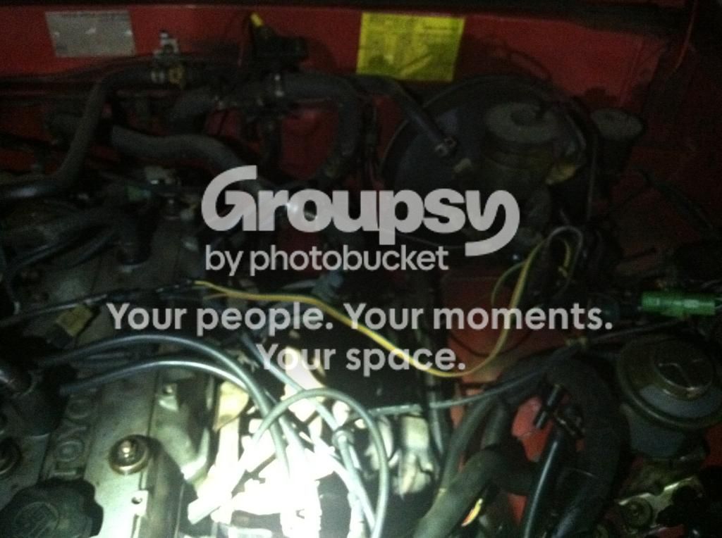

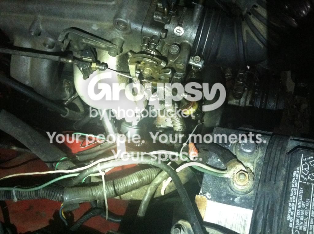

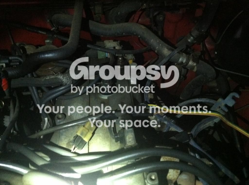

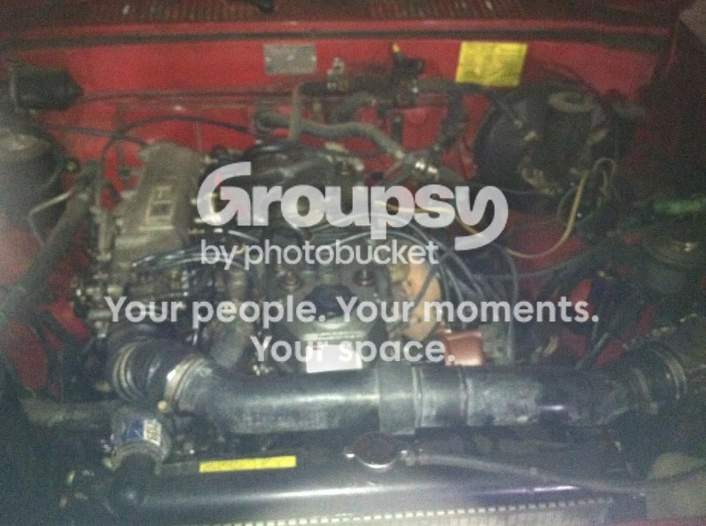

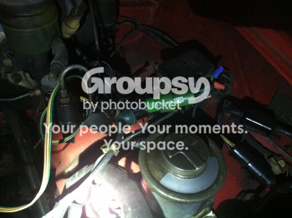

These are some of the suspect wiring jobs, sorry for the low quality pics it was dark when I checked it out.
If you're ready for a project and the body is clean and straight and minimal rust, $600 is reasonable. The front main is easy to replace. The bogging sounds more like a fuel issue than the TPS. The wiring is definitely a mess - wire nuts and electrical tape? Plan on repairing those sections right.
