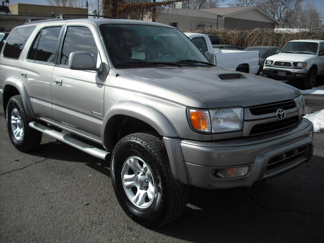

When I got mine (out of Denver) it had Fortera Tripletreds on it and they look decent. Definitely fit the bill for what she is looking for.
