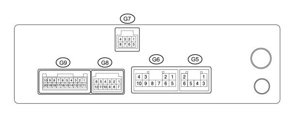

maxx0695, I'm looking at the pin layout for the 8-speaker Radio Reciever Assembly.
Here is the code as written:
Pins
G9-3 (SPD) - G6-7 (GND)
Wire color
It's described as "Speed signal from combination meter".
