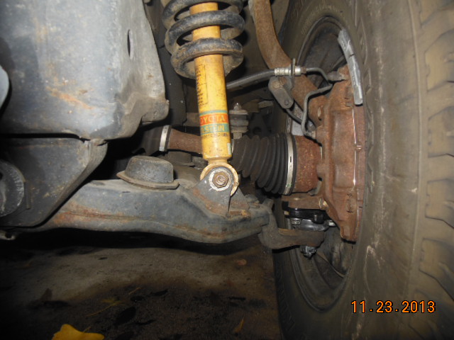

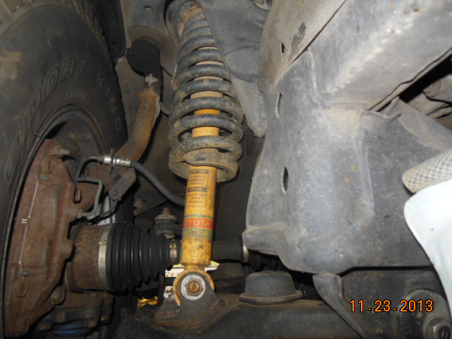

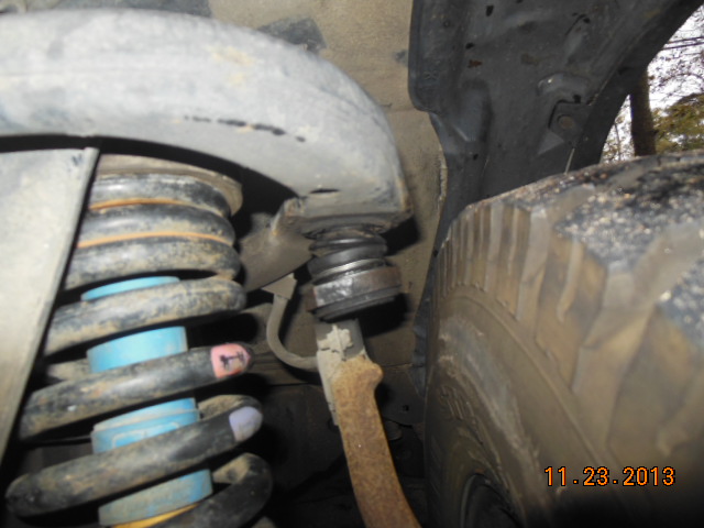

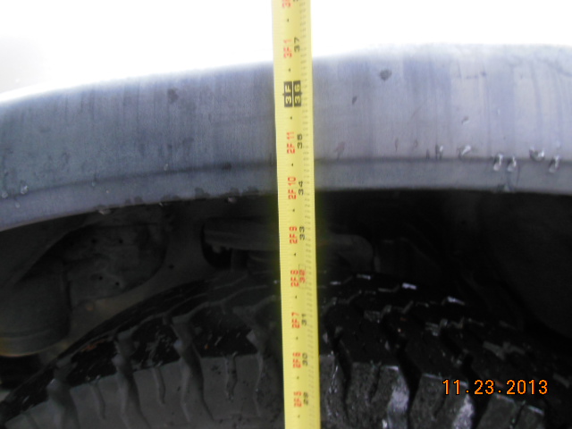

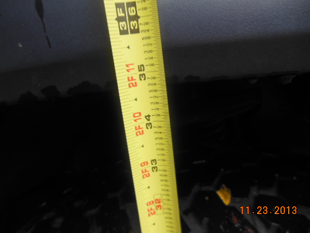

Pictures in the order
TRD taco strut and spring on front right in my 4runner
TRD strut (CV is in an angle due to a 2 inch top spacer, the 5th picture shows the height before I install this top spacer)
TRD left strut (Before the 2 inch top spacer installation)
With factory 4runner spring (right side, measured from the ground, tires 265 75 16)
With TRD taco spring (SR5 97 flares) Measuring tape runs through the highest point of the tire.
