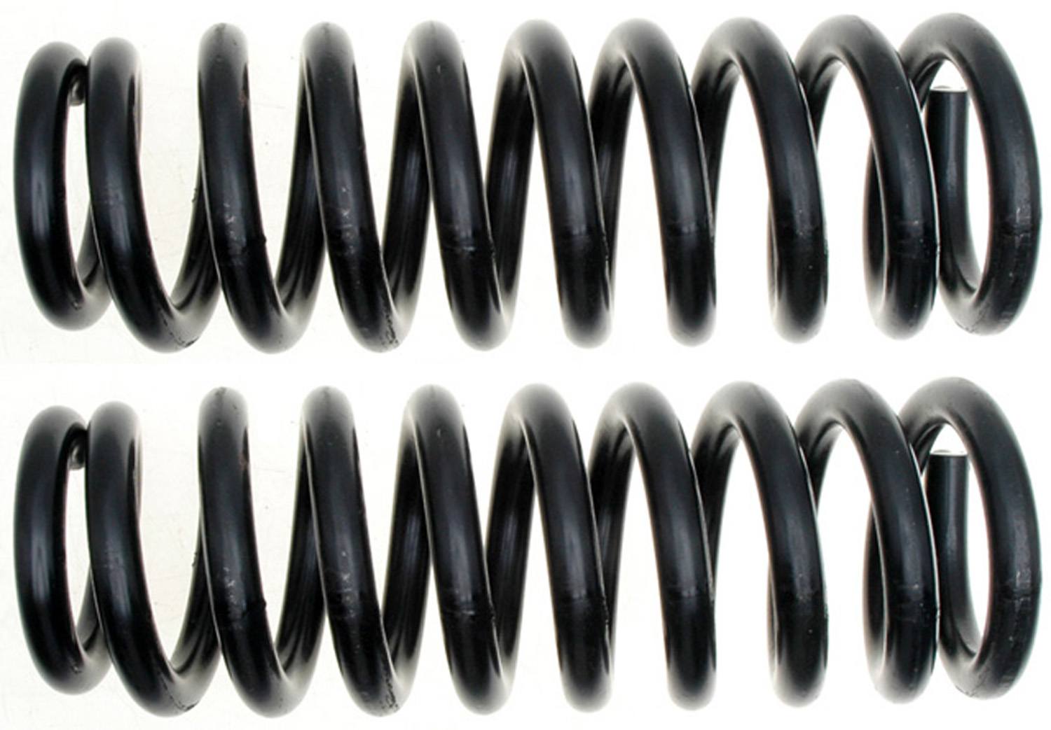

Unfortunately the only specs I found were for aftermarket,not OEM. I searched Rock Auto (entered 2003 Tacoma) and found Moog # 81104 and AC Delco # 45H0376. Moog's are 595 lbs/inch fixed rate,no specs on AC Delco but the picture shows the same spacing between each coil except for the very last one http://images.wrenchead.com/smartpages/partinfo_resize/DCL/45H0376_Primary.jpg so I'm going to assume they're fixed rate.
