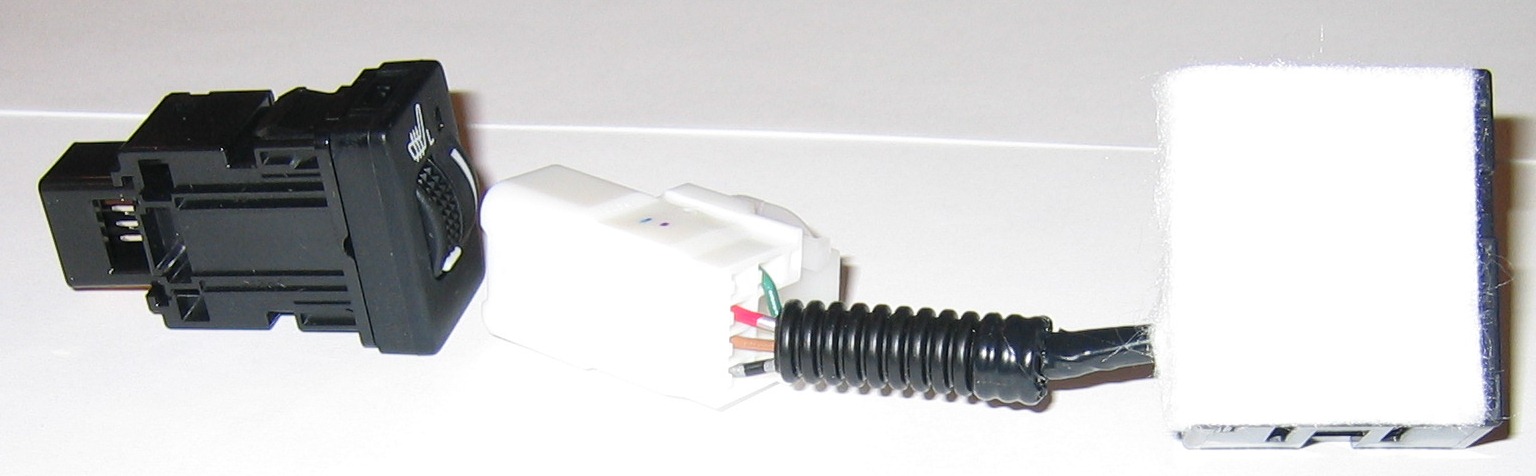

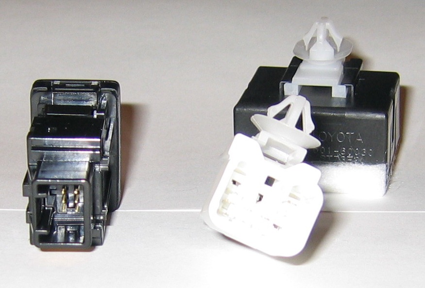

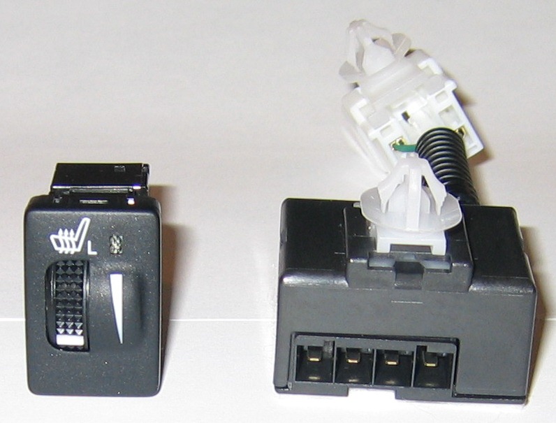

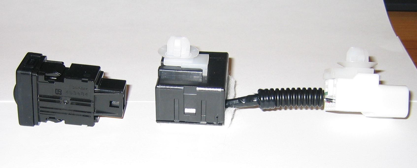

Does any one know where I can find the Wire Harness Repair Manual for a 2011 4Runner?
I need to find connectors for the items below.
Not sure what the item on the right is (I'm guessing it's for heated seats?), but Toyota doesn't sell hardly any plugs for their cars. Your best bet might be a trip to the junkyard.

Guys thank you for your help. I did look through the wiring diagrams and also found those numbes a2,b2, f2, f3 etc. the only problem is that it does not make sense. Keep in mind this switch and controller are the 2011 I am not sure if they are the same for the 2010.
For example if you look at "Seat heater switch LH - f2 Black" the shape of the connector and the number of pins do not match the switch I have pictured? My switch has 6 pins f2 looks like its setup for 10 pins?
Now the good news is the "Seat heater control LH- b2 White" connector does look like a good match.
Using the 2010 wiring diagrams the Seat heater control LH- b2 White - uses pins 1 (R), 4 (G),5 (V), & 6 (W-B) but the colors i have on the controller are Green, Red with silver dash, brown with silver dash , black with silver dash.
Anyway I will keep looking. Thanks for everyone's help. Does anyone know where I can get the 2011 wiring manual.

Need part number for the f2 connector
Ok I only need one more part number then I am good to go.
I need to find the part number for the f2 connector, this is the connector that will fit the left hand heated seat switch.
I have part numbers for all the connectors and repair wires so once I get this last part number (f2 connector) I will be able to order it and begin testing the switch and controller.
ToyotaPartsSales.com sells all the part as long as I can find the part number.
Ok I found out from the dealer that the f2 connector will have the part number on the connector so all I need is someone with heated seats to pop the connector off of the LH seat heater switch and find the number.
