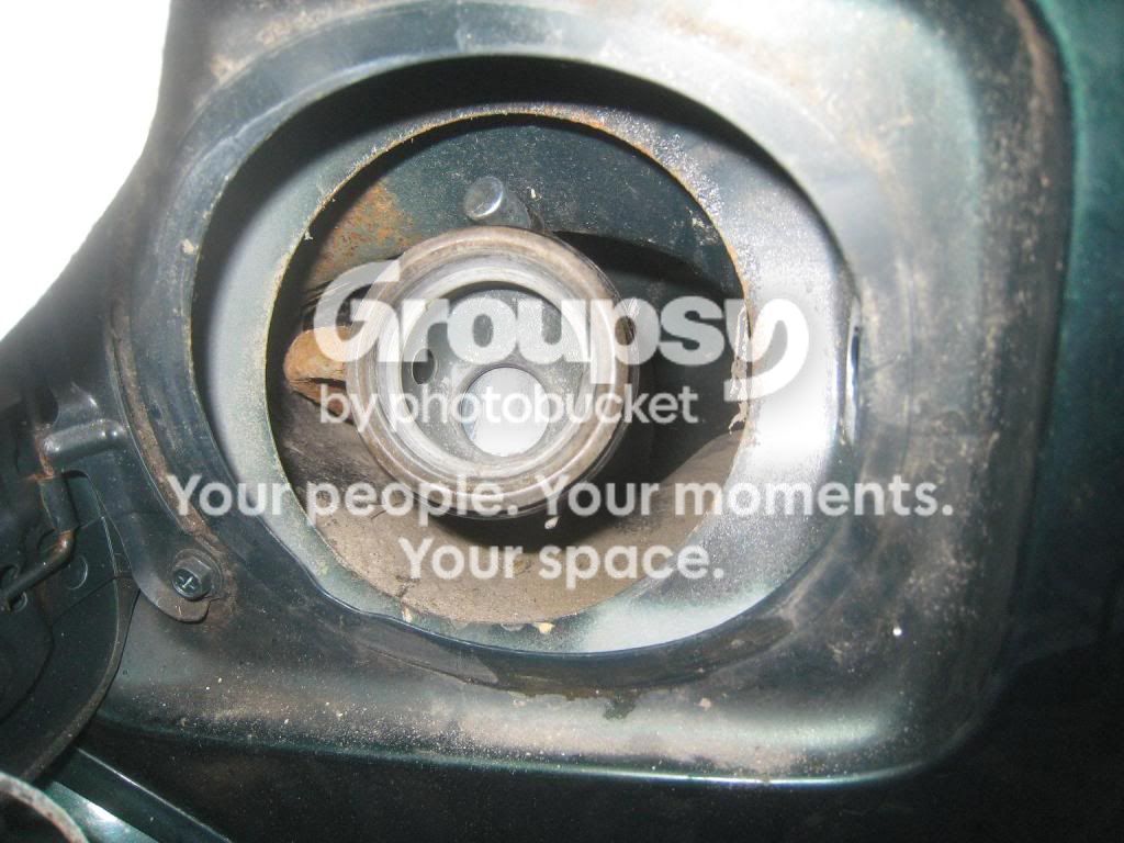

Mounted the tires - I found that the tundra rotor was alot thicker at the hub than the 4runner ones, and there wasn't nearly as much stud sticking out, and the wheel didn't sit as far back on the hub as it did with the 4runner rotors.

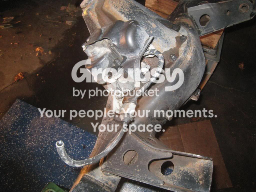

Bled the brakes - Pretty easy with spEed bleeders. Used most of a big bottle of fluid.
Did a tape measure alignment - I pulled out of the driveway without aligning, but it didn't feel very good and I could see some wicked toe so I pulled back in and did the tape measure alignment.
With all that done, I headed of to NTB for a proper alignment. I watched the guy do the alignment. They had brand new optical alignment machine that was pretty slick. I forgot to get the printout, but my camber was dead center, and my toe was only .1 deg out of spec. Not bad for the tape measure alignment!

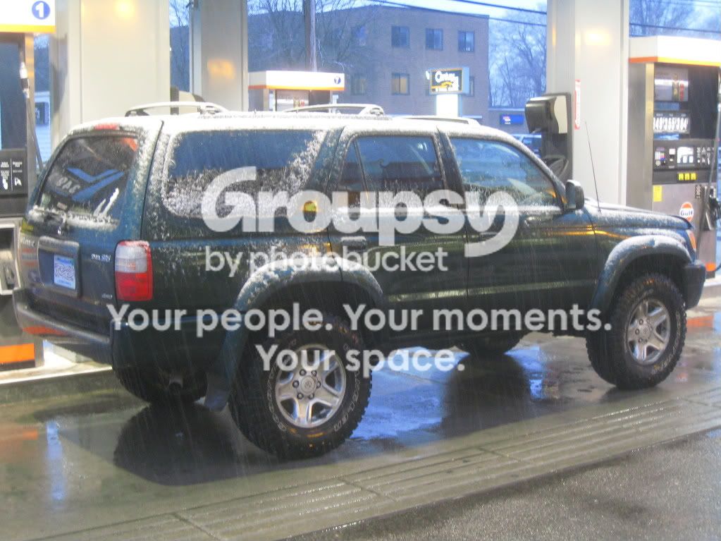

For the final shot...
Finished1.jpg~original
Purty and clean...
Sheila feels like a new car now. The steering is a little stiff, but I suspect that will relax as the TRE's are pretty stiff out of the box. Well see how it feels after my commute this week, but WOW, feels amazing.

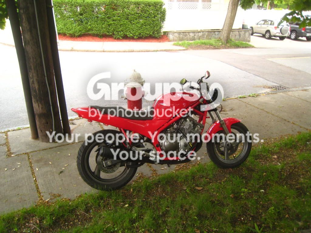

Here are some gratuitous shots of my other ride, since she was also vital to me in getting this project done; many trips to the parts stores, and a long trek around Boston for that pesky LBJ bolt.
IMG_0281.jpg~original
IMG_0264.jpg~original
Nice work!
What kind of bike is that? Sure in nice.
Thanks. It's a 1992 XJ600S, converted to an XJN (fairing removal). Here the link to my build thread on the motorcycle forum:
NelsonMD's XJ600 Build Thread

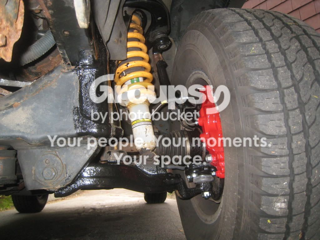

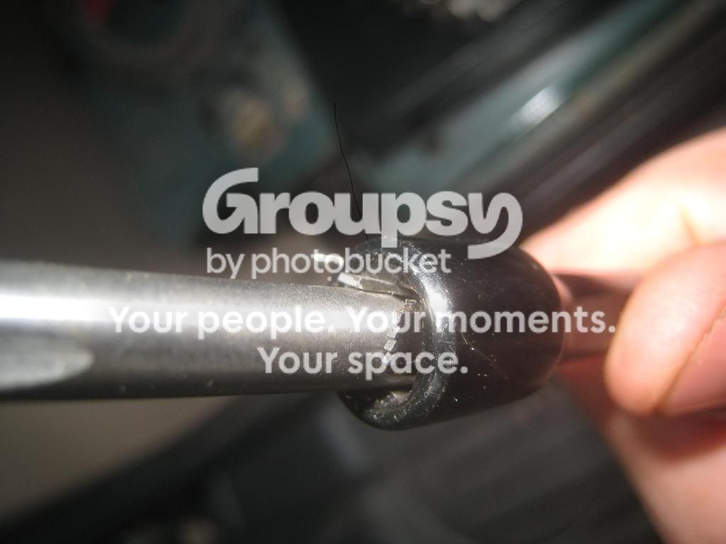

I have been thinking about this a it more, and I think I am going to downgrade my review of the Ironman front strut/coils to mediocre. As I mentioned before, one of he boots ripped right along one of the bellows, and now both are ripped in half. I have done nothing but street driving since putting them on, so they really havn't been pushed at all, just shoddy.

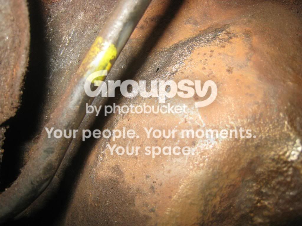

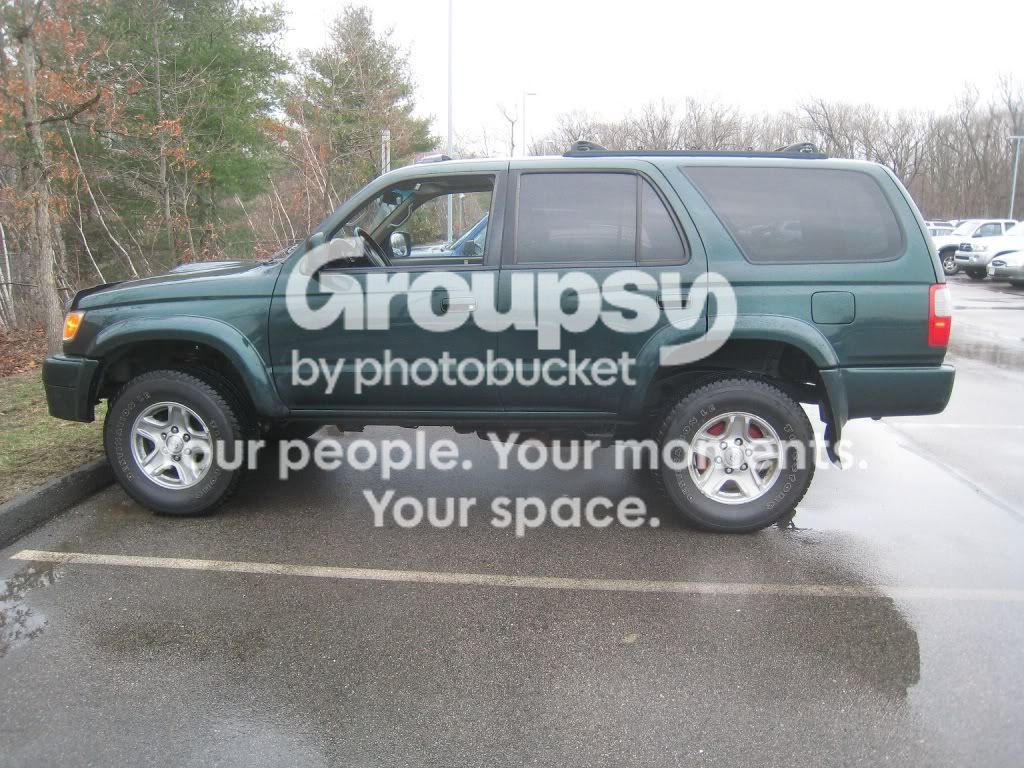

Also, if you look closely in this picture:
You can see some rubber coming out of the lower shock mount. This is the rubber bushing that came with the shocks erupting out of the joint. I have no idea why it would be doing this, I properly torqued everything when I installed, so it isn't just getting squeezed out from overtorqueing.
Anyway, I assume I will eventually have to rip out those shock bushings and put something new in, and I have non-functional boots now, so Ironman has not really impressed me so far. They ride fine, which is the most important thing, but that may be short lived when the bushings fail...

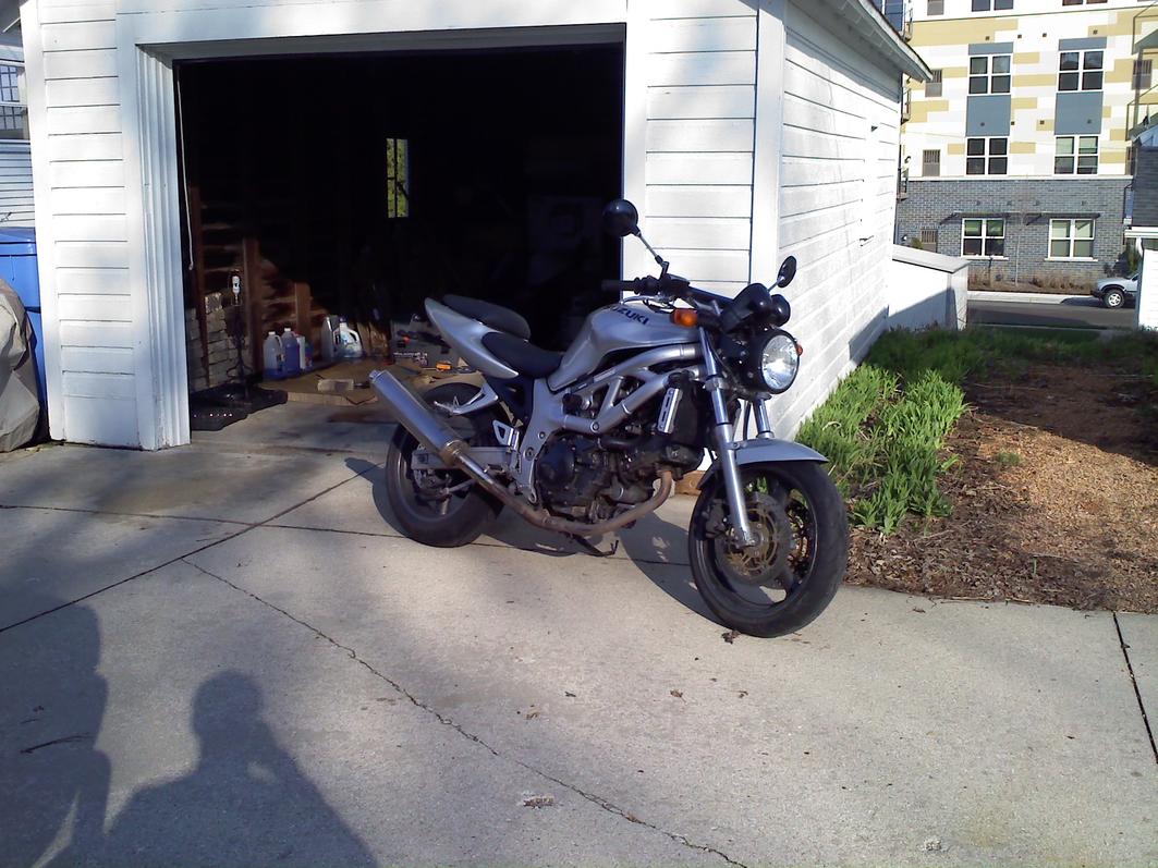

I kinda did the same thing on my Suzuki that you did. Mine was an S model, which meant it had the front fairing originally. The previous owner took off the fairing to give it the naked look, and he put on this garbage aftermarket headlight. It looked terrible and was worthless for light output. So I bought the brackets and parts and intalled the oem suzuki headlight for the naked version of my bike. Then I modified the brackets so the headlight would be a little lower and further inset to make it resemble a ducati monster.
Heres my 2000 Suzuki SV650

Yeah, they are not exciting bikes, but they are pretty bulletproof, have a really nice classic look, and are very comfortable (and cheap).
Those SV's are quite popular, I have seen a couple in the parking lot here at work. They are great, attractive bikes. I have thought about getting one if I were to get rid of mine. I think I will go more the cruiser route though, purely for comfort purposes. That headlight looks great though. I love the naked look.
You could really make it look like a Ducati by painting everything black and silver, and the frame red. I have actually had alot of people ask me if mine is a Ducati, even though it says "YAMAHA" right across the gas tank.
BTW, get a can of flame proof flat black paint and clean up that exhaust!
Ya the exhaust pipe is pretty ugly. I'll probably do that pretty soon. Ive been thinking about painting it, and the ducati colors are one option im considering. I really want to go pearl white with a red or black frame though. Not many bikes have that combo and Ive always likes pearl white.
The naked sv models are actually pretty comfortable. The pegs are lower to give more leg room, and the bars are pushed back some. It's sort of a crossover between a sport bike and touring bike as far as the seating stance.
