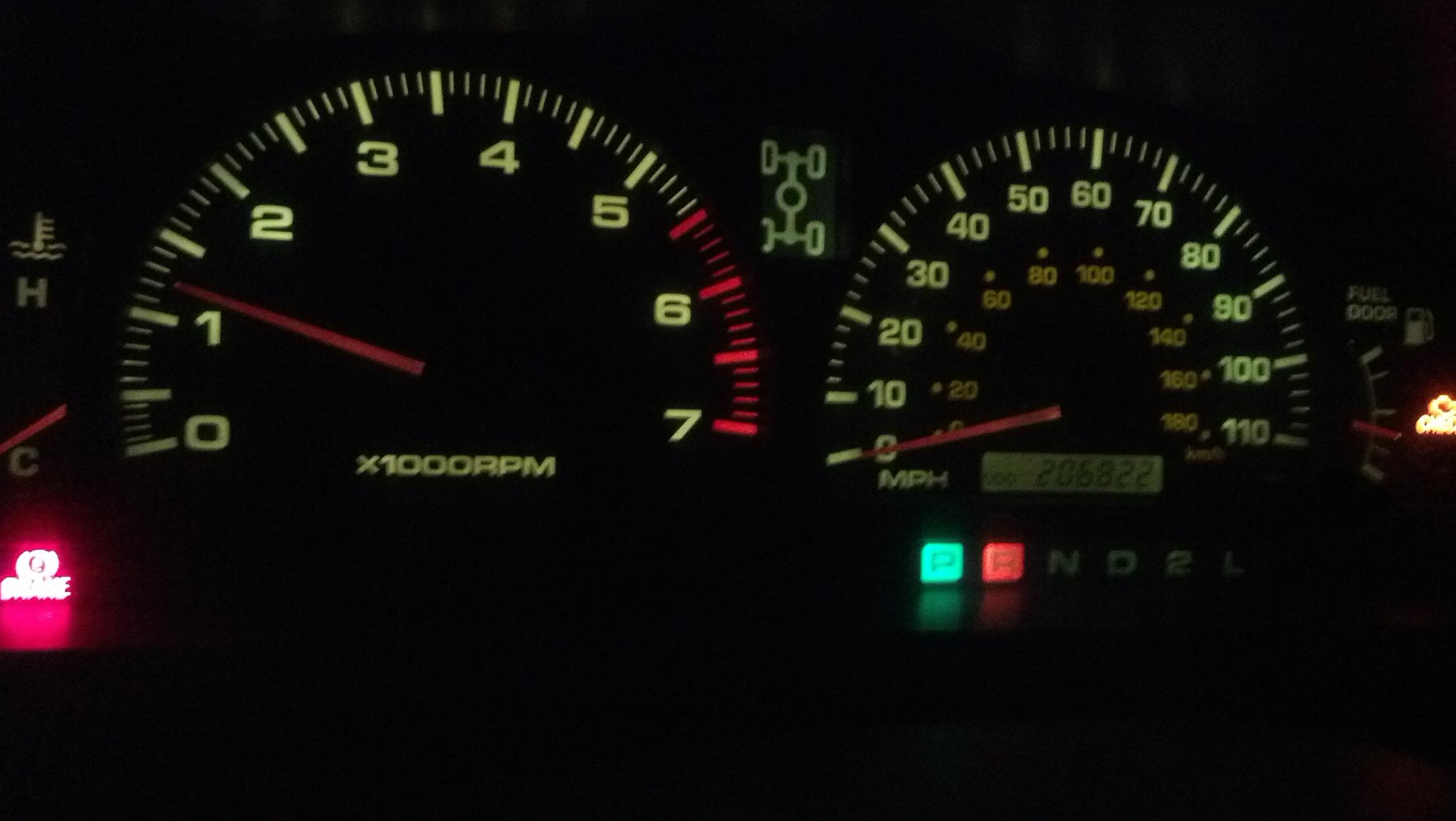

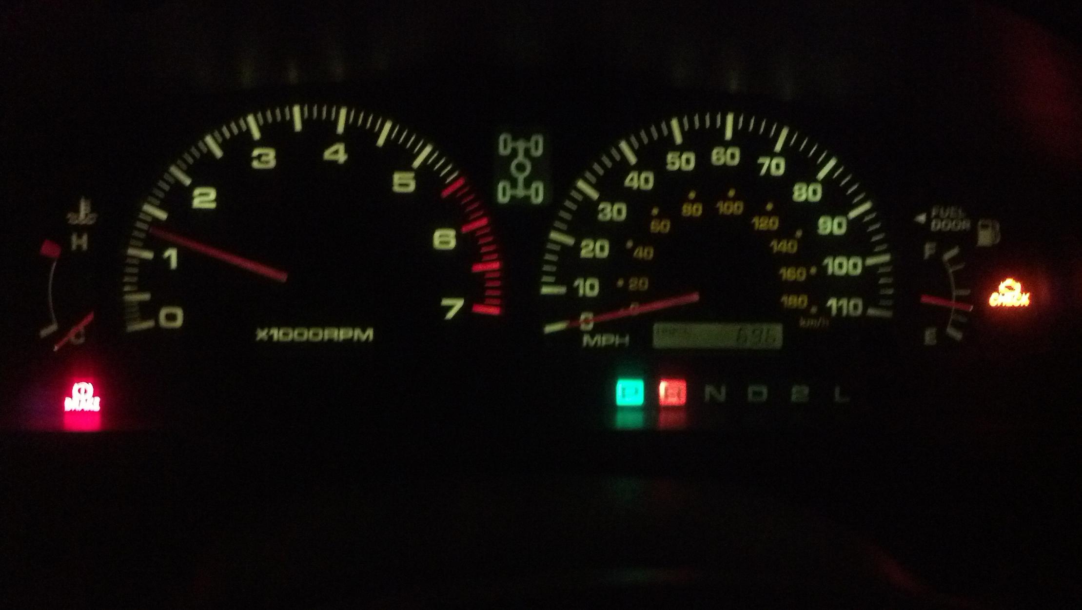

Here are my issues:
- the R, in the PRNDL2 display on the combination meter lights up dimly, turn the headlamps on and its little brighter (see pic below). The R is lit up dimly in each case listed below.
- I've only notice this happening when the engine is cold. If my headlights are OFF, put the truck in Drive, it shifts normally. If my headlights are ON, it will not shift to 2nd, until I turn off the headlights. After a several minutes of driving, I can turn the lights on. I determined this, out of dumb luck and trial-n-error.
- During highway speeds (60-75mph), with my headlights on, I turned on my high beams. All of a sudden, the transmission downshifts. I don't think it went to neutral, it might've but I don't think it did. It scared the hell out of me when it happened! I quickly turn off the high beams and my headlights, then the transmission shifted back to its proper gear. I turned back on my headlights. Everything was fine. It was my high beams that triggered that same behavior because I tried it again on a different time.
The link that I attached above indicate it might be a short in the gauge cluster not the P/N switch. I have questions that I hope get answered.
- How do I troubleshoot the P/N switch?
- If it is the gauge/instrument cluster, is it difficult to remove?
- Do I need to remove the steering wheel before removing the cluster?
FYI, the ECT is never on.
I don't know if this has anything to do with the issue above but my passenger parking light is out (most likely a bulb replacement is in order) and the driver side parking light comes on intermittently. The link below also identifies a similar problem to mine. In that post, the guy replaced the P/N switch and the cluster, but the problem never went away. However, he found a short in the headlight.
Does anyone repair Toyota instrument clusters? - TTORA Forum
If anyone has any suggestions, advice, guidance, smart remarks (my fav), or direction, I would greatly, greatly appreciate it!! If you think I left something out, or need more info about my situation, I'll be happy to disclose it. I hope to tackle this problem this weekend. I hope this can be resolved on the cheap. I did buy a Haynes book to help me out. I just need to fix the problem so the CEL does not come on again because I need to pass a State Inspection to register my truck. Oh, in regards to P0420, I'm pretty sure the Cat needs replaced. Any suggestions for a Cat? After market or OEM? Whatever Cat I get, it'll have to be installed by a professional (welder), unless there's one available I can just bolt on. I haven't done much research on Cats. Thank you for reading my long-winded issue. I appreciate any help I can get.
