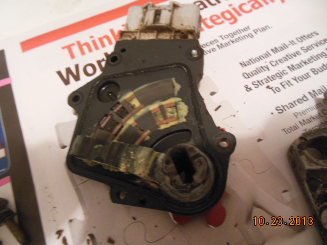

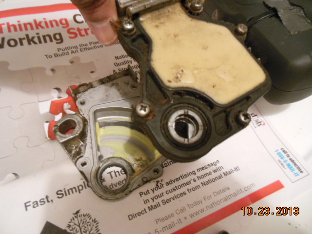

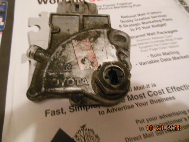

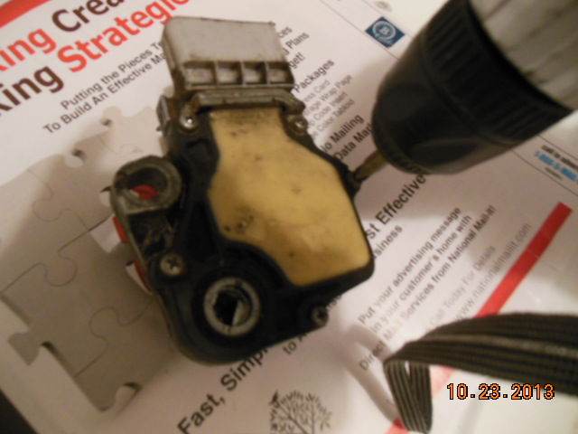

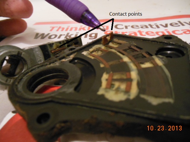

If it starts in all gears, then probably something wrong inside the Park-Neutral safety switch. If you know how to play with car stuff, you can open the switch and clean all the contact points. I have few pictures of inside it is. This is 97 4runner switch.
thank you ! I found your post in different topic and pulling my safety sw right now.
....it still won't resolve your stalling issue. P/N switch has no effect on the engine once it's running.
I kinda understand that it has nothing to do with stalling and its only like safety feature, but car still starts in all the gears and I think that is particularly because engine starts in ON position via push start button that bypasses starter relay ( starter relay is out and been like that for 2 years after somebody gave me a jump start and burned something and car doesn't react on key in start position). So I pulled out the safety SW cleaned it up and putted back in...still same old at least I can call the guys and cancel appointment on which they wanted to install me new safety sw.
