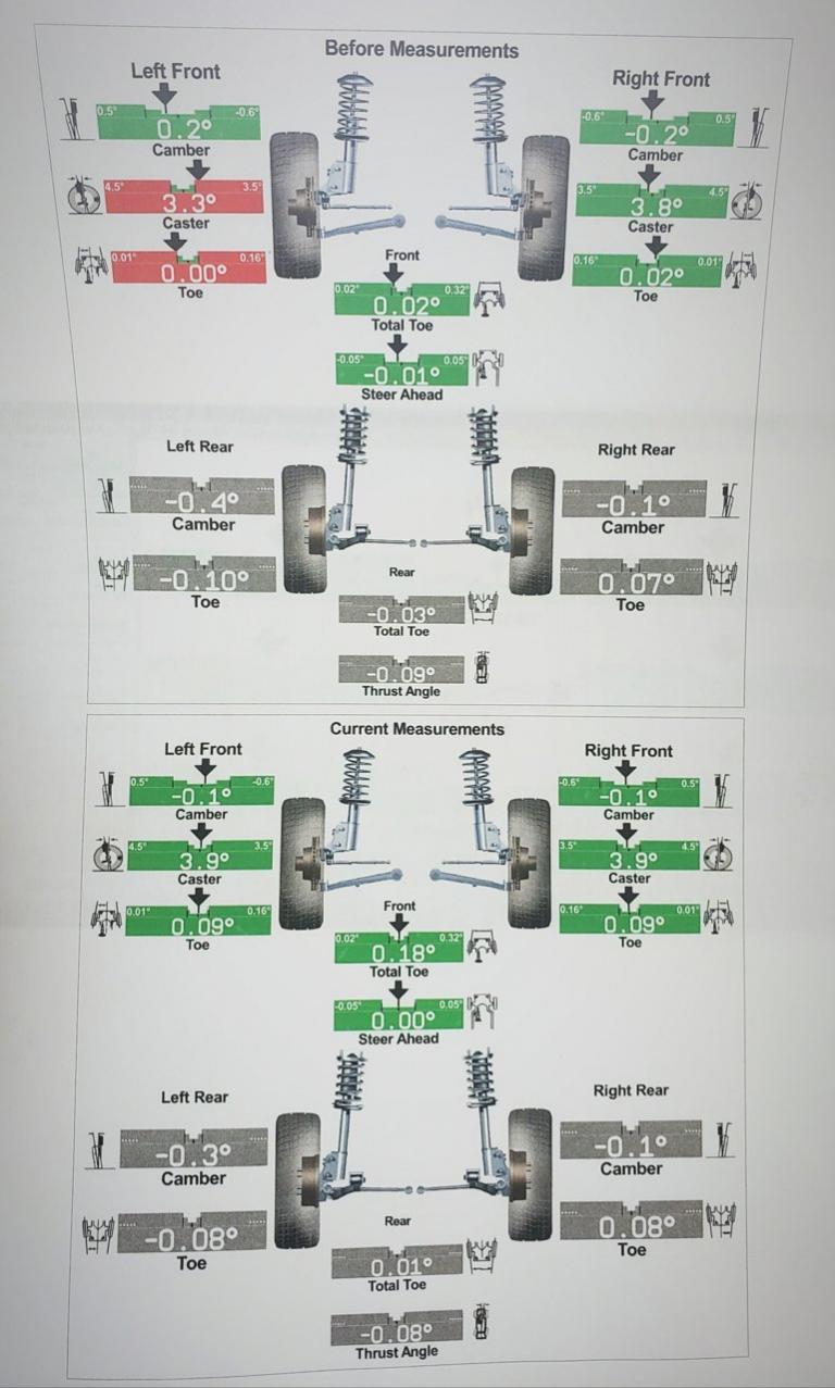

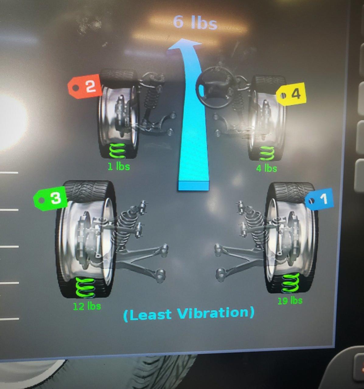

So just when I thought my front end problems were finally solved, it resurfaced.
My ordeal is far too long to bore anyone here with so I will briefly explain my problems.
Since day one, stock tires: wobble at 60mph, high frequency vibration at steering wheel, wandering/swaying.
What have I tried? Multiple alignments, multiple balances, 3 different set of tires. Multiple PSI adjustments. All done at different shops, not just one.
Current status:
- Still have swaying/wandering. Needs constant correction on highway.
- At first, after my latest road force the wobble had gone away. However I lowered my PSI from 36 to 34 cold, to get a softer ride and the wobble returned. It gets pretty bad at 60mph until the tires warm up. This shouldn't happen from lowering my PSI a bit.
- Have a slight pull to the right. When I let go of the steering wheel it'll slowly start pulling to the right. Nothing too horrible but its there. I have to drive with the steering wheel pulled to the left slightly to track straight. I've tested this on many different roads/highways.
- high frequency vibration still there, like holding an electric toothbrush
Attached is my latest spec sheet for alignment and balance.
Current tires: Nitto Terra Grappler G2 P-metric, stock size on stock rims.
No other mods what so ever.
At this point, should I just say F it and deal with it?
My concern is if I don't get the pull corrected, my tires will have uneven wear eventually.
I appreciate any feedback guys.

Thanks for the reply, I appreciate it.
Truck has 1,900 miles.
I have not tried the bushings or disconnecting sway bar. Unfortunately my car knowledge ends at changing oil/filter and tires lol.
The problem with the high frequency vibration is that it'll put my hands to sleep as I have nerve damage to both hands. If it wasnt for that, I dont think I would care too much about it.

Okay let's try looking at it from a different angle since nothing is working.
Do you keep going to the shame shop to do all the balances and alignments?
That's really the only thing that makes sense. Diven alot of vehicle with purposefully out of spec (custom) alignments and I have balanced a lot of wheels. If the tech doesn't have a clue you will notice it on the road. Sometimes people have "a guy" or "a friend" that they always go to and that person has no idea what they are doing. Food for thought.
Or you are being hyper sensitive. I noticed this truck is not the straightest of trackers. I the get steering wheel vibrations depending on road harmonics (not so much in line with speed but always 60mph or above). Given the stuff I have read I would say current toyota trucks have sensitive front ends (poor IFS geometry?).

I would put money on you being sensitive about it. I don't like that the truck does these things but I think with alot of our trucks it is what it is.
You could get with an alignment expert and see about adding or subtracting toe in/out or caster in the front to get it tracking a bit straighter. Donno if you have adjustable UCA's or not. You need to get on you local fb groups and find a shop that does custom alignments. Someone who sets up racetrucks/cars. Get a real pro on the job to give an opinion. If you were in az I have a guy who did my drift cars that will be doing my truck when I lift.
Before you spend anymore money however I would try to drive a few other 4runners and see if you notice the same thing. You could be chasing your own tail on this one. It pissed me off too but I just let it go.
i would try a different shop and check the alignment to see if the readings match what you shared above as those specs look good to go. if your alignment specs are still good, one of your tires may be exhibiting radial pull. i would also raise your tire pressure as this does help with my wobble and vibrations.
I'm on my 3rd set of tires and have put 172,000 miles on my truck and have zero vibration, here is what i have to say.
It's all in the balance. Needs to be a road force balance and done correctly. Not all tires can be balanced as easily as others. Indexing changes every time you rotate tires or do maintenance and remove wheels.
When I replaced my original dunflops at 60k+ miles, i went with michelin LTX. vibration at 60mph and steering wheel vibration. They were from a local, respectable, tire shop. Took it back, and was told that was the nature of the truck. Took it Toyota and paid for a road force balance and wheel balance from scratch. vibration gone and those LTX's lasted me about 70k.
Replaced those with KO2, bought from the toyota dealer (buy 3 get 1) and demanded that they be road force balanced at installation. No vibrations, they are great, and now I'm at 172k.
I test drove a runner while I was pissing around at the dealership once, and it vibrated. the sales guy told me it was normal for the truck. I laughed at him and told in exact words, "you're full of shit".
Make sure your a dealer, or wherever you go, has the right equipment and the right skills. You should have a vibration free truck. I've seen both, you are not being over sensitive.
Also, tires have a lot to do with tracking. My KO2's, at 34PSI, track true with no wandering. At least until I had a leaky shock.

have you tried road force balancing or using soft beads inside the tires? I wonder if the techs are just not balancing the correctly all things being equal on the suspension.
1. Roads are crowned, so pulling to the right is normal.
2. Terra Grapplers suck, I experienced the same thing you experienced for 47,000 miles. I just swapped to 285 KO2's and there is no vibration or noise anymore. I also switched to hub centric SCS wheels.
It shouldn't be a problem like it is, but it seems like the stock wheels and tires suck.

He said re road forced balanced them but vibration came back after he dropped a few psi. Could have been a "close enough" balance that caused that idk really.
When they did my michelins, they said they had a tough time with one of the tires, but they got it finally. It took a good amount of weights. You might be right with the close enough. The vibration is definately annoying, even for the short time I had it I was pissed. But it was fixed with a good road force on new equipment.
