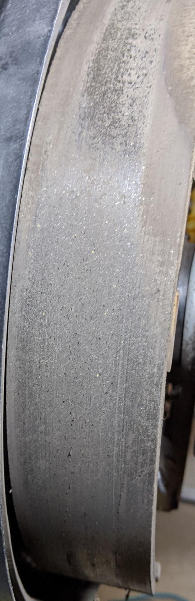

So based on what you said, I pulled on the handbrake at about 5-10mph or when about to crawl to a stop several times and I did feel the problem on the handbrake handle and it even felt that the handle was going up and down a little bit. Then I finally had the time to remove the rear drums. It looks like the new OEM shoes have a bump in the middle (or convex) top to bottom lengthwise so its only making contact with the drum surface in the middle.
You can see this clearly on the pictures. It looks like the middle of the front shoes are starting to mate with the drum but the top and bottom looks like its got a long way to go.
So I think the rear brakes need to go through a rigorous bedding procedure.
The question is, do I need to remove the brand new OEM shoes and sand them down with a foam block with 100-150 grit sand paper or bed them as is after cleaning with brake cleaner?
Or I think I might be able to sand them w/o a foam block in place.
Thanks!

Also from the black residue/brake dust. I don't think we cleaned the drums well enough and there was still some oil left on the drums.
If there was any oil on them I would pull the rear wheel speed sensors and spin the axle around to see if there is any oil on the abs tone ring or if you can see any in the axle tube cavity. Any oil in there is an indication the you have a failed rear axle seal.
If you do that on both sides and don't find any oil then I would have your rear drums turned again. Even with only part of the rear shoes contacting the drum that shouldn't cause a vibration/catch and slip feeling unless the drums have oil residue spots or are still out of round.

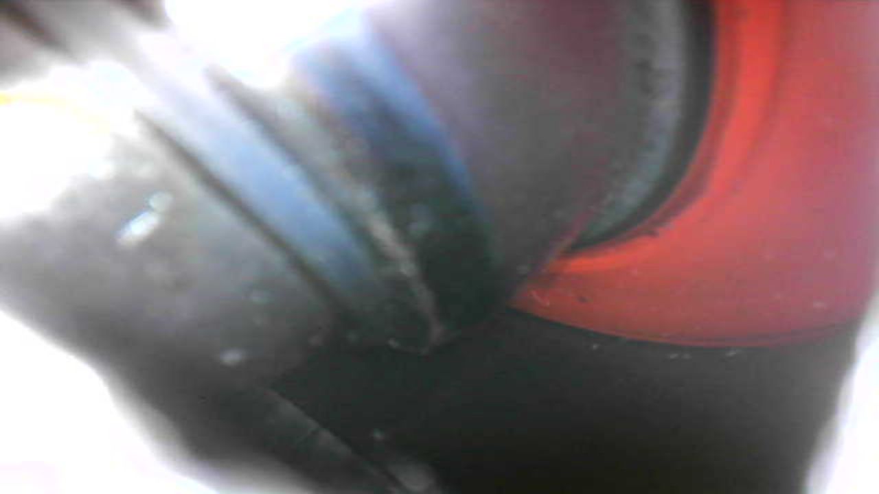

Rear seals and bearings are new, I also use a borescope to check thru the ABS port so I don't have to pull the wheels off! Great tool!

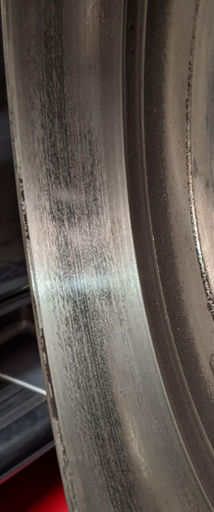

Update: brought back my drums and they turned one again, the other was going to be below spec so they couldn't turn it. I'm almost 100% they messed up the job as the drums only had 130k miles on them. Plus obviously if they thought one drum needed turning again because it was out of round then they didn't do it the first time. Had to argue my point to get my money back! Now I'm looking at new aftermarket drums. Any suggestions?
