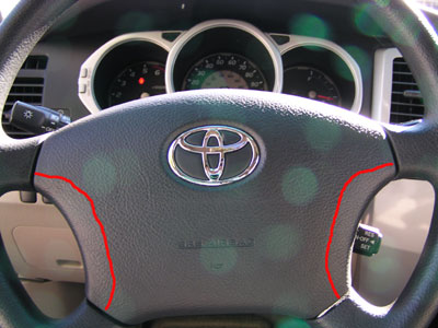

OK...So i just bought the audio controls for the non-SR5 wheel to take control of my audio from my '06 SR5 V8....From the OP's original pic, it seems that the harness is already there, and I was told that all 4Runners (of this age) have the harness, regardless of the 3K$ upgrade or not. So, from the pic, it looks like I have to take the airbag off to get to the two plugs??? The ebay member told me that it was pretty much 'plug-n-play. And if this worked, is the harness connected to the NON-JBL, double din stereo??? (I am going aftermarket stereo anyways, but the controls will be there, and eventually adapted to work). THANK YOU AND THANKS FOR THE HELP....my 1st post!
You can add the any of the steering wheel controls without a new steering wheel. But, if you have an SR5 without the audio controls on the left, you need a new airbag.
So, you are saying you need a new airbag to make it 'fit' like the OEM upgrade? If not, I would assume you could add these controls (like I am) into the steering wheel, with my own modifications using the existing wheel/airbag.
Am I correct in this assumption? Thanks for any reply!
Yes, it's plug and play, and YES you have to take the airbag off. It's very simple to do.
look here on how to take wheel off:
http://www.toyota-4runner.org/4th-g...-steering-wheel-button-install-pics-real.html
Does your rig have JBL?? If so, everything is plug and play (almost everything)
Did your SR5 come from the factory without ANY audio controls?? If so, then you have a couple of options.
1) Cut the bag cover
link to how another member did this:
http://www.toyota-4runner.org/4th-gen-t4rs/176230-$30-steering-wheel-controls.html#post1779202
2) Get another airbag cover.
hope this helps.
