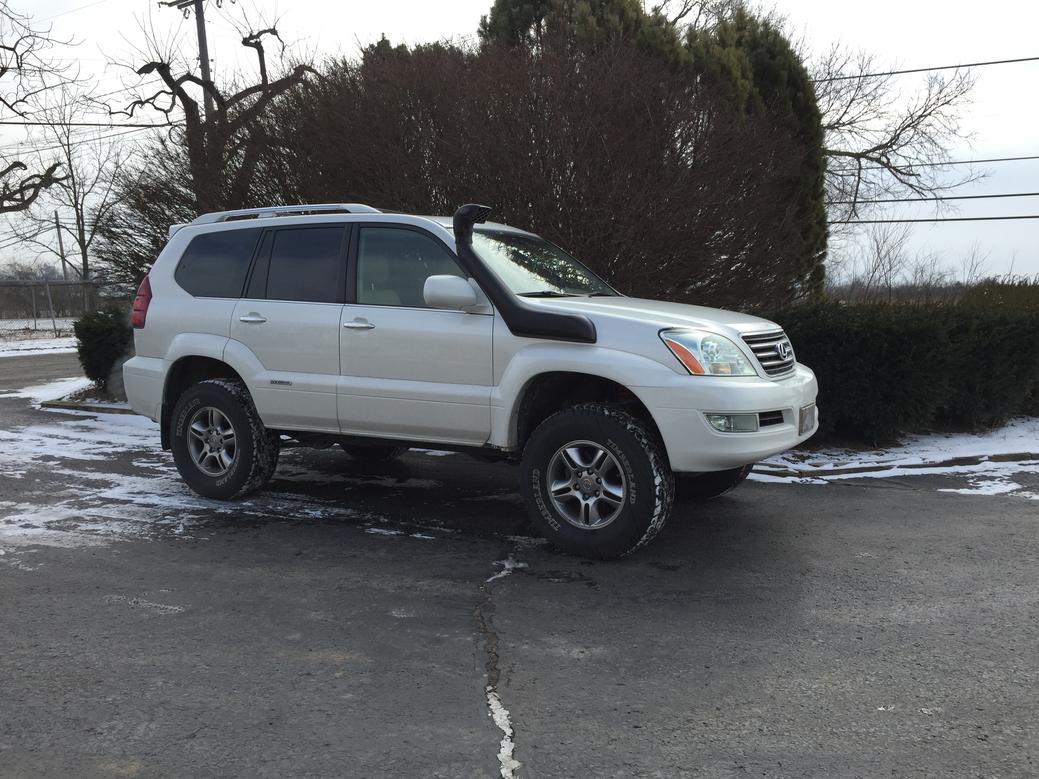

Sliders are not ready yet, but with the extra large plastics on the running boards I was rubbing hard with the 285s. So (even though it was not planned) we ditched the Running boards today and instantly solved all of our rubbing issues.

Umm. You put a snorkle on your GX?
Uhh....Yea, all the cool kids do...
Why not stick one on the GX, I already had it sitting here and I even have one for the 1st gen Sequoia and the 05 Tacoma.
We have snorkels on 3 of our 5 trucks and only ever needed it on once. But that's not to say we won't ever need it on the others.
