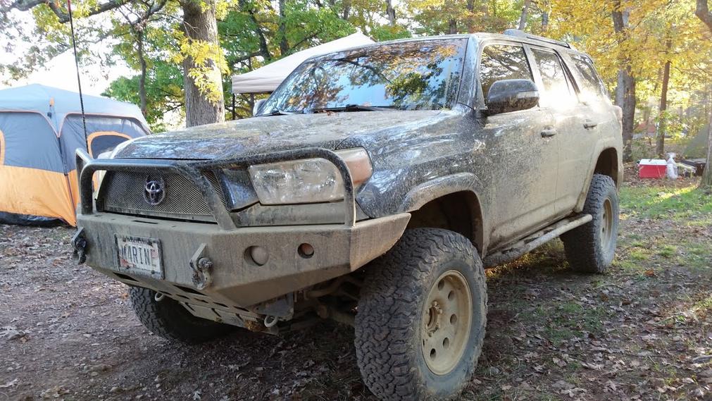

Pinstriping.... it happens.

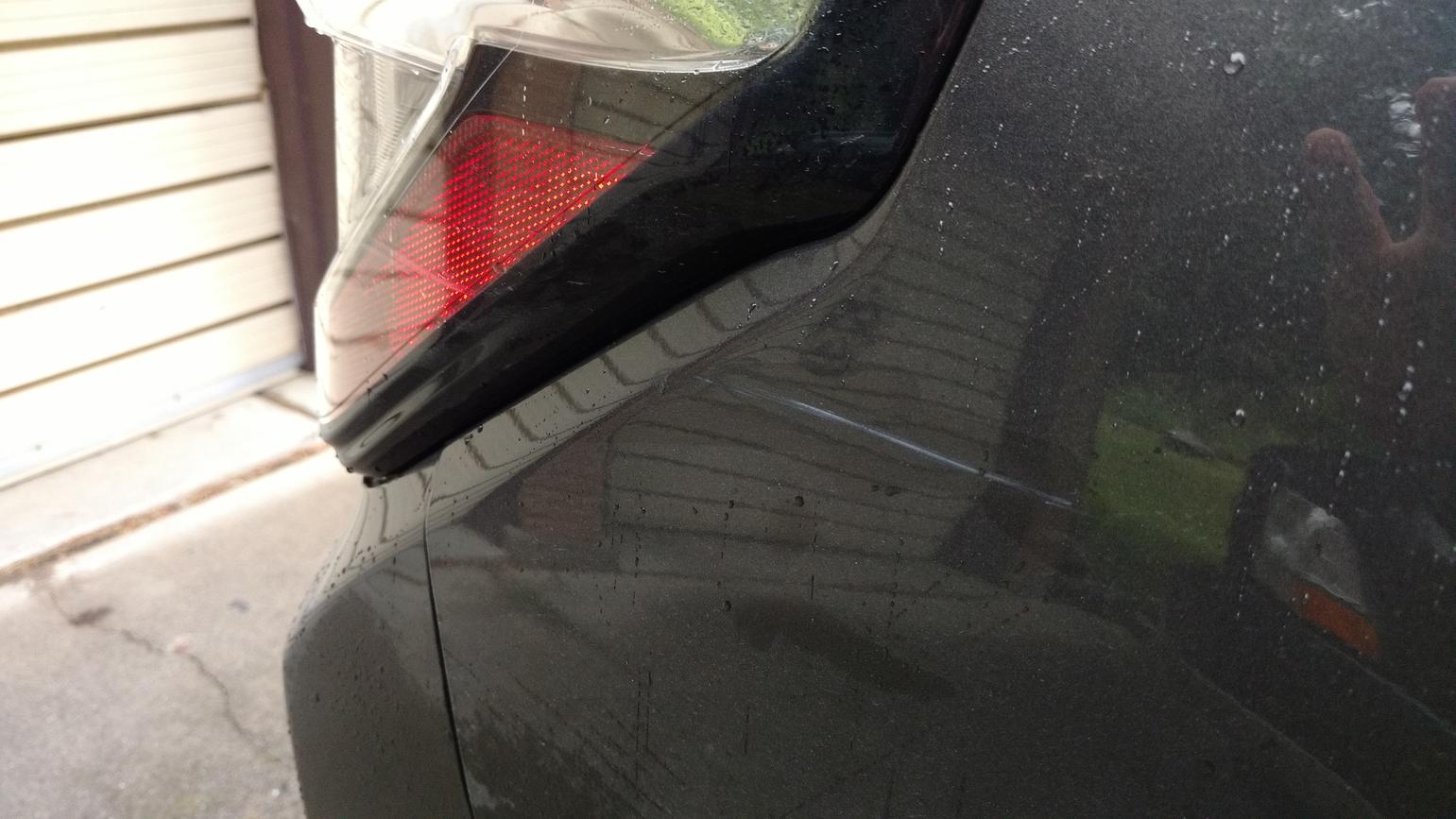

Resurrecting this thread since I can't post new yet.
*1.5 Week old SR5 Premium in Mag Gray
* 700 miles
* Careful where I park
Today while sitting in a SB watching over my 4R parked on street (legally) a drunk fool on a bike comes riding down the sidewalk and decides to fall over right where my New Flame was parked. There was no one parked in front or behind.....this is just my luck. I attempted to stop him and beat his drunk @ss, but I was not fast enough to confirm that damage before yelling at the old fool to stop.
I can feel the ridge with my nail.....so I am guessing that it is through the CC?
