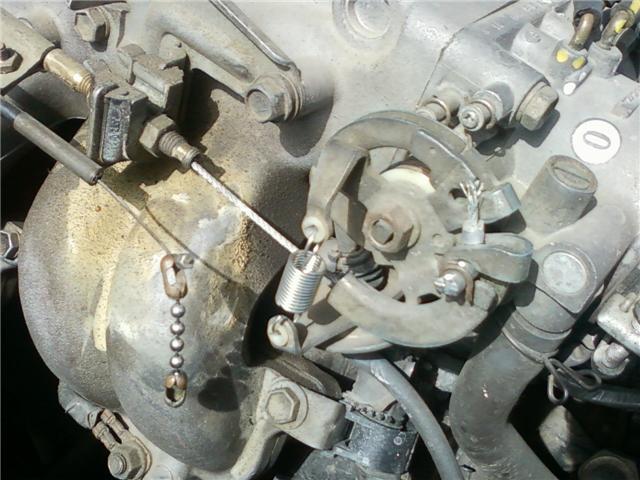

Also, if anyone would be willing, i need a picture of the little throttle thing on the 22re engine. (The part that the gas pedle is cabled to) because mine is missing parts and i want to see what it SHOULD look like. ill post a pic of mine soon
I had a pic of the linkage posted online but pulled it just last week cause I needed the room.

here is a picture of my accelerator, as you can see its missing parts.. haha. should i get find a new one? Or could someone tell me what its actually called?

Did you see my accelerator? the second wire is not connected to anything, and you can see the crimped and frayed first cable. the silver spring i just put in, its stiffer than the other spring that was in it, it has made the time it takes to go back to idle go down a little, but not enough to make a difference while shifting.
