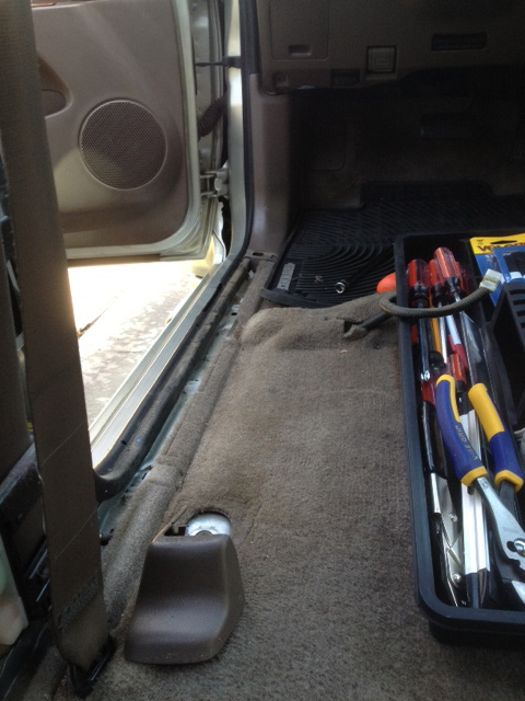

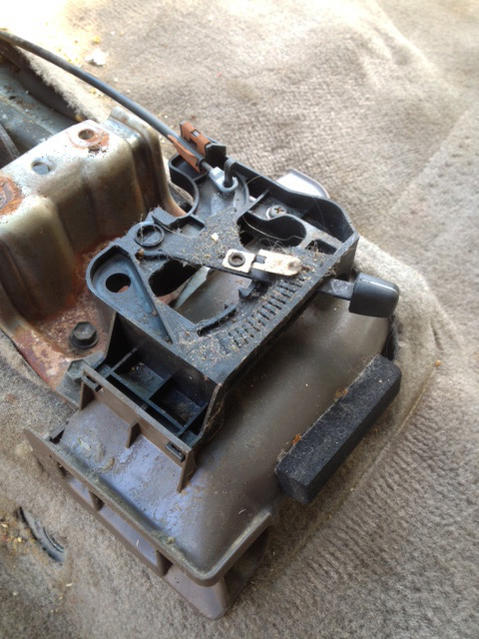

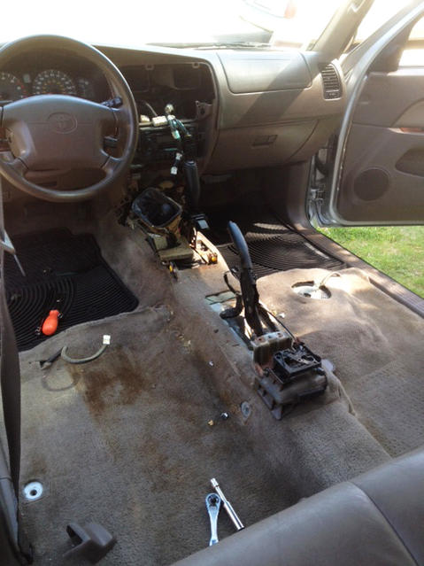

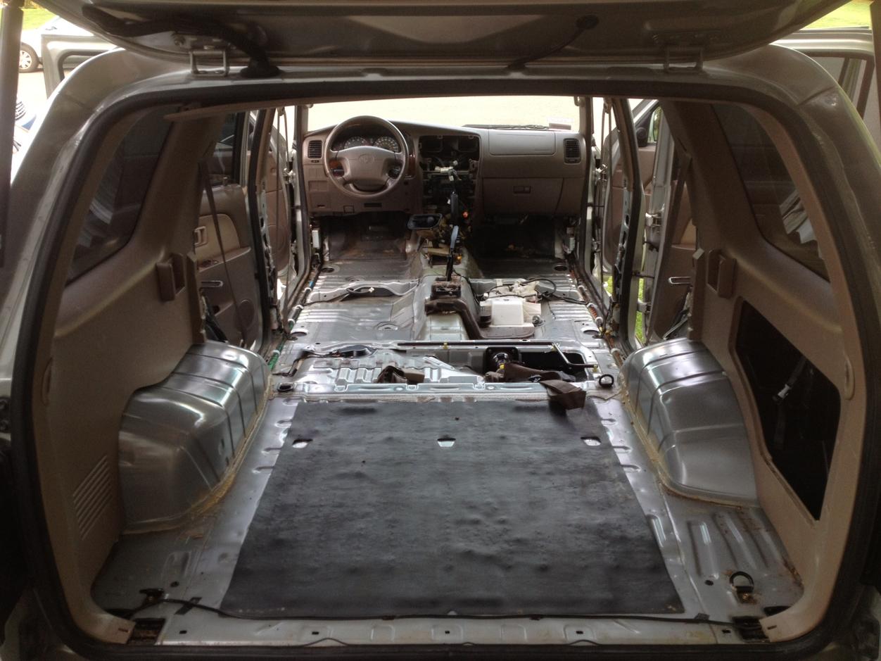

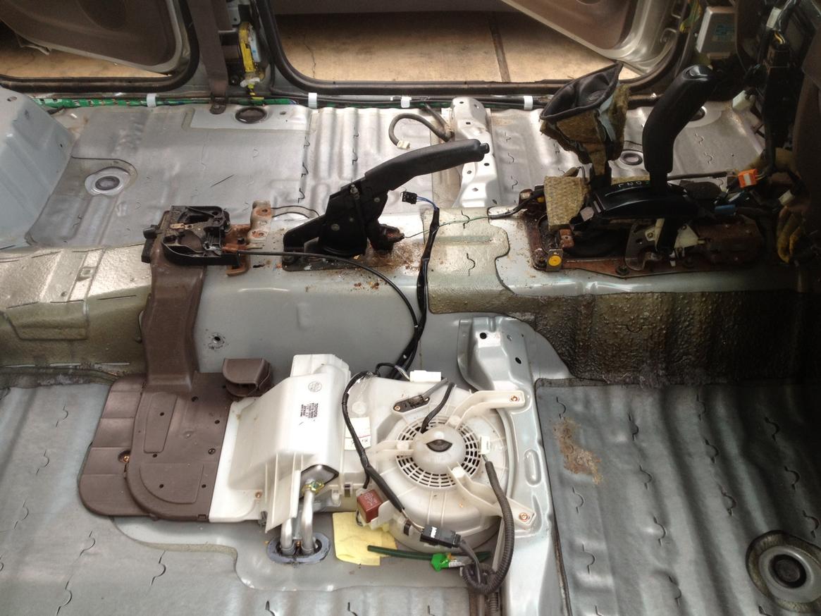

I removed both leather seat rows, the center console, arm rest, and all lower interior plastic trim pieces, including the side panels and floor trim. With the previous owner having kids and animals in the car, the plastic trim, seats and carpet are soiled with coke, coffee candy, hair, animal piss and normal build up of dirt and debris. Everything will be cleaned thoroughly this week.

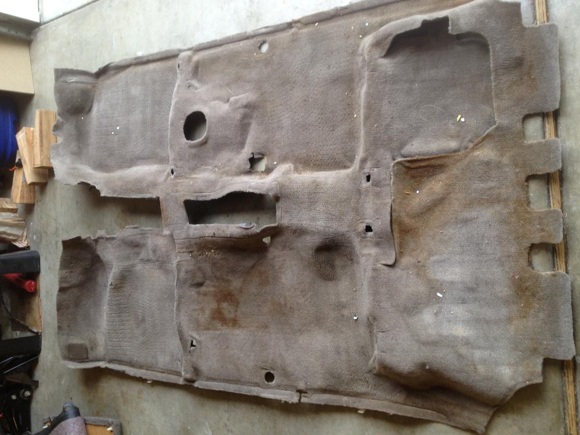

I'll be removing the front and rear carpet tomorrow to have it steam cleaned this week. It's important NOT to steam clean the carpet while in the car in order to prevent moisture from rusting out the floor pan and to allow propper air drying of the carpet and its padding underneath. I've decided cleaning will be better than ordering the new aftermarket molded carpet as the OEM carpet has all the holes and it's the right size. I dread having to spend hours cutting every little hole and the outter edges of a new one just to fit it in.

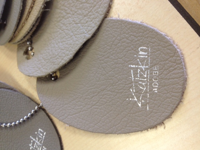

While the interior is apart, I'll be sending the ripped and cracked leather seats to a local professional installer for a Katzkin recover. I'm still debating if I will go with single tone in the factory OEM style and color or 2 tone with same 2 colors as the OEM door paneling, which is a dark and light beige. I've done a Photoshop concept of the 2 tone here and would appreciate your vote. I'll likely add the seat heaters as well. I will definitely be taking detailed photos for all you 3rd genners out there so stay tuned.

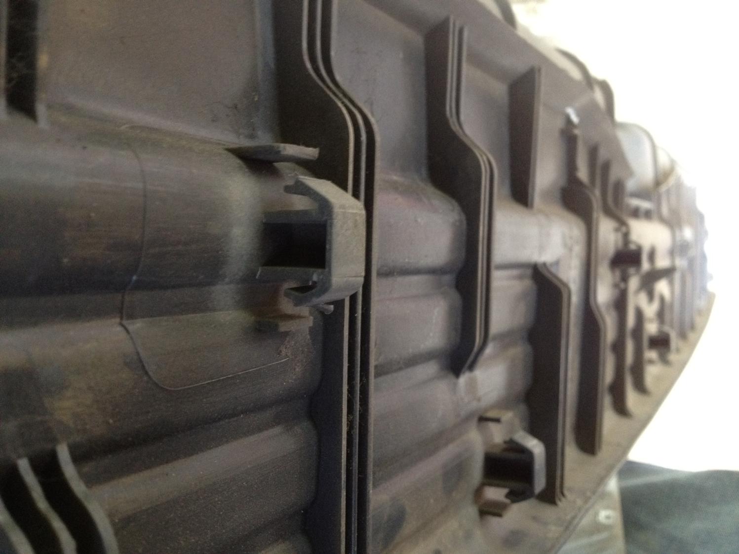

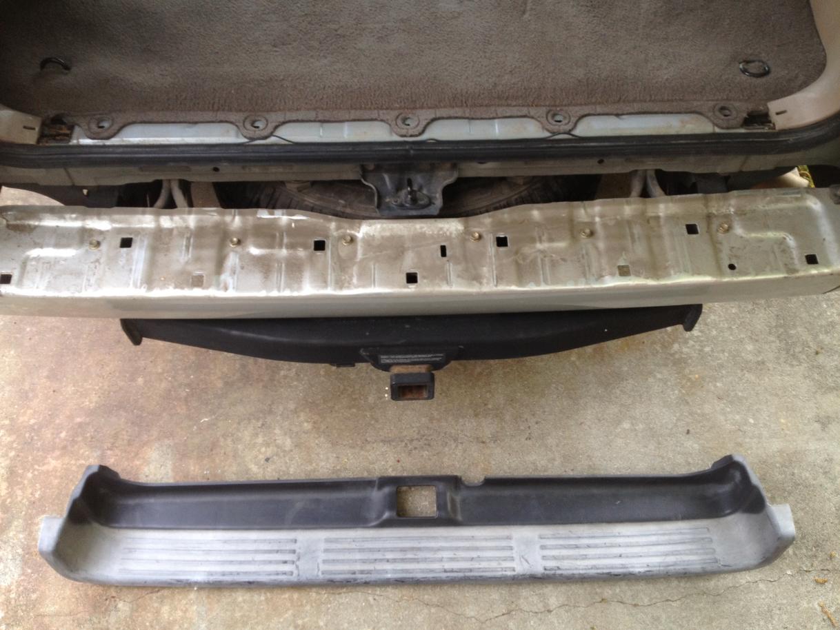

Lastly for today, I pulled off the rear bumper stay, the black plastic step piece, which was sun bleached and faded as hell. I was able to pinch in about 5 or 6 of its clips just lying down on my back under the bumper, which greatly helped in pulling it off by pulling up on it from above. There are about 10 or 12 clips in all, most of which are not accessible from underneath if you have the lower bumper and tow hitch attached. I ordered a new bumper stay along with some other interior parts, like factory front and rear cup holders and trim clips, at Toyotapartseast.com.

I called up a local Katzkin installer this morning, Coach Auto Restyling, and scheduled an appointment for Thursday morning. Really nice guy.
I voiced concern about the looseness and angled incorrect pleats I see on some of the Toyota trucks with Katzkin. It turns out it's the result of compressed, aged seat foam. The leather kits are cut to OEM spec, so when the new leather goes on to worn out, squished, shrunk foam, it looks loose and pleats appear where you don't want them. Some installers add new foam on top of the aging foam to tighten up the look, but it's not perfect, and some are just lazy and simply recover the old flat seats, leaving the leather looking baggy and loose.
In the spirit of doing it right without any regret, I ordered brand new factory seat foam for both front seats from a local Toyota dealer so the Katzkins will fit tightly.

I have the carpet out and COIT is coming on Wednesday morning to steam clean the whole set. Can't wait. I'll take some good before and after shots of the carpet and seats for you guys so stay tuned.

Hey guys, here are some shots of my progress from a couple of days ago. Has anyone used the aftermarket molded carpet with mass backing in their 3rd gen? I'm curious how it looks and fits and how much time it takes to cut the holes and trim the sides, just in case my carpet cleaning doesn't come out great tomorrow.

Well, the old mule is in the shop getting her new Katzkin leathers.
I decided against the two-tone as I thought it might look too sporty, busy and just a tad too much style for a truck. I opted for the single tone Katzkin in the flat Adobe color. I held the swatch up to the door panel, OEM seat leather and seat side plastic and determined this color looked the best as it very closely matches the OEM but with a slightly brighter tone, less taupe and more beige than the OEM. IMHO, the OEM color of the oak interior has too much red in the taupe color. I prefer more of a biege/tan hue. To me it just hints more at the earthy colors of the outdoors.
I specifically asked for the new seats NOT to have the cheesy, luxury sedan-like OEM pleats in the center section but instead, a tight and flat look throughout. The finish will also be flat, as in not shiny or glossy. I think these two characteristics will add a subtle touch of "truck" and masculinity.

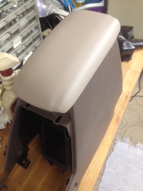

The center console lid will also be wrapped in the same leather as the seats without any stitching. The OEM stitching and seams are prone to show wear from excess contact on the edges. The new look will be more practical, smooth and create continuity of color across the front row.

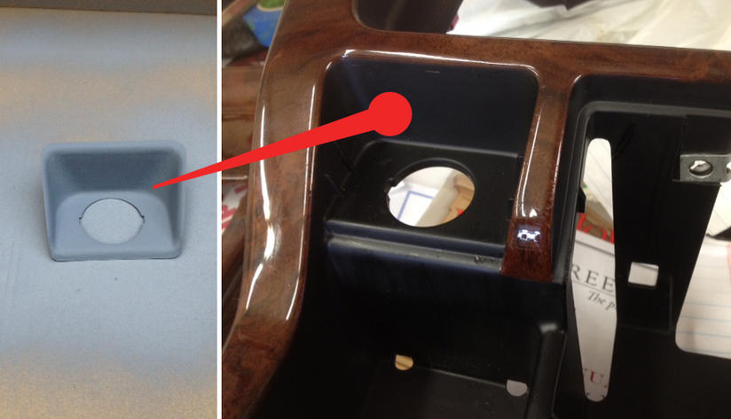

Ash tray mod, cigarette lighter panel and cup holder restoration
While waiting for the return of the 4Runner, I thought I'd tinker around with a few dash and panel pieces.

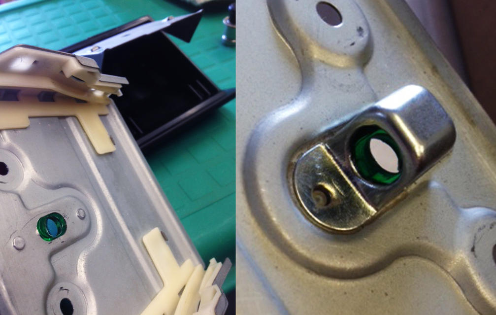

Ash Tray Mod: With the OEM ash tray's dim green light, I wanted to brighten it up with warm white light and a hint of green so I could see its contents better but preserve a somewhat factory look. I simply drilled a hole in the green plastic filter to let in more light.
Cigarette Lighter Restore: I noticed the paint coating on the metal frame around the lighter was coroded and spotted in white so I took it apart and gave the metal a quick sand, prime and paint in flat black. It came out great.

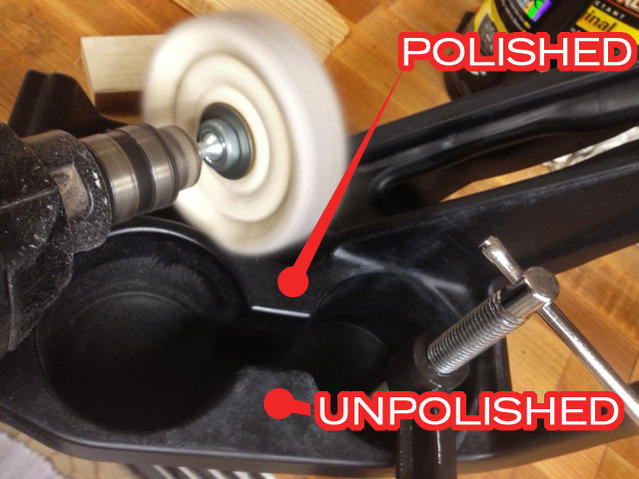

Cup Holder Restore: This is tough stuff to restore indeed but a dry polish wheel and moderate pressure with quick movements, ensuring not to build up too much heat in one area and thus melt the plastic, removes light surface scratches and some of the whitish dry, UV damaged surface molecules. Here's how it looks. I also finished the piece off with MeGuiars Trim Restore to get it looking even more black. It came out great.

I got my truck back yesterday evening with the new Katzkin leather and it looks and feels INCREDIBLE! It's a tad bit thicker and softer than the factory skins. They added a thicker padding layer between the leather and seat foam which makes it feel more soft and comfortable. I will say the leather looks a tiny bit loose in a few areas compared to the factory but negligibly so. I have 3 months to bring it back to have it tightended if needed. I'll give it some seat time and see how it holds up over the next few weeks before making that call. If it stays as is, I'm happy. Photos coming soon but as a teaser, I've attached a shot of the center console lid covered in the same skins as the new seats. It looks great!
The installers stuck with the original passenger seat foam bottom because it had an embedded airbag sensor which would've been too risky or time consuming to mess with. I'll be returning the brand new passenger seat foam bottom today.
