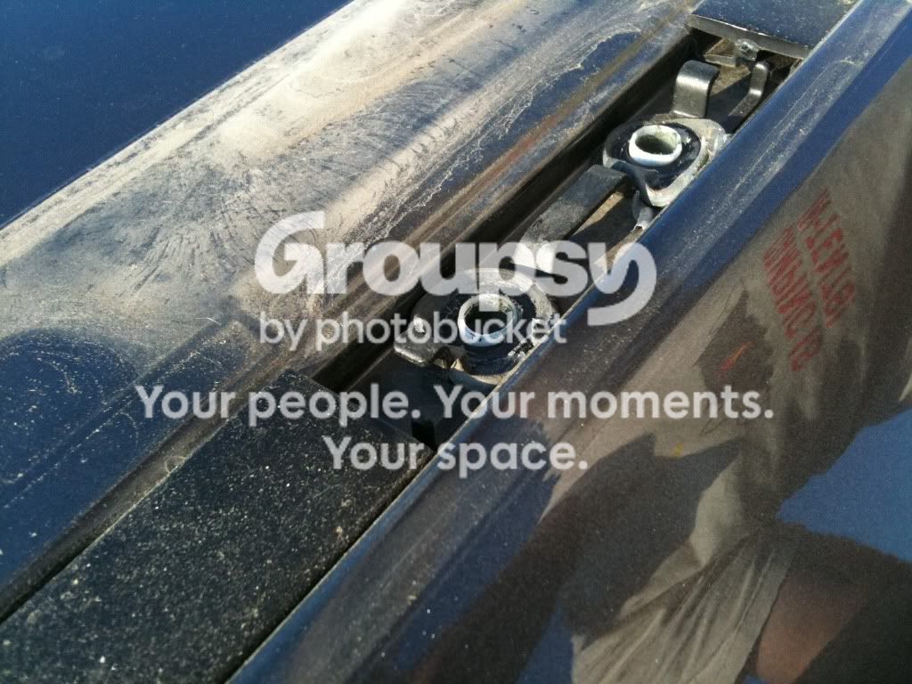

^^ There are basically two tubes that poke out of the top of the roof at each mounting location. There is a small gap between those tubes and the metal of the roof. You just use some silicone around those tubes to prevent water from leaking down into the truck. The stock roof racks had some type of sealant in there as well.

When I was having my rack built, I talked to the local Toyota parts department about buying some of the sealant Toyota uses. They don't sell it. The parts guys had a spool of what they called "Dum Dum", which is basically a moldable black rubberish substance that comes wrapped in waxed paper a looks like licorice rope. It's exactly like the stuff that we pulled off the bottom of the rails where they attached to the roof, under the little black brackets that fit over the white tubes. Your parts department might be able to hook you up, but I ended up not using it.
I used some clear silicone that I had left over from sealing the kitchen counter backspash to seal around the outside of those tubes, and we lubed the bolt threads with some blue gunk to keep the water out. No leaks.

Here's what the roof looks like without the rack. There was a ton of dirt in there, even though I only have 5k miles.
b74b9fb1.jpg~original
Note. I think those little pieces of metal go with the factory rack. I took them out. And then silicone cauked the he'll out of the channel.
They are stock with every 2010 4Runner. They hold the little plastic covers on for Runners with no rack.
