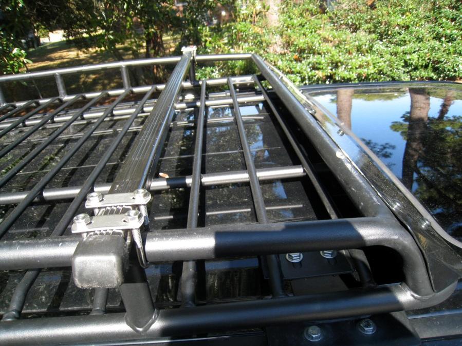

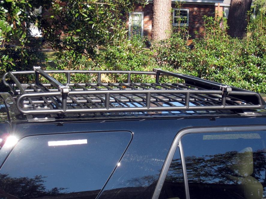

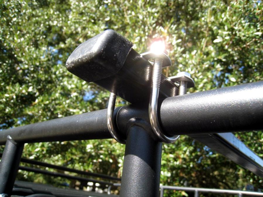

Thule Crossbars (cheaply) mounted on Baja Rack

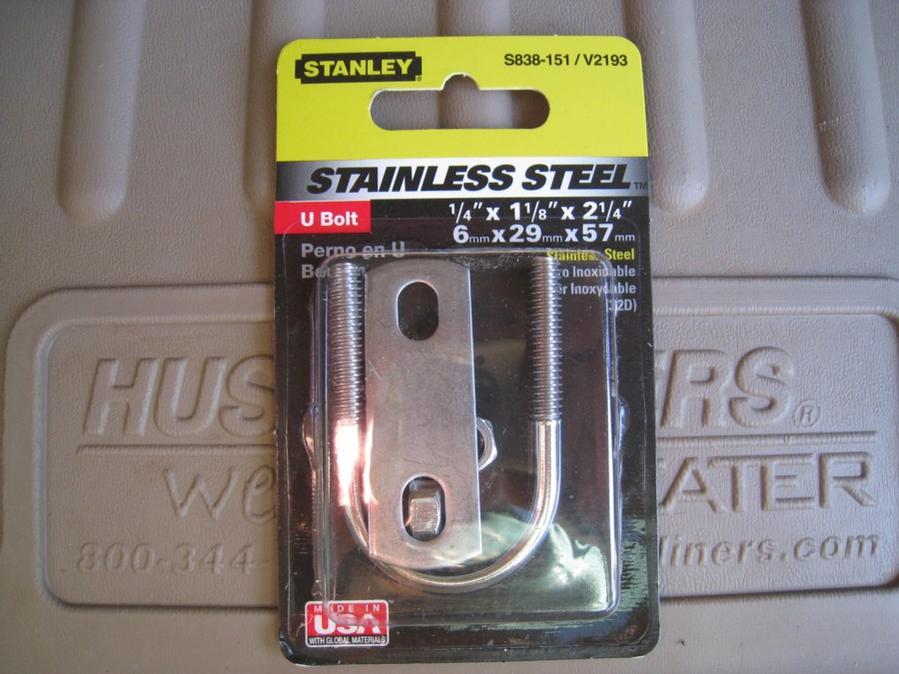

Bought some SS U bolts at Lowes today and used them to mount Thule crossbars on the Baja Rack. Keeps the cross bars lower than Thule mounts, but looks kind of ghetto! Point is that now I don't have to worry about thinigs scrapping of the paint on my Baja Rack, which SHOULD BE MADE OF ALUMINUM and is not. Or at least it should have the vynyl wrap on it like hte Thule bars. Mine already was starting to rust. Also, now I can use Thule attachments. Easy to remove too.
This is probably temporary, but thought people might want to see how it looks...
Ubolts I bought from Lowes $2.54 each for total of $20.32 before tax for 8 of them.
sure looks higher than my Thules on the factory rails... what's the height, exactly?
the BajaRack is really rusting already? ouch.
What I meant is that it is lower than mounting the Thule racks using the universal Thule mount ATTACHED TO the Baja Rack, not the height from the Thule on the 4runner stock roof rails. The way I have it pictured here, it is about 7.5 above the truck's roof. With Baja Rack only, it is 6.5", and then add the height of the Thule bar itself, which is about an inch.
The rust is happening in places where the powdercoat got scrapped off. I put all kinds of things on my roof rack, such as an aluminum canoe, which scrapped off the paint where the gunwales were on the rack. You can see a scrapped off place on the front bar in one of those pics above that I just posted. I am bummed that Baja Rack did not make their product out of a more rust proof material, or that they didn't wrap with vinyl like Thule does on their bars. For $700, you would expect better quality materials...although I don't think any of the aftermarket roof rack companies (GOBI, etc.) are using aluminum...so I guess it is relative...

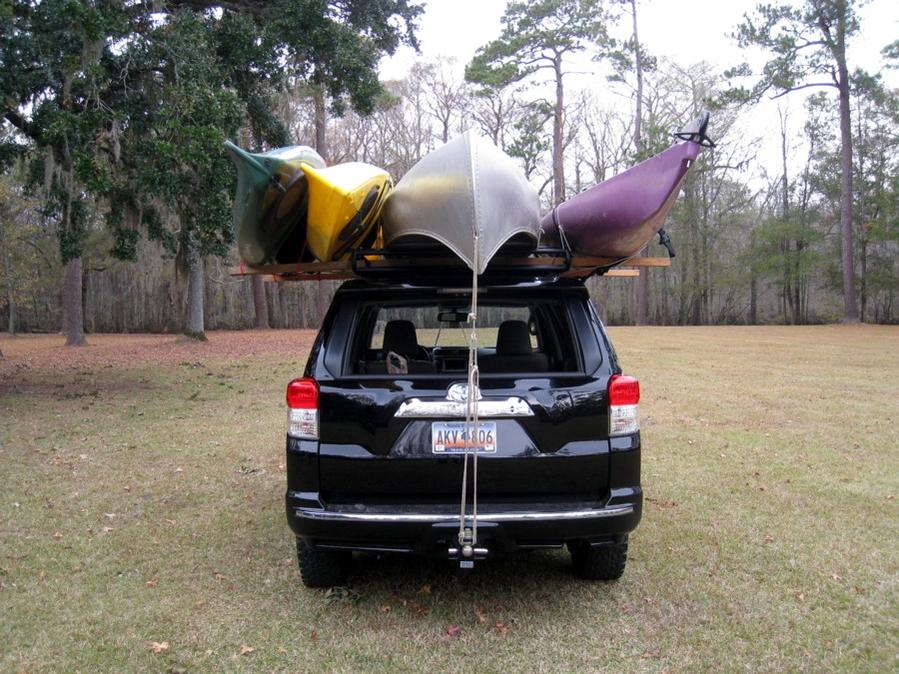

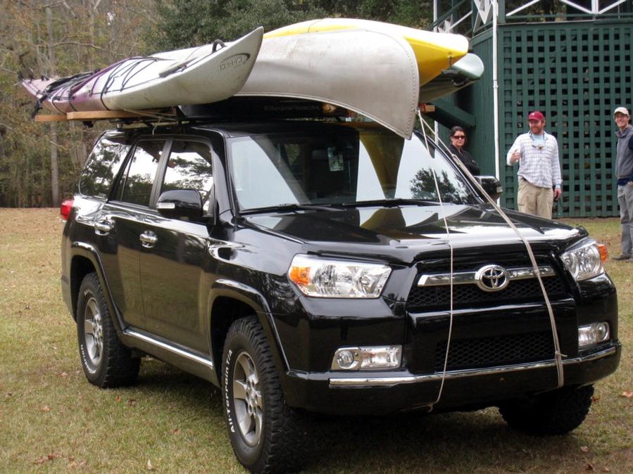

4 boats on Baja Rack
Last weekend on a float trip we needed to add more boats than just my canoe on top. So, I found two 2x4x8 beams, slid them between the vertical bars on the Baja Rack, and BAM we had 96" crossbars without even having to take the canoe off to get them on there! Baja Rack made this so easy to do!

For those of you who've kept track, did you take an efficiency hit after installing the rack and if so, how much?
Thanks in advance. All of your racks look amazing (no pun intended) =D
Your CITY mpg will not take a hit in general, but HIGHWAY mpg probably will. I can get about 17 city, and 20 highway at 55 to 60mph on flat roads. When it gets hilly, and I increase speed to 65 or 75, it takes a big hit...probably down to 18hwy, or even 17. Bear in mind that I installed my Baja Rack the same week that I got slightly larger and heavier tires with AT tread. This is discussed somewhere in the MPG threads...and a few guys with bigger tires and after-market racks discuss their results.
