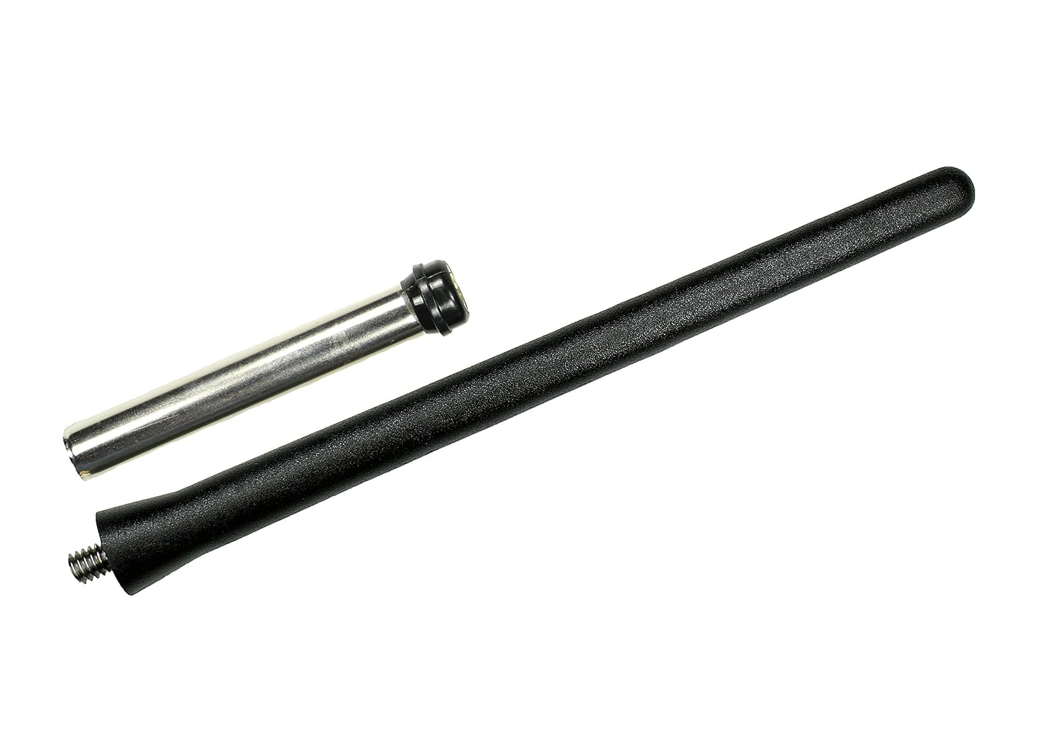

The better plan may be to source the motor from a junkyard or from a source like above. Or do the whip mod. I know that personally I liked fixing mine because for whatever reason, I have a nostalgia to the motorized antenna. But my current head unit powers up the antenna anytime it is on. I did have a switch hooked up to my old one, so I could toggle it up and down as I wanted. However, this time around I just didn't hook up the power to it. If you have both the front and rear antenna hooked up, it doesn't seem to make much difference if the antenna is up or down.

I'm going to try a new product called "AntennaMastsRus - Conversion Kit is Compatible with Toyota 4 Runner". Has anyone tried this and what was your result? I'm guessing the motor still hums for a bit then quits. Is that what happens?
