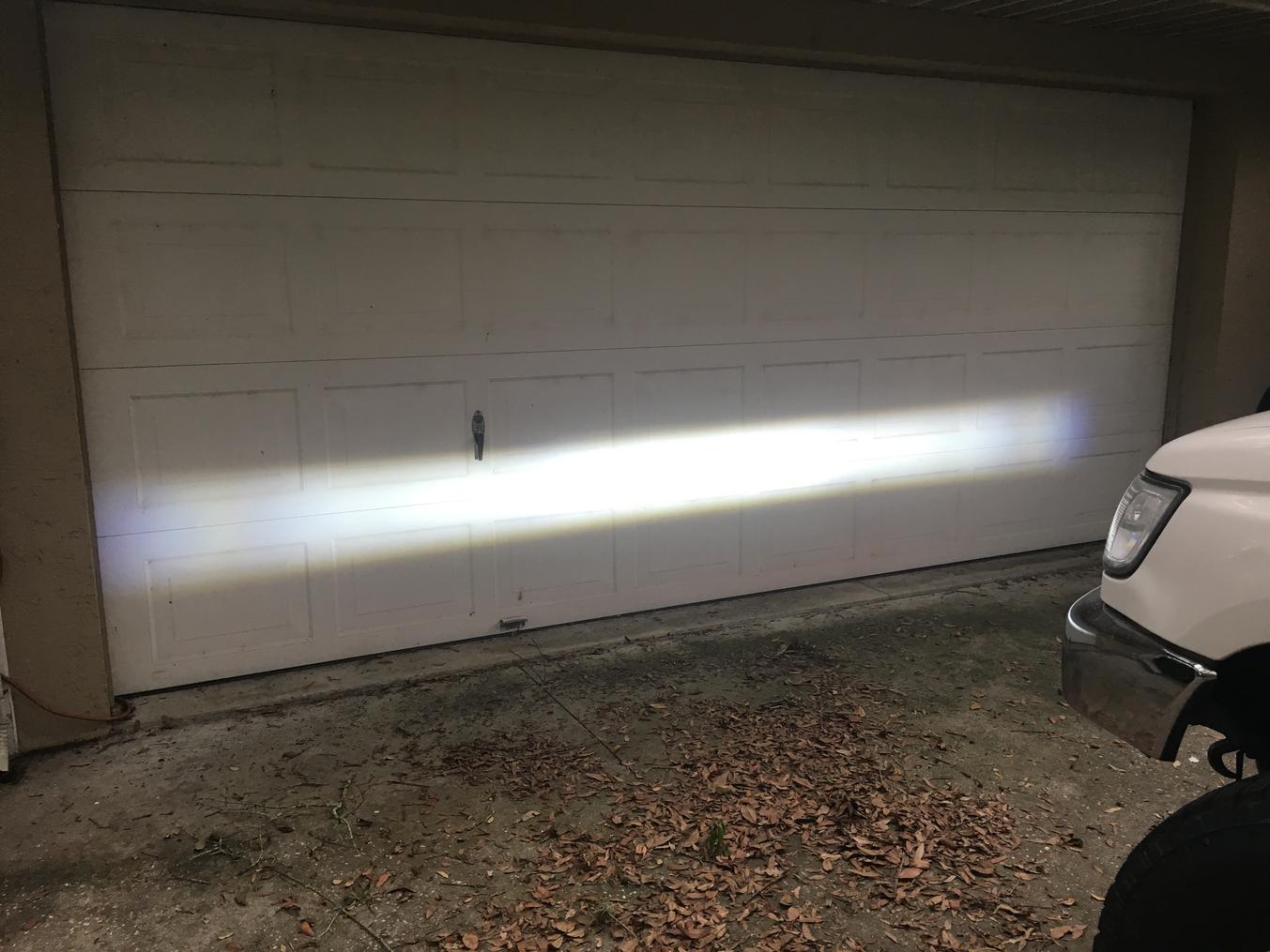

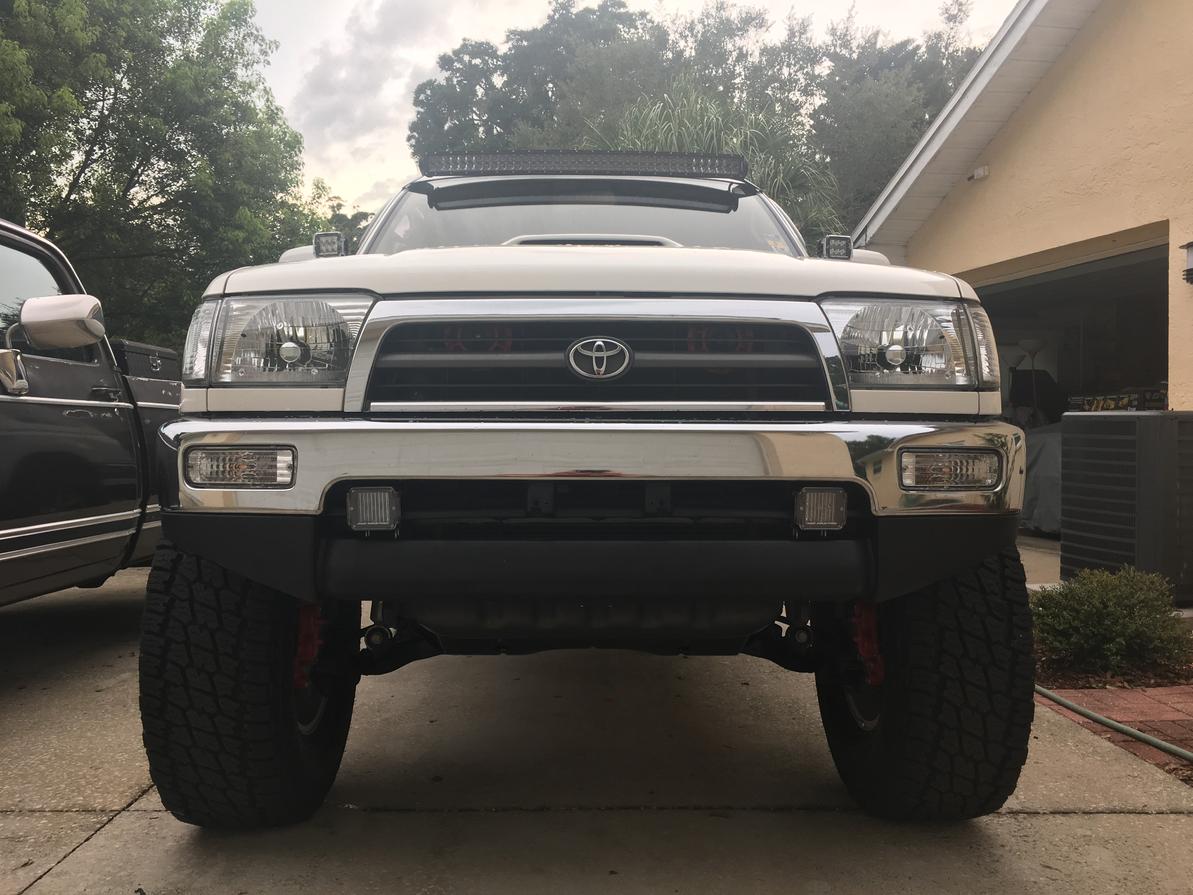

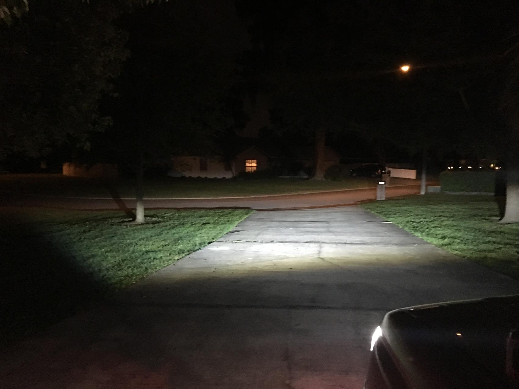

I picked up the Rigid 50481 Dually DOT approved fogs and mounted them in my stock bumper for $154. The width and definition of the beam pattern is crazy. Yes, they area little pricey but for the quality and the fact they are actually LEGAL to run on the road it is worth it.
These: https://www.amazon.com/Rigid-Indust...UTF8&qid=1512831958&sr=1-1&keywords=rigid+dot'
I love all my Rigid Lights and have had the D2s for awhile and have no issues with any of them. Some may say I have a slight addiction to lights :cool:

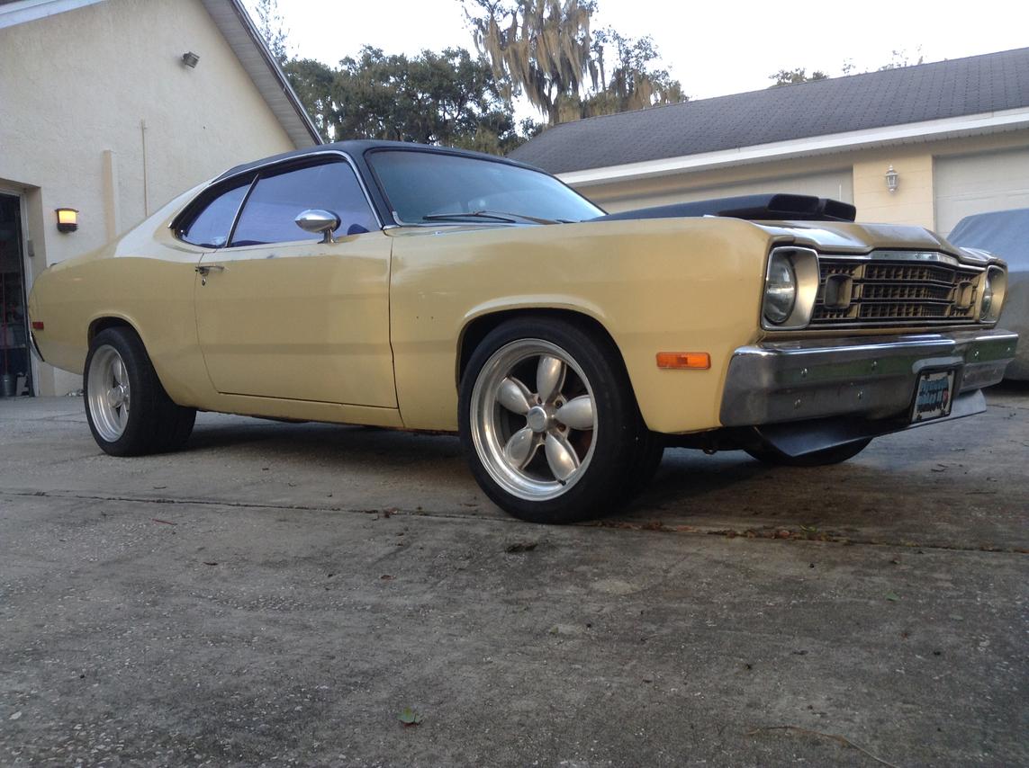

I'm building it for autocross/ road racing and beating the living $hit out of it on the street. I 440 swapped it, monster 4 wheel disc 13" front and 11.5" rear, 17x9.5 w/ 255s up front and 17x11.5 w/ 315s out back and a ton of other stuff but I won't bore you with the details and this is a T4R forum lol

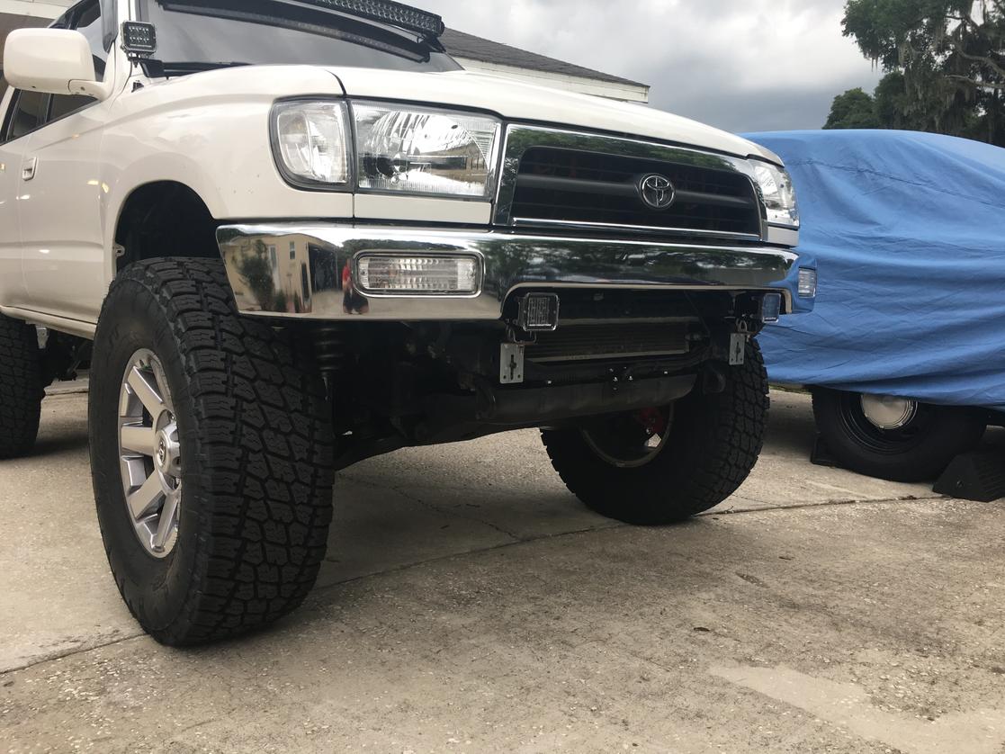

How did you actually mount your Rigid fog lights? It looks like you have the bracket on the bottom. Is it screwed into the valence, or is it attached to something more structural? I can't tell from your picture:
Thanks Cajun
I used some old garage door L brackets that I had laying around.
They look just like these: https://www.amazon.com/dp/B000JJMCS...t=&hvlocphy=9012091&hvtargid=pla-328130988407
First I unbolted the frame ends. To mount the bracket I bolted the dually to the bracket and held it up to the frame end so that it was close to the bumper on the top and marked where the bolt needed to be on the bracket. The old bolt was just a bit too big to fit through the bracket w/o modification. So a quick pass with a step bit and I was back in business. Bolted it all back on and aimed the lights to be fairly close.
After this I took the lower valence and tilted it up into place and just eyeballed where I needed to make cuts to clear the light and lower bracket.
