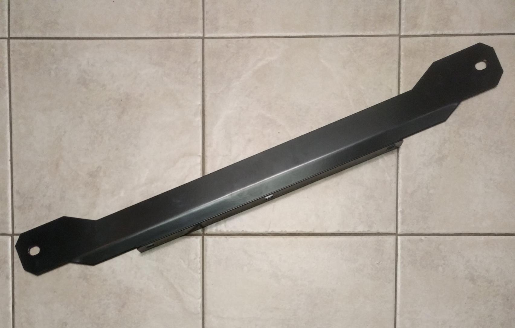

ARB supplied a bar for mounting "driving lights" that bolts together with the bottom splash guard that puts lights below the bumper and inline with the frame rails.

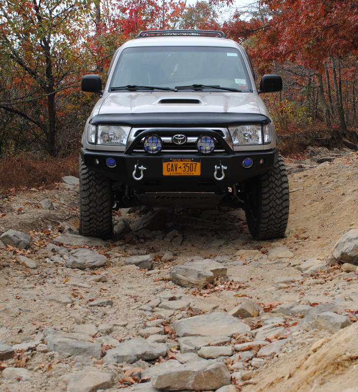

I haven't met a blizzard yet that can match 4 PIAA's. 2 - 6" & 2 - 4".
Lightbars are too modern looking for our trucks & PIAA's dont blind on coming drivers so you can actually use them when driving on the roads. LOL

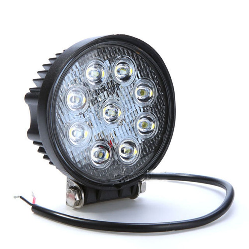

At this point, with two winter trips coming up before New Years, and snow/fog and maybe more smoke on the horizon (nod to [MENTION=65101]BrianSD_42[/MENTION]) I might just throw on those el cheapo HF ones [MENTION=129892]AntleredRuin[/MENTION] linked earlier. WTF I'm also not in a hurry to throw $200+ at lights just now (I shot my wad on bumper and shocks)
