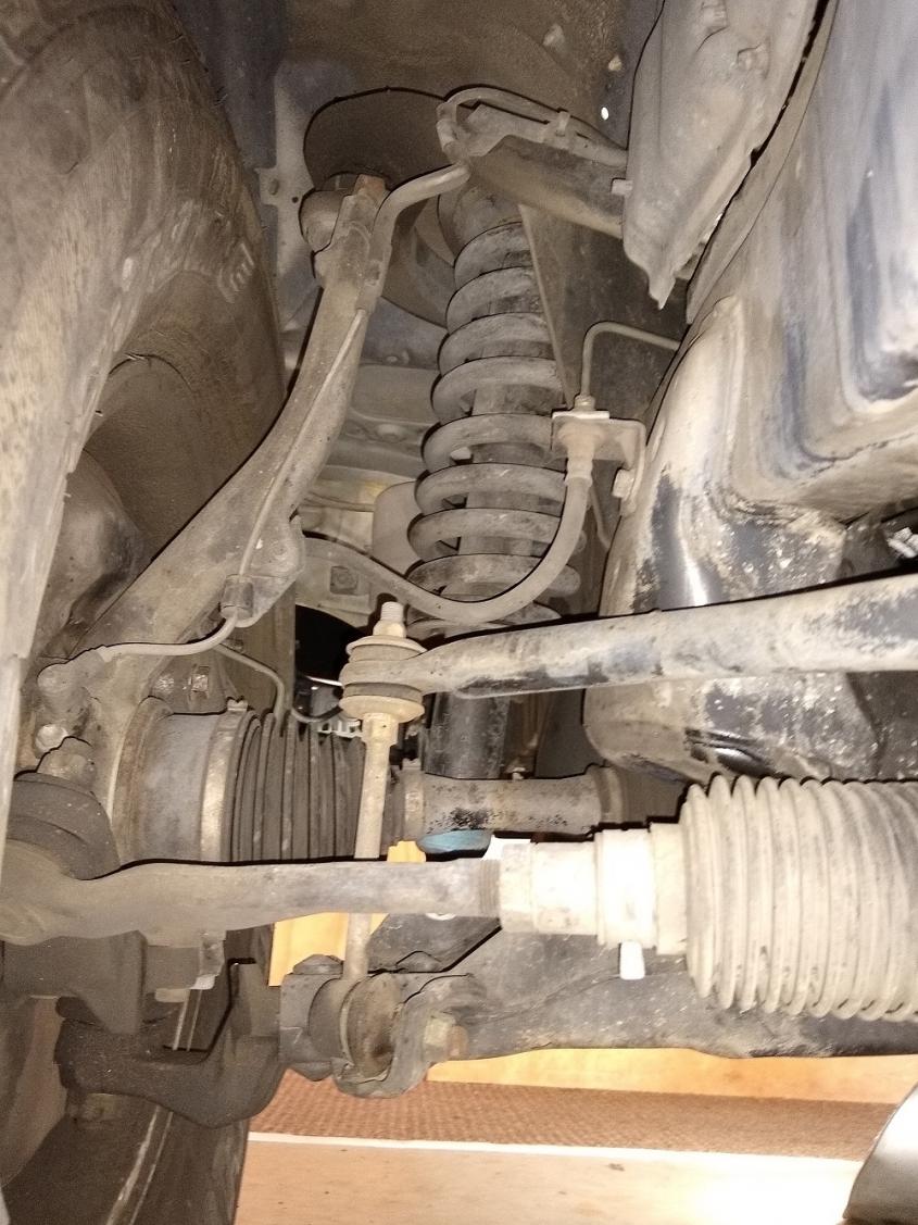

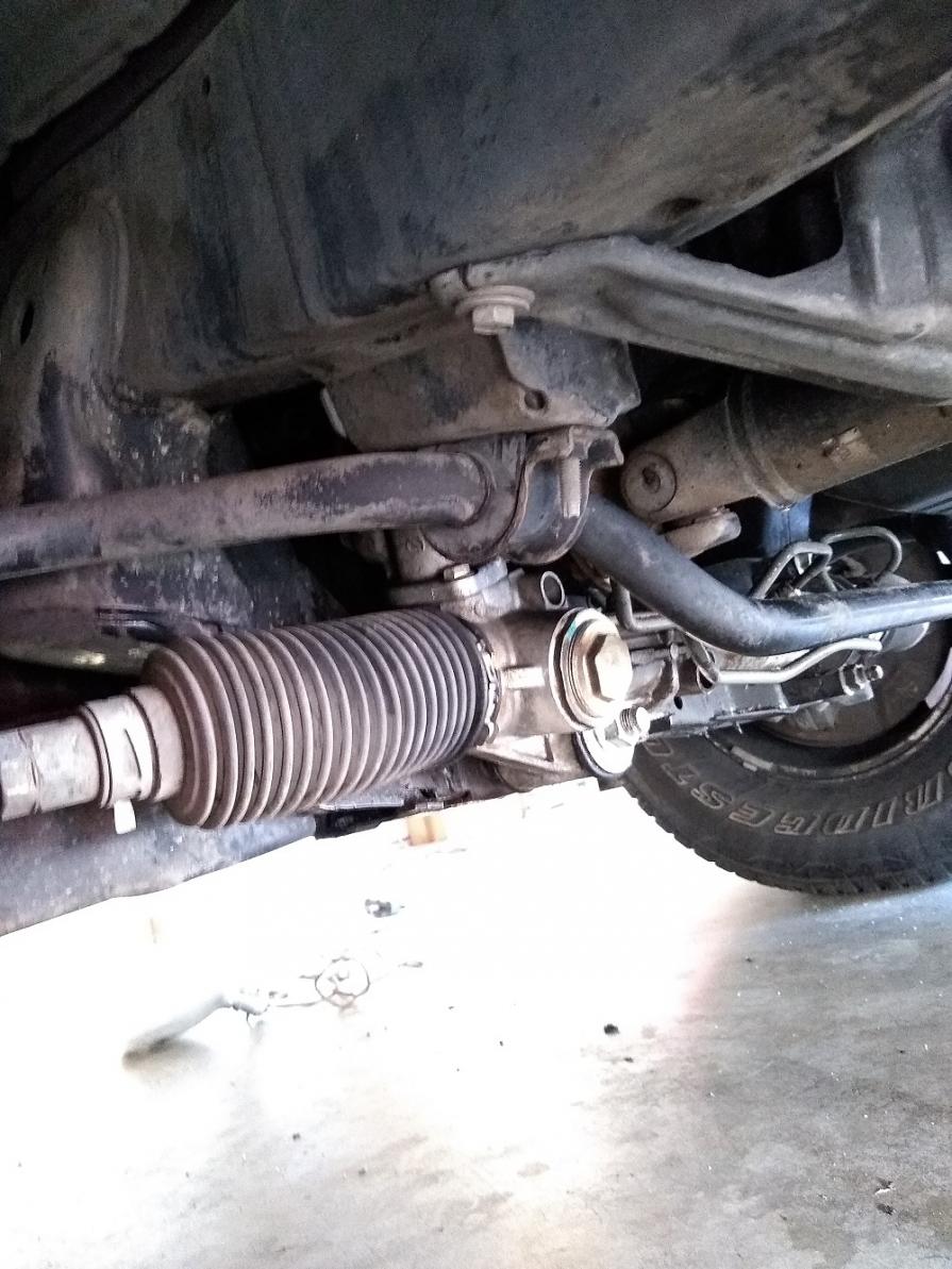

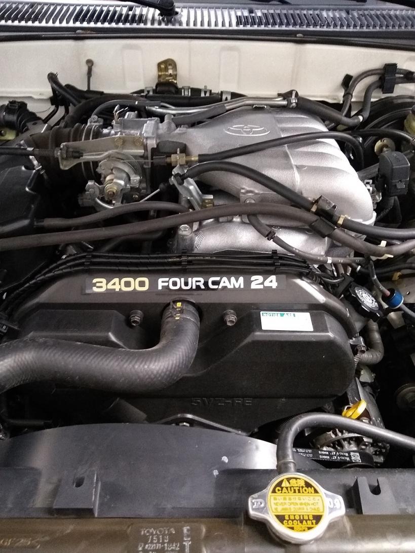

After a LONG search I finally picked up a 99 Limited 4x4 and its bone stock. The seller owned it for the past 16 years and before that his Uncle owned it who bought it new from the dealership. I checked multiple VIN history sites and verified, so I’m officially the 3rd owner. 224K on the clock, and a 3 ring binder stuffed full of maintenance records and parts receipts. The seller bought most parts from the dealer and had most maintenance done at the dealer. He even kept receipts for OEM windshield wiper blades going back years - which is crazy IMHO. Always garaged (so he said), no paint fade, no ripped seats, the doors, headliner, dash, etc., are all in great shape… even the electric antenna works. Well... you can see the condition for yourself in the pics. For undercarriage pics, I pulled both skid plates because I wanted to inspect. Some grime, but surprisingly not much, and not a drop of oil on my driveway in the past week. It’s had the real main seal replaced, so it was leaking at some point. No rust which is good (I’m in NorCal) but no E locker unfortunately.
Now onto business. 224K now, last timing belt done at 140K. Never had lower ball joints replaced, rear axel seals have not been replaced, shocks are gone...its like driving a waterbed (or mid 70's Cadillac.. haha). It was dealer prepped for sale and within the last 100 miles it got new plugs, new coil packs, new air filter, tranny drain and refill. I looked at the service records and there was no error code prior to sale, the seller just did these items.

I suppose I'm confused by that on the ball joints. If Toyota's are known to fail, why would we go back to them?
Because any/all other options fail sooner/faster.
The failure is due to design, not parts quality. That means ANY brand you use will fail eventually. Others have tried all the different options and found that they were doing the job again in a very short time. Simply put, it's cheaper and with less time spent to use the OEM replacements.

Stick with OEM ball joints.
I was in the same boat suspension-wise with my 99 Limited. I went with Bilstein 4600's and replaced the sagging rear springs with Old Man Emu 906's to eliminate the rake and add additional carrying capacity. Rides fantastic.
I don't think they are known to fail, exactly. They will fail like any other part and there was a recall but only for 01-02's. The failure seems to happen more with lifted trucks or trucks in extreme service.
If they haven't been replaced they should as when they fail it's usually pretty ugly. The new OEM ball joints wouldn't have any known production issues, and with such a critical part saving $50 on a knock off isn't a way to save money. Good piece of mind knowing your wheel isn't going to fall off at freeway speeds.

Congrats, nice ride. Add a radiator to the list to prevent strawberry milkshake. That one looks original. Google that term if your not familiar.
Very nice looking rig !
I would change the radiator and fuel filter also if they haven't been done.
Look up "pink milkshake" and you will change the radiator.
Toyota OEM ball joints fail around 100k lifted or 200k or much longer at stock height (mine were still fine at 270k miles when I replaced them). Aftermarket lasts less than 30k, and often fail as soon as 10k miles.
Consider them a wear part and replace with OEM.
