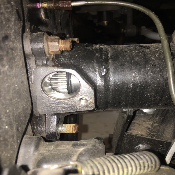

So I've got an update. I pulled the leaking axle shaft out and about 1/4 cup of pretty nasty oil came out with it. I was thinking this isn't good. Set the axle aside and noticed a hump of metal shavings built up on the ABS sensor. Well shoot....something obviously went sideways with this install. I grease the retainer and slide the axle back in. Tighten two bolts to pull it tight and I took a peak through the ABS sensor hole. I didn't even bother removing the axle to see the grease mark afterward. I pulled the other sides ABS sensor and the exact same thing.
I can see why its leaking but I don't understand where the metal came from. This is of ultimately my fault. I didn't check the seal was riding on the retainer before putting it into service. The fellow that pressed on the parts sure talked a big game. I'm going to stop by and see him tomorrow after work.
I just wanted to update the thread as fixed. I purchased the tool (from donald-the-bonald) off ebay and a 20 ton press from harbor freight. Followed Tim's second video and it went smooth. The shop that I had press on the bearings originally just guessed at the location. They had pressed them on so far that I could not get the removal tool underneath to remove them so I had to cut them off. Kind of a pain but all's well that ends well. The tool was top notch and had everything I needed.
