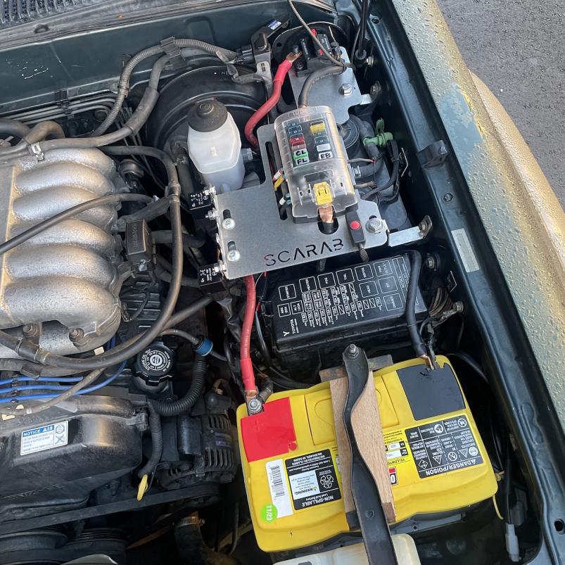

Not saying this is a great battery. I needed a battery and went with this to try something different. Just adding it to the mix. Group48 AKA DH6. It does use a DIN post which prefers a bit smaller or adjustable negative terminal. It's a little shorter, hence the wood shim. I'll raise it from the bottom eventually. I used a lead shim from Autozone with the factory ground for now. I also took a picture that is doing no good on my phone so here it is....
