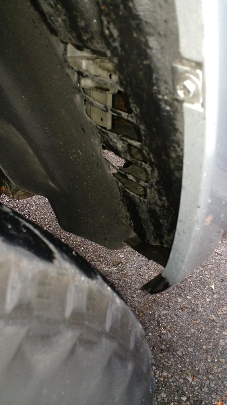

Hey guys after a surprising 65k mile run on my Dunlop Maxx Tractions which I loved, its time for new tires and unfortunately the Dunlop's are discountinued. I'm running 1.5 SAW coils in back with 2.0 OW shocks, and the 2.0 OW CO's up front set at 2.5. In my tire search I came across these BFG's I didn't think the KO2 was new but maybe this is a revised design.

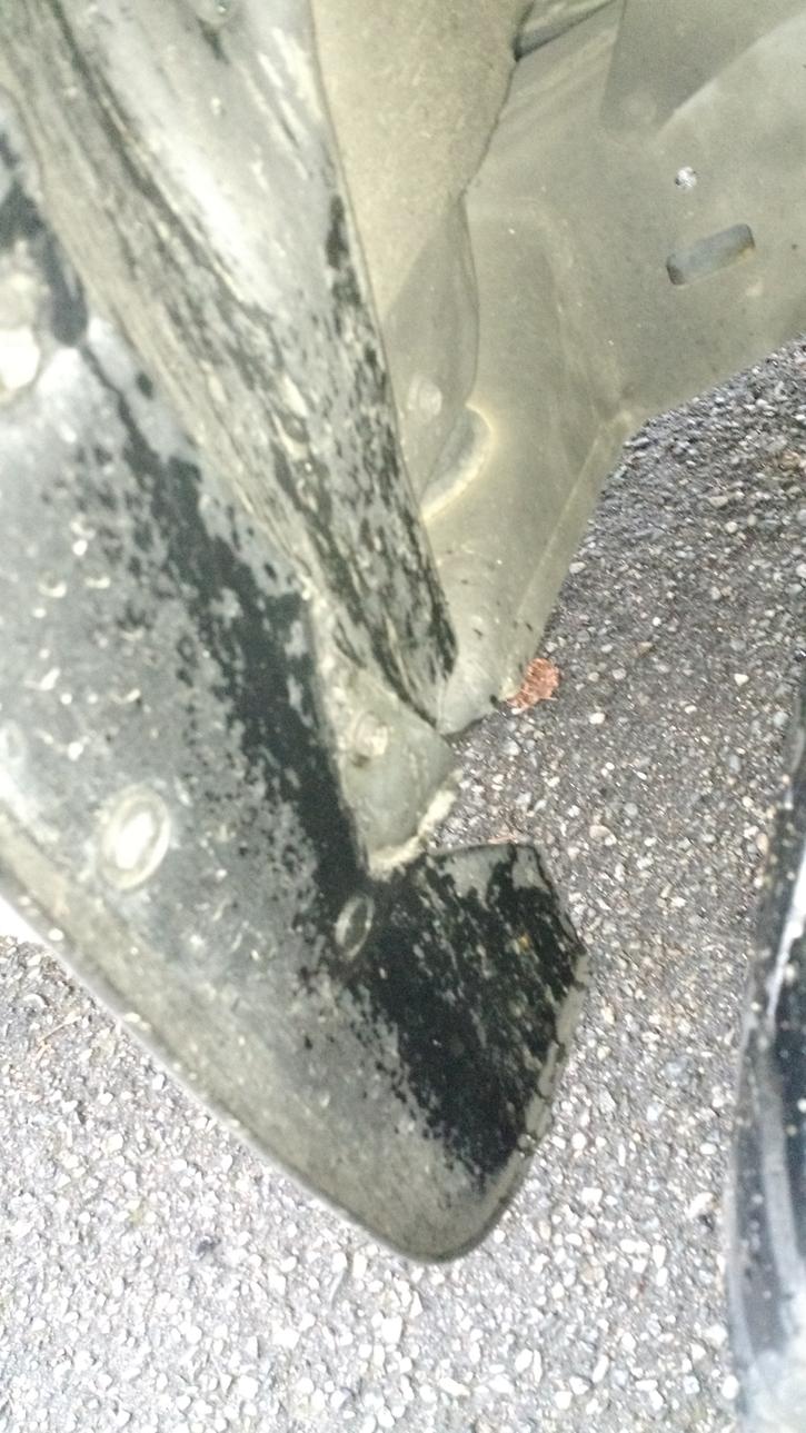

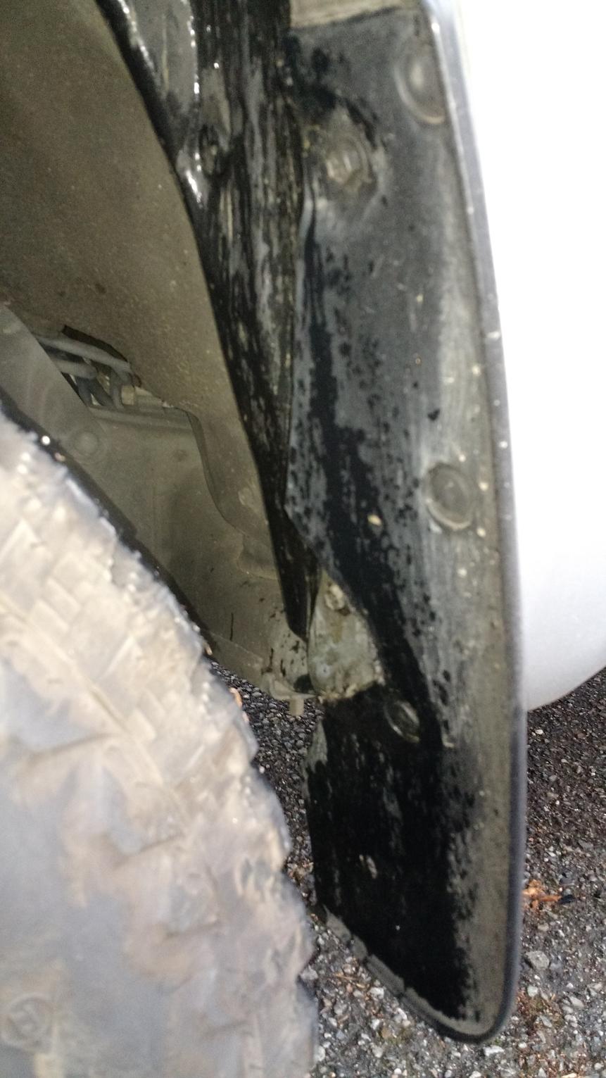

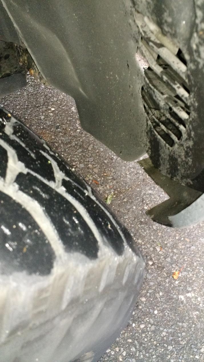

1. Would the KO2 above in LT275/70R17 size fit with my lift and my procomp 7005 wheels with out rub? I trimmed already per the attached photos so I could run the Dunlops pre lift.

1 - You shouldn't have trouble with that suspension setup and tire size. I had that exact suspension setup for a while with 275/70R17 GY Silent Armors and never had any problems with rubbing. I was, however, running OEM wheels with Spidertrax 1.25" spacers, I believe those equate to somewhere between 0 and -10 offset.

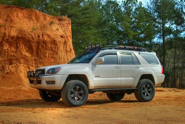

Here's mine with the OW shocks, SAW rear coils, and 275/70R17s
