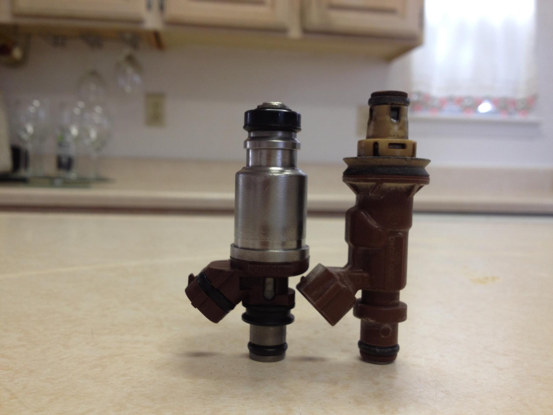

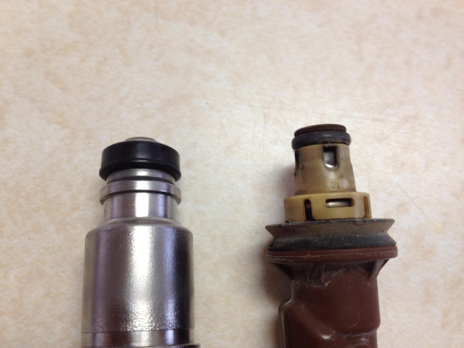

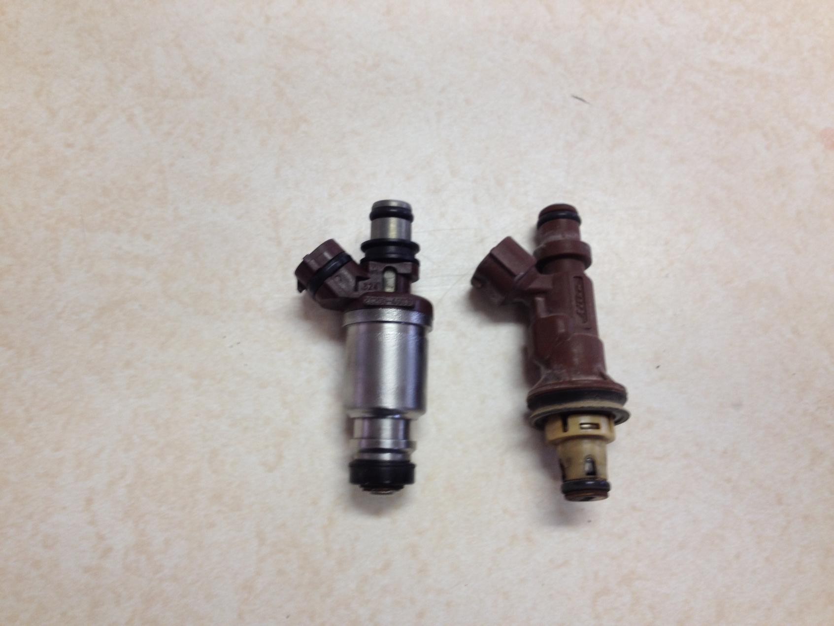

These are my new injectors I got off ebay with my supercharger description says 6 larger fuel injectors that plug straight into the stock wiring harness. I was trying to instal them today but didnt seem to fit or seal right. Is there a way to make them work?

From the pictures, no, they won't fit. They don't appear to have the right design to snap in and sel into the fuel rail. Sorry to break that to you.
