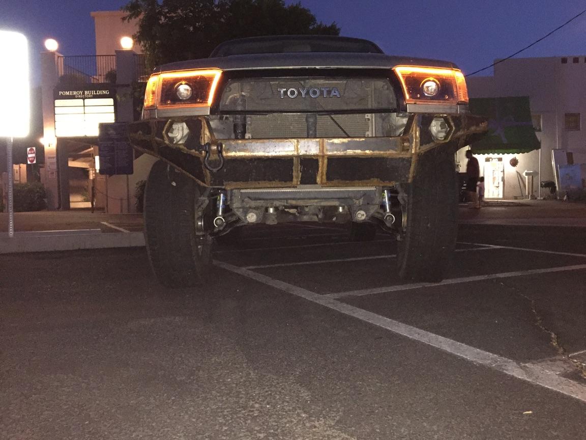

Just installed new boss coil overs and have ridiculous amount of camber. I know I need alignment but is this normal? Tires squealing on many bumps and almost every corner. Did I put them in wrong? Feedback appreciated.

if its worse than this, something is wrong, otherwise there is not a problem, did you do the part where they say to get an alignment?

You don't need to undo the upper ball joint to get the coil over in. Pry down on the UCA with a long pry bar and it will go right in. Loosening the UCA and LCA bolts releases the tension on the bushings and makes it a lot easier to pry it down.
As for the camber, yes you just need an alignment. Nothing is wrong there.

My camber and toe also looked just like this after installing my lift. completely normal, the more you lift it the more your alignment will be off.
