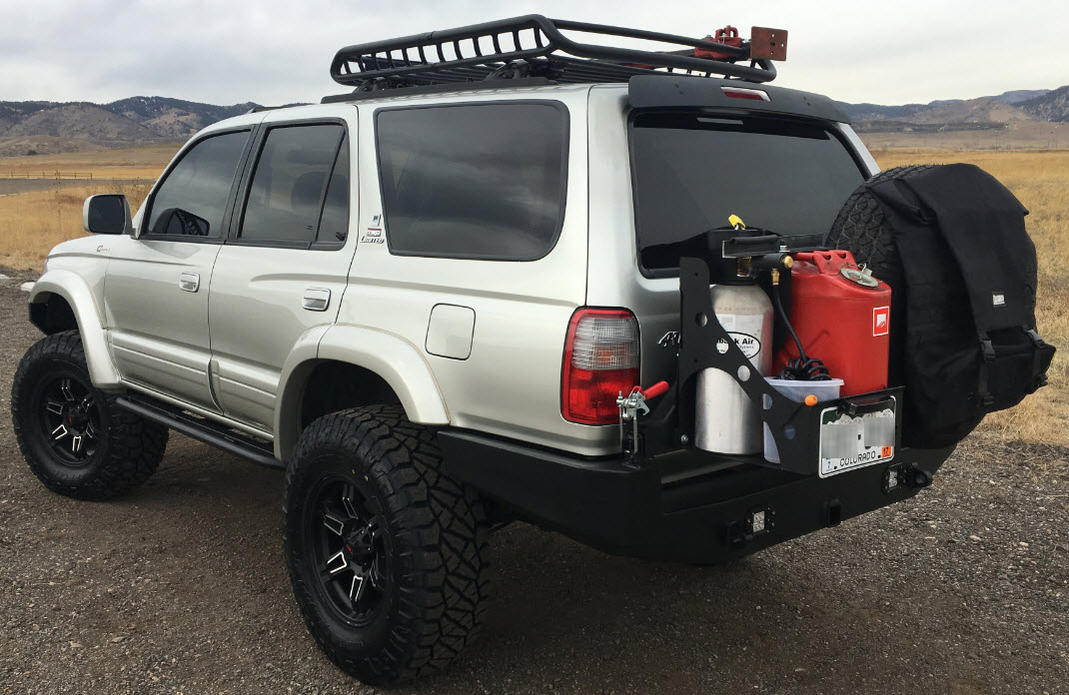

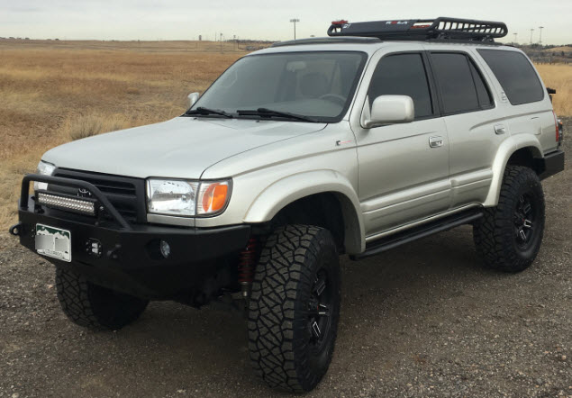

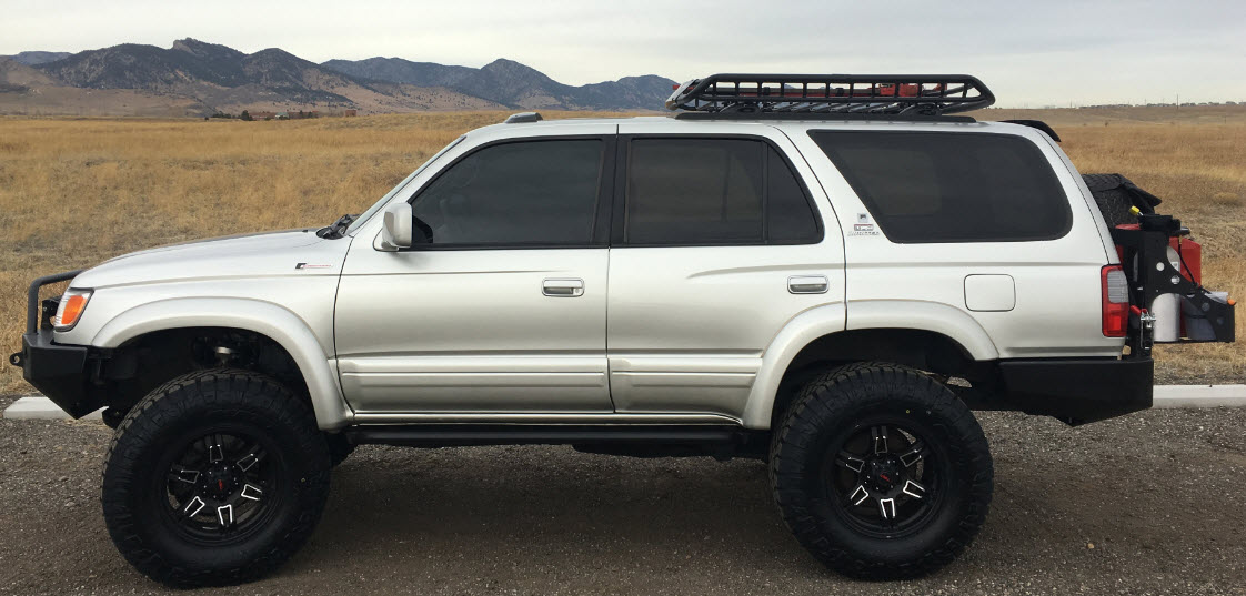

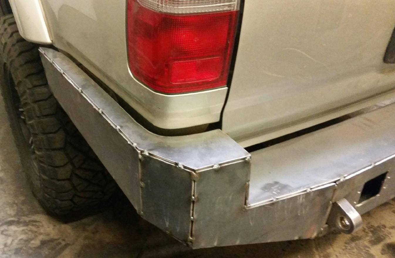

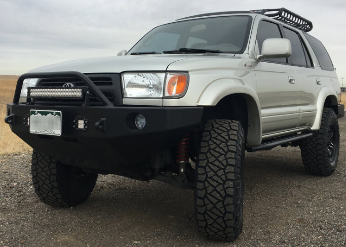

Well, so I finally got some pics of my new custom fabbed bumpers! While I was in the queue I did my rad and a tranny cooler etc. as well so the downtime was productive.
Local CO guy here does AWESOME work! Loren, First Choice Fabrications...down off Broadway in Littleton. Let me know if you are local CO and want his info. He might ship too but that could become cost-prohibitive.
I am very happy with the end result and they came out even better than I had hoped. It ended up being slightly more than going CBI/Shrockworks etc. but there are some details in these that I really like such as:

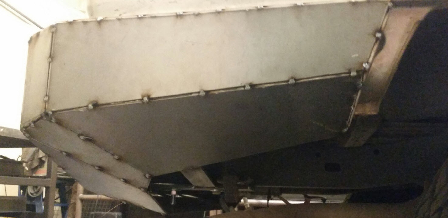

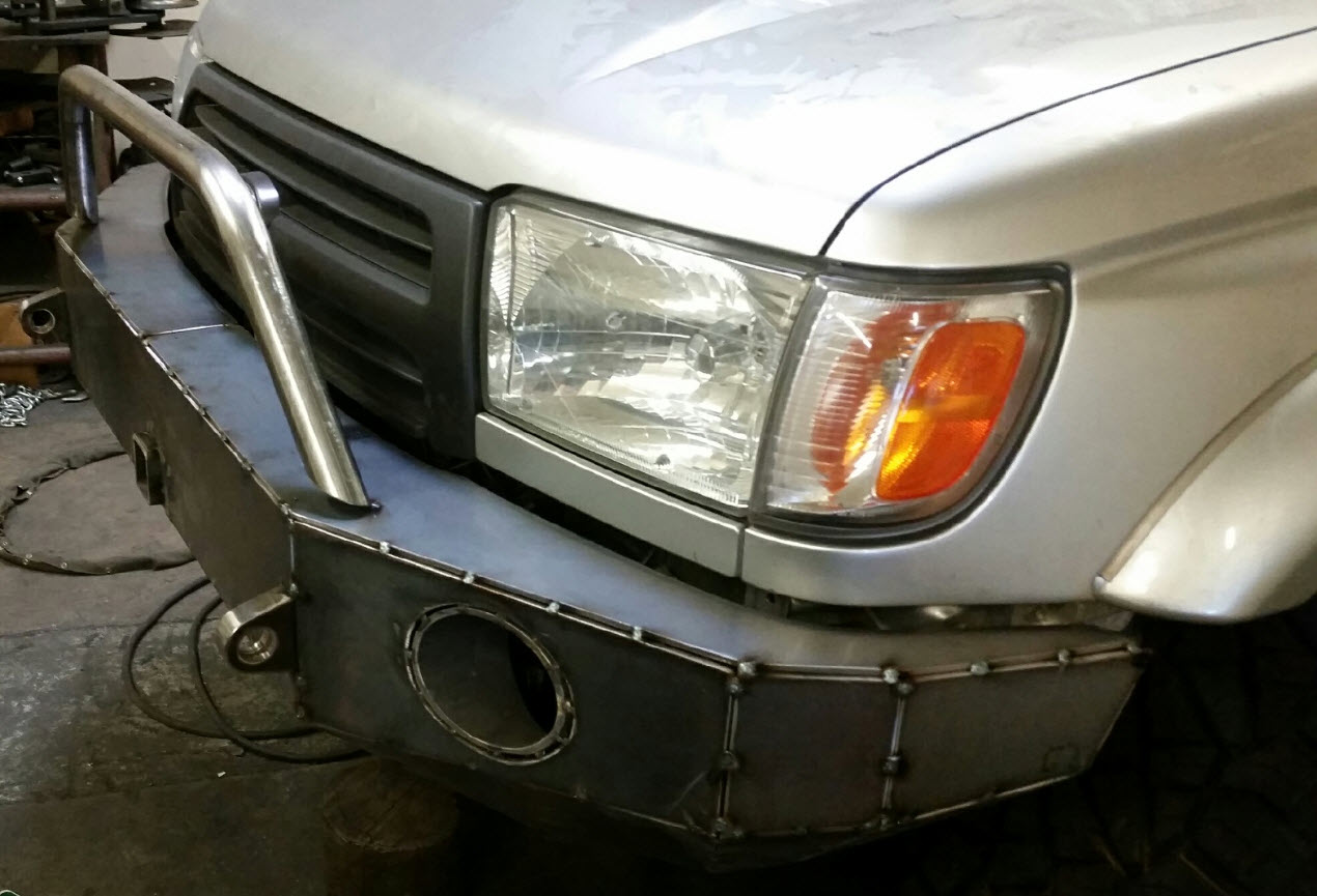

-Mild wrapping underneath front for protection
-Full radiator protection front
-2" receiver front for my remote winch setup

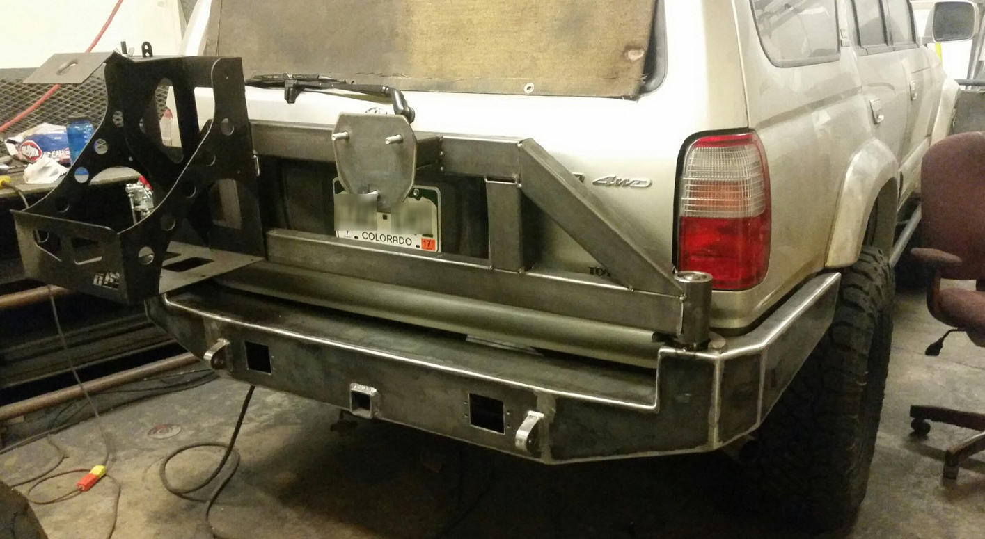

-Receiver hitch frame tie-in's front and rear
-Rear hinge lock on swingout
-Preloaded gate (keeping it nice and tight for years to come!)
-Overall beefy and perfect gaps to my specific rig
Pics:

Thanks man! I am so happy with them! In some ways it does look a bit like Addicted but no dedicated winch mount since I wanted a 2" for my remote setup. I'm not sure where he gets his inspiration but he has a style with most of his projects and we looked at some of the other custom ones out there. When he mocked it up I loved it. I think it covers a bit more underneath than the Addicted and his "corners" have three welds instead of two which I liked (he said he grinds a minimum of 8 hours on each bumper!)...similar though for sure.
How much does that rear bumper weigh? It's pretty sweet!
Thanks man! We didn't weigh it but he says they are typically within 50 lbs of many of the other aftermarkets. He does add a bit more with the frame tie in. They are manageable with one person and a jack or other support but of course a LOT easier with two.
But, with the 891 coils it really only starts sagging a slight bit with full Gerry can and gear in the back. But since I sometimes pull a dirt bike and adventure trailer I may solve that with bags. Going to go down to Toytech since they are local and have them scope it out.
I'm digging the rear with swing out, but seeing as it's custom I'm guessing he would need the truck for a few days to do one.

So it depends on some of the custom options like the swing latch, frame tie-in's, light buckets, etc. and I did let him provide the lights as well since he buys them in bulk and the prices were good. Let's just say you're looking close to $4k but that's front and rear with swingout, fully lined, built for my 1" body, all lights, installed and don't forget that's including sliders too out the door.
I did a LOT of homework on this and If you add that all up with CBI or Shrock plate bumpers and sliders finished and shipped it's comparable...plus most of us still would have to find someone local to weld the sliders on and of course buy lights etc. too.
Also ya so more than a day for all that. He had it about 2 weeks.
Oh and he's usually 3-4 weeks out. The word is out and he's busy.
He's a pro though and you get the custom experience with pics all along the way. He also has a shop so your rig is inside and locked up the entire time he has it.

That's a beauty. I'm curious about your remote winch setup. Do you have anything yet? I am trying to keep the stock bumper on mine and am thinking I might want a 2" receiver in the front for that.

I'll have to post up a pic. It's a Warn 9000 mounted on a cradle and I used forklift battery connectors on some long jumpers so it can be used front or rear. I also have a synthetic line on it and overall the weight isn't bad. Very easily managed by one person.
There are some reasons that a bolt on front setup can be better but I think they are minimal. One can be that side winching is perhaps not as stout but as my buddy pointed out that is a rare scenario and typically less resistance (snow or mud) when it happens. I like the versatility of rear winching but even more I just like not having it up there and in the elements and the extra weight all the time. The cradle sits nicely in the back under a shelf I made.

No offense intended, but for any serious wheeling, a front permanently mounted winch is the better solution for multiple reasons.
Side pulls happen almost every time I've seen anyone use a recovery winch in the rocks. The degree of side pull varies, but it's rarely straight ahead....I'd say 30-45º is a normal angle....but frequently, 70º+ does happen. Good removable (hitch style) receiver designs will often include 2 or 3 legs to the frame to mitigate the side pull issue.....but phasing the legs to one another can be problematic....couple that with having to get them into the receiver when they are buried in mud or there are rocks blocking the approach can make that difficult if not impossible to attach to one end of the rig.
The biggest problem with detachable setups is that they are absolute clearance killers once installed. This kind of setup lends itself well to having to winch out of a mud hole, but not up an obstacle.
Lastly, weight is weight. Yes, weight distribution matters in certain instances, but you're adding a very heavy winch plate set up to cart the thing around in....something that wouldn't be nearly as bulky (or necessary at all; depending on design) by mounting it permanently in a bumper.
That's another thing to consider: if weight up front is such an issue....why put on a plate style bumper that weighs as much, if not more than your winch?
Regardless, the OP's bumpers/sliders look very well made and are extremely nice. Just giving an opinion on the real-world practicality of QD style winch mounts and weight consideration.

Yep I hear ya and surely that bumper is weight. I think it's more the versatility and having a bit more of an overland build. I admit it's on the road 95%. And, though I would and have done trails with it here in CO into the 6 level ratings I learned with my jeep I didn't really like the hardcore stuff.
So for sure you have some valid points but again...for what I want I think this will work great. And, his frame tie in's are stout so I think they can be trusted. Also on our 3rd gens since the bumper is so high anyway it helps a bit with the clearance. The rear in that regard is worse for sure but that's an even rarer situation to winch backward.
Good discussion and I do get your points. I had thought about it a lot. I guess after all the wheeling I have done as well and figuring out the type I like to do and especially with this runner it was the way to go for me. lol beats the heck out of a comealong!
And I didn't mean you personally were making a bad decision in the slightest....it sounds like it's perfect for your uses....and that's all that matters.
