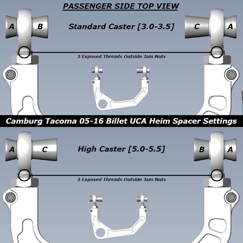

A new design we incorporated is the ability to adjust/tune caster 2 degrees by changing the orientation of the spacers in the heim joints. We have a standard setting that puts caster around 3-3.5 degrees and a high caster setting of 5-5.5 degrees for the serious off-roaders or highly lifted trucks that are already low on caster.

The high caster option in tuning the arm placement fixes many reservations I've had with the Camburg arms (low caster numbers moving about 2.5" lift), but holy hell that is an expensive piece.
So I am guessing if you want 4 degrees of caster you are SOL? lol.
:eyebrows: Isn't that the 'Sweet spot' though? I guess it depends on the application but I see where many with a 2.5" + lift trying to get to 4.. not 6! LOL
I feel like you might be guaranteed some rubbing if you go to 5.5? :noidea:
3.6-4.9 Technically :laugh:
I'd agree with that, I can't see many people with 5th gens using that high of a caster. Maybe those using the the fj 6" lift, but there are very few of those around. My 3rd gen on the other hand could use that high caster though lol.

As for Caster, depends on your set-up. I have to run 5.5 Degrees on my 4th gen to get the 35's NOT to rub on my already modified body mount and the hammered pinch welds (was happening on turns under compression at 4 degrees where I had it set for my 33's). I know a coupe guys have gone to 6 degrees when they went 35's.
