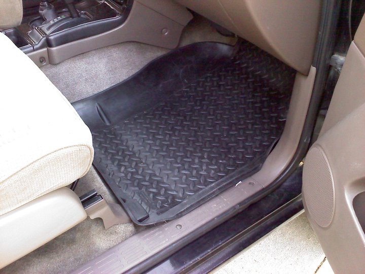

Great info man. And nice work. Now you can get some Huskey liners and keep that carpet pristine!

Like someone mentioned... get some good mats like Husky or Weathertech.
I've got some regular all-weather matts, and they don't work well at all because they don't curve up the sides like that. The snow from my shoe constantly melts and fills up all the groves and leaks over onto the carpet.
