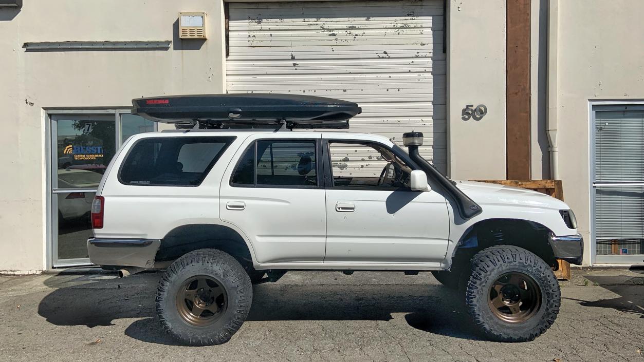

[MENTION=402644]mesooohoppy[/MENTION] I'll get to updating my thread one day lol... I added the pre-cleaner because I do a lot of desert driving where the dust is rampid. Cut the snorkel tube down about 2" and then had to modify/persuade this pre-cleaner to fit inside the tube as opposed to the ram-air style which goes over the snorkel tube.
The pre-cleaner has another advantage of not being a straw for water when driving in the rain.

thank you. that is something that crossed my mind with the original snorkel. i will have to copy you and do this mod in the coming months as i go play in the forest every sunday with another 4runner.
