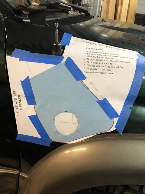

Alright so I got the template all taped up and I ended up making my own template with a paper towel. If I drill it in the spot that the template says the bottom of the snorkel would be on the fender flare sort of so I moved it back about an inch until it seemed to line up better...

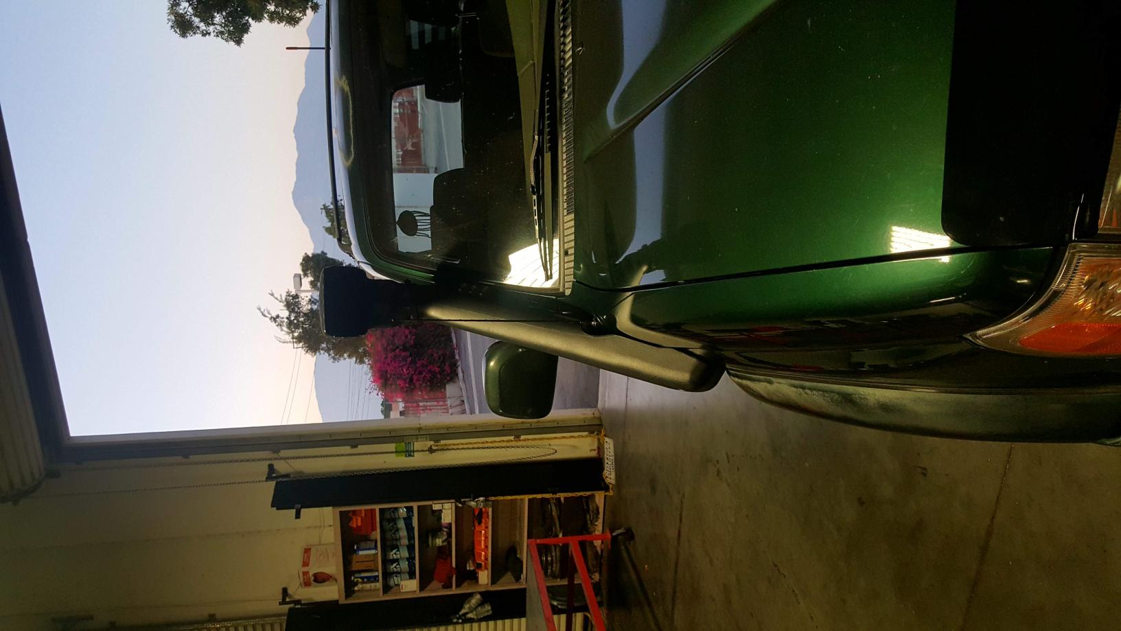

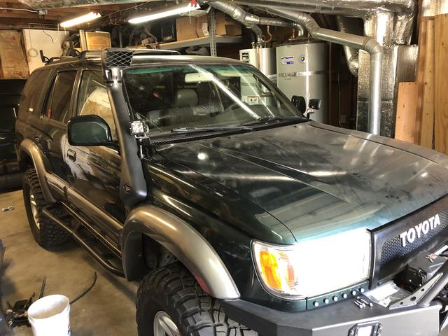

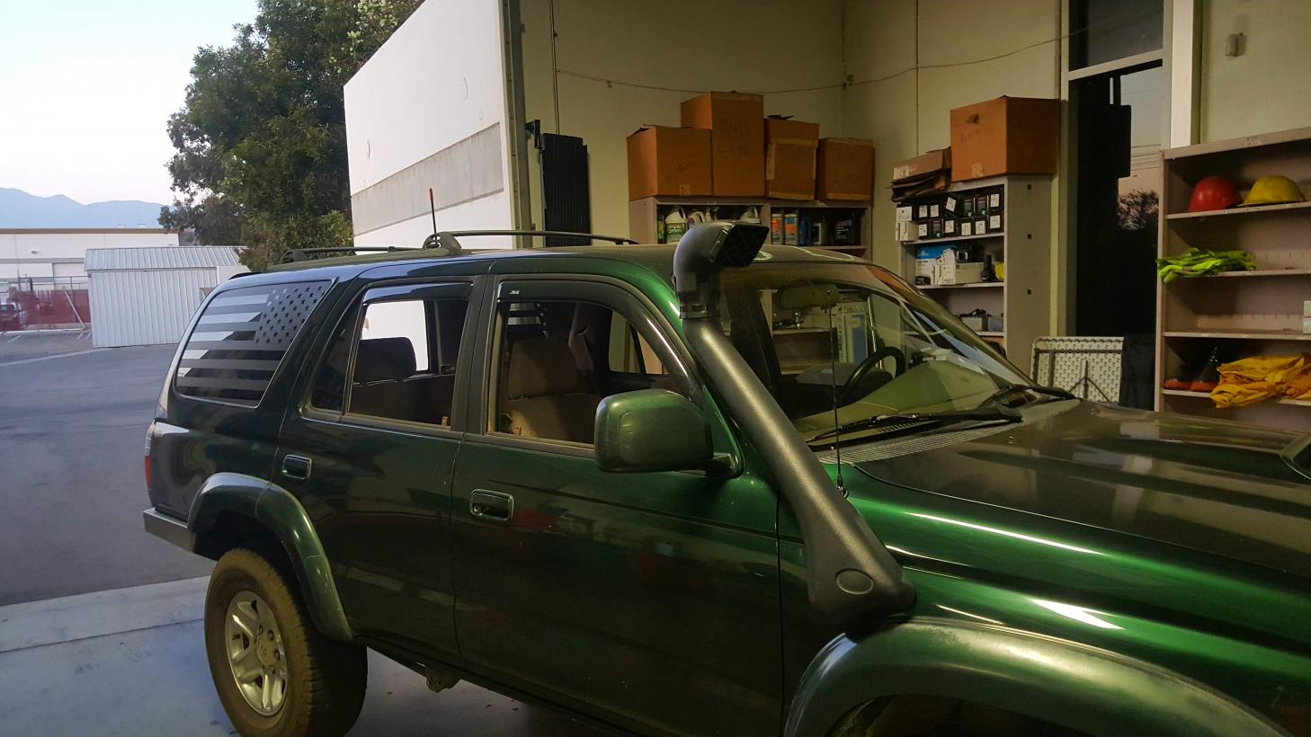

welp, got my snorkel saturday and installed it yesterday. looks great, went pretty smooth minus bolt holes not lining up exactly but they give you big washers so I stepped up a size on my drill bit and was successful. I was able to get all 3 bolts on I just massaged the metal out of my way with a 3 lb sledge and a metal rod and I was able to keep the factory electric antenna :thumb3:
for the antenna I had to remove it from the fender well and cut open the dust cover then loosen the bolt holding the actual antenna piece in and rotate it 180 then bend the existing bracket 180, put the dust cover back on and use some electrical tape then pop it right back in backwards and it clears the snorkel as well as the door. still functions perfectly.
<a href="https://imgur.com/ITjCyP8"><img src="https://i.imgur.com/ITjCyP8.jpg" title="source: imgur.com" /></a>
<a href="https://imgur.com/4uLy81p"><img src="https://i.imgur.com/4uLy81p.jpg" title="source: imgur.com" /></a>
<a href="https://imgur.com/xJRzOlR"><img src="https://i.imgur.com/xJRzOlR.jpg" title="source: imgur.com" /></a>
<a href="https://imgur.com/4Ts2QrR"><img src="https://i.imgur.com/4Ts2QrR.jpg" title="source: imgur.com" /></a>

Sweet! Good to hear the antenna still works, looks great!

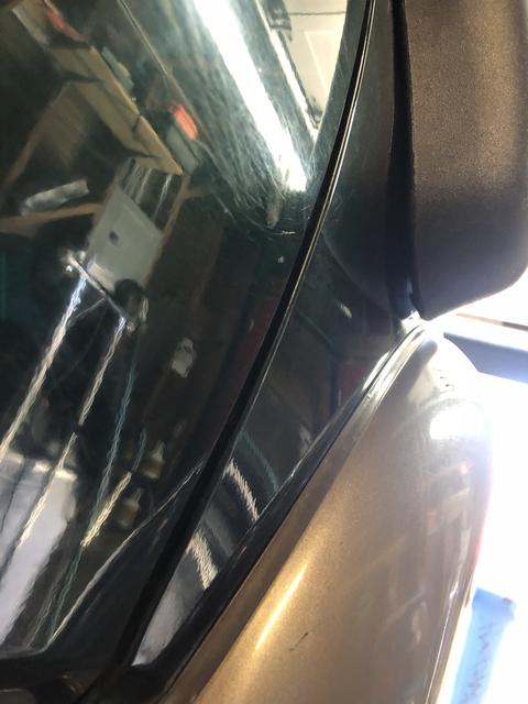

Installed my snorkel.. might have to try to adjust it a bit though as I think it might be off a little.. the front looks fine but the back has like a 1/4” gap between the snorkel and the fender.. is that normal?
Here’s the gap I’m talking about..

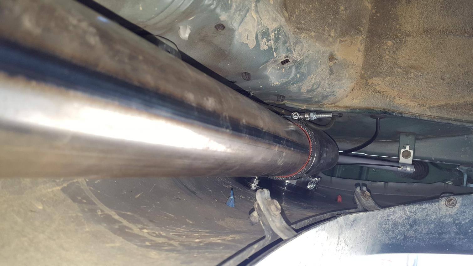

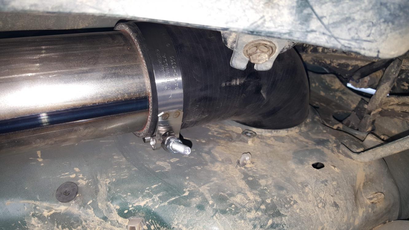

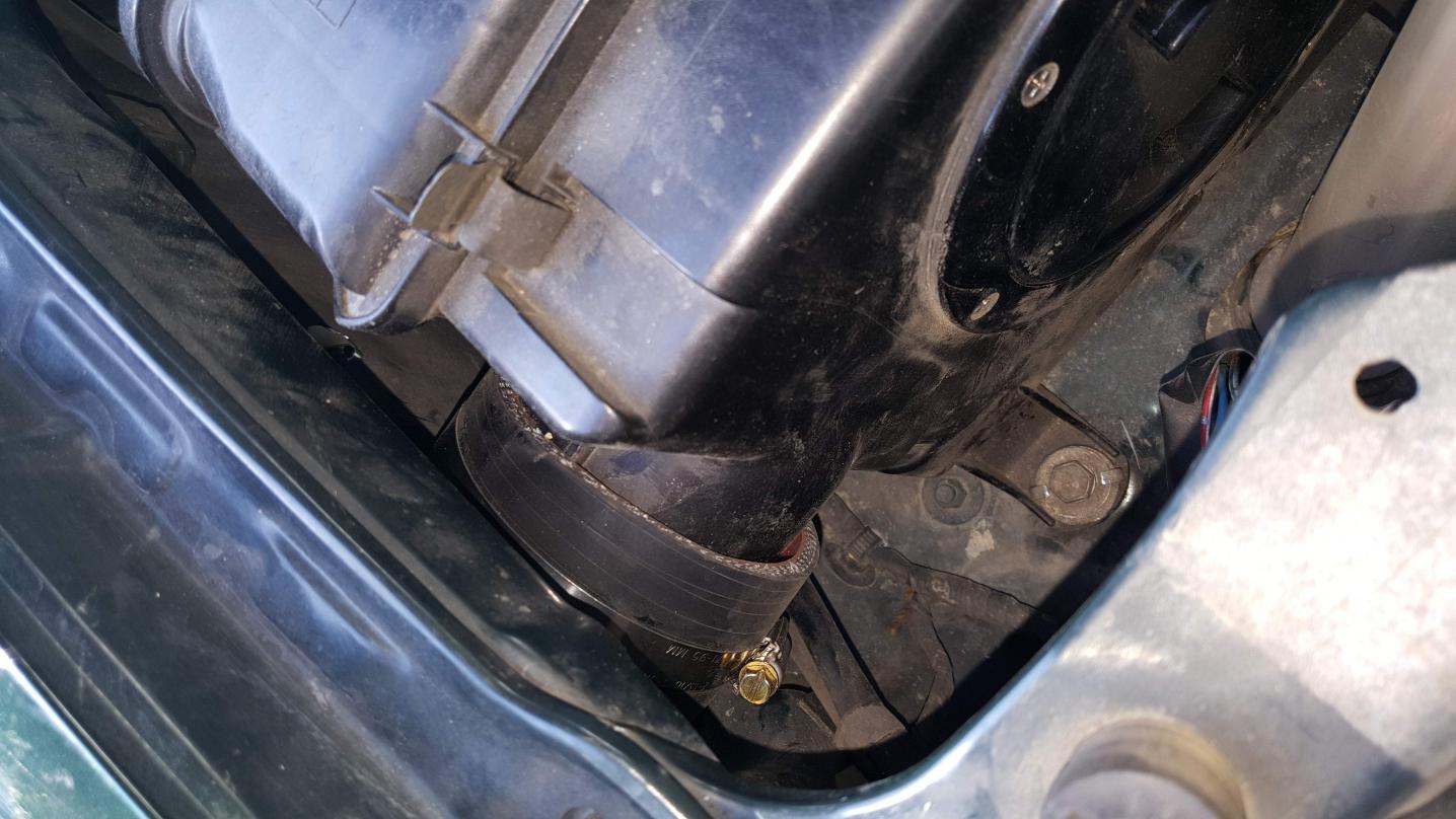

Well might as well throw mine into the mix. I used the template exactly as instructed for the tacoma. Fit perfectly, no need to enlarge holes including the snorkel hole. One thin I did have to do was lose the rivets. I got 2 done and they were loose as all can be. So drilled them out, and used some self tapping screws with a ship ton of silicone to seal it. Didn't realize I needed the tacoma air box thingy, yeah no way I'm paying 100 bucks for it. Did some measuring, snorkel opening is 3", air box side inlet it 3.25" (tight fit). Ordered what they call a cobra head elbow and a 90* transition. With some 3" steel pipe we have at work. Works perfectly. Also FYI the top of the snorkel is 3.5" roughly if you want to use a prefilter on it.
Also through that tiny hole you can see the hoseclamp, it's like toyota designed it perfectly to use a 1/4" extension to reach the clamp to tighten it, well that is what I'll believe lol.

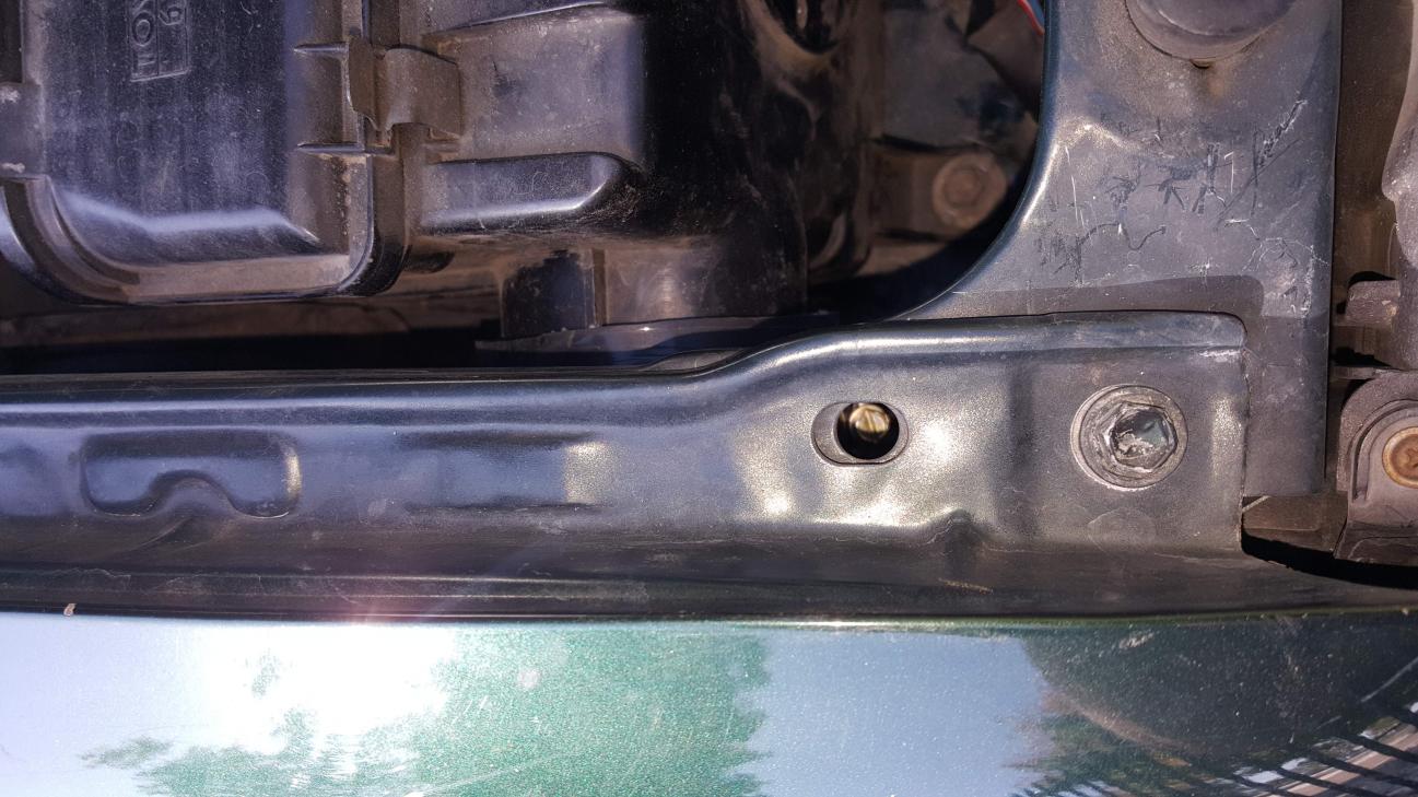

Got mine on, left the fender on, but pulled the liner obviously. I put my holes exactly where indicated by the template, but slightly oversized, the fitment is great, tight all around. Top bolt went ok, I used a ratcheting wrench, but I'm sure a regular wrench, or shallow socket on a 1/4" drive handle would be fine. My power antenna has never worked, and was in the way. I dropped it down 6" or so just to have an antenna until I do a taco whip.
The biggest issue was my rivit gun won't fit to to the top mount. I already drilled the holes before I realised it wouldn't fit. I am going to try to find the world's narrowest rivit gun, or put in rivnuts.
think that could be from moving it back from where the original template went?

Not really sure, I think it was mostly cause the antenna motor was pushing it out sort of.. Hard to explain but it’s all a really tight fit in there. Where I moved the template wasn’t right and where the template was supposed to be wasn’t right either.. If I put it where it was supposed to go the snorkel would’ve been on top of the fender flare.
