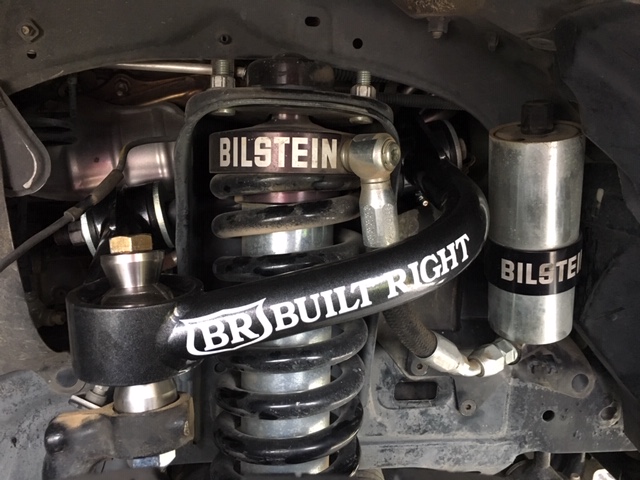

I'd like to hear some opinions on what would be one step above the quality of the Bilstein 6112's. I've had them on two 5th Gens 4Runners with a hidden winch setup and have been very happy with them, but looking for a step up for a new 4Runner with a similar winch setup.
I do want spanner wrench adjustable ones this time.
Thanks in advance!
any 2.5" adjustable coilover would be considered the next step up.....the "only" thing the 6112's are lacking is rebuildable and threaded body.
Pretty much what he said. I went from 6112's to Radflos because I wanted adjustability without having to tear everything off each time I adjusted heights.

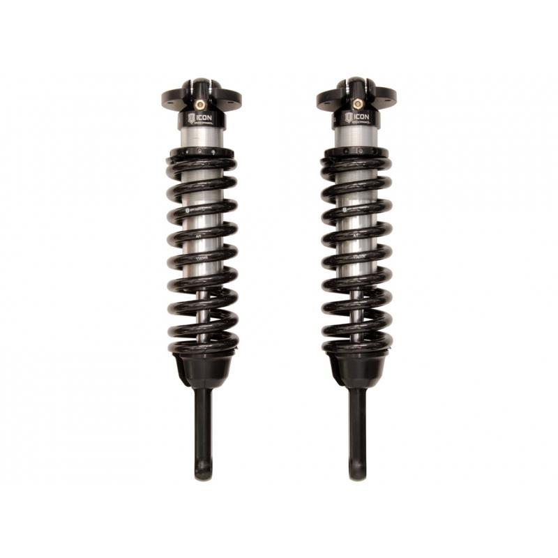

ICON

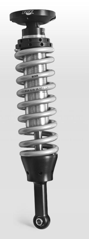

FOX 2.5

Depending on the aftermarket weight you may be looking to add,
ICON, KING and Radflo offer flexibility in upgrading the coil.
ICON comes standard with a 650lb coil, but can be upgraded to 700lbs.
KING comes standard with a 550lb coil, but can be upgraded to 600, 650 and 700lbs.
Radflo 2.5 comes standard with a 600lb coil, but can be upgraded to 650 and 700lbs.
FOX 2.5 Coilovers come with a 600lb coil.
All the coilovers listed above also come Standard or Extended Travel (Requires Aftermarket UCA).
