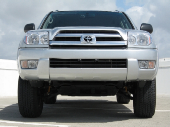

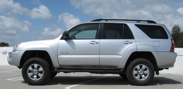

Just installed yesterday. I need to perform a final setting of the front shocks and get the tires aligned too. I'll see about new tires a little later as the ol' Duellers are only a year old. Look at all of the daylight underneath the front! :bouncy:

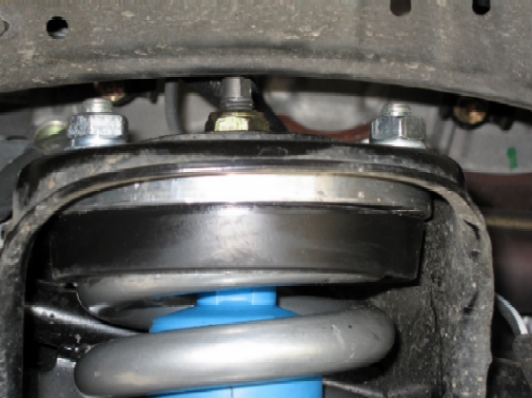

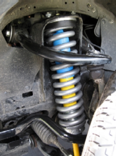

strut
Built like a tank as they like to brag at Downey. If you look at the fitting below the coil you can see the holes for the spanner to rotate it and adjust the height.

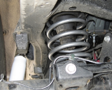

Rear spring, shock and stainless brake lines
I recently drove a new Tundra 4WD crew cab for a week and I really like my 4 Runner much better
Look's awsome !!!! Lifted runner's look soooooooo damn good !!!!
No offense intended , but the front end height has to be changed. That nose high thing does'nt look good.
Definitely agree on the looks... :) The better ground clearance is going to be awesome too! The crazy thing is just how much better it rides. That soft-squishy no rebound dampening OEM ride really bothered me Way too much like a passenger car.
If you read my first message you'll see that lowering the nose is already in the plans. I was advised by Downey to give the springs a week to settle in a little. Realigning the front tires will also help a bit to bring the nose back down. I want it to end up a little nose low so that heavy loads in the back don't push the nose up too much.

Is the heigth adjustable on both the front and back? If so, why not adjust the rear higher?
Thanks! I don't know how I waited a year to do this mod. I love the way it rides, especially through deep ruts or over big bumps.
The cost of the kit with sales tax would have been close to $1600.
I don't have all of the tools nowadays to do the install. I decided that I would be willing to pay if the price was right and skip buying tools that I might never use again. I asked Downey to recommend someone local and I got a killer deal from the guy. PM me if you need to get details.
The height is only adjustable on the front. A stock 4Runner is 2" low in the front. The Downey kit's rear springs add about 1.5" of lift in the back so the front needs about 3.5" in front to get things level.
