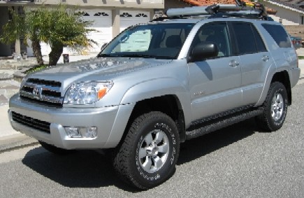

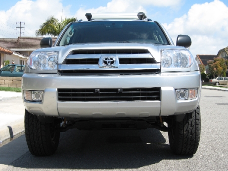

new lift pictures
readjusted front coilovers and added Revo 265/75/16's
Falls said:
Looks much nicer leveled out.....nice job !!
Thanks for the feedback!

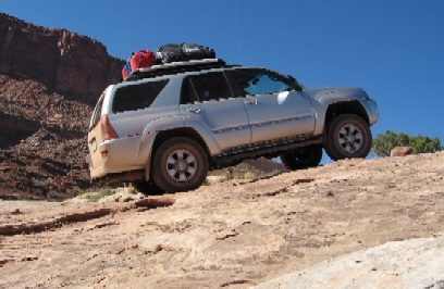

I just got back from my trip to Utah. My friend drove his stock Sequoia and I had more clearance and could drive faster offroad than he could. I carried about as much weight and still got better gas mileage. I can't wait to go offroading again.
