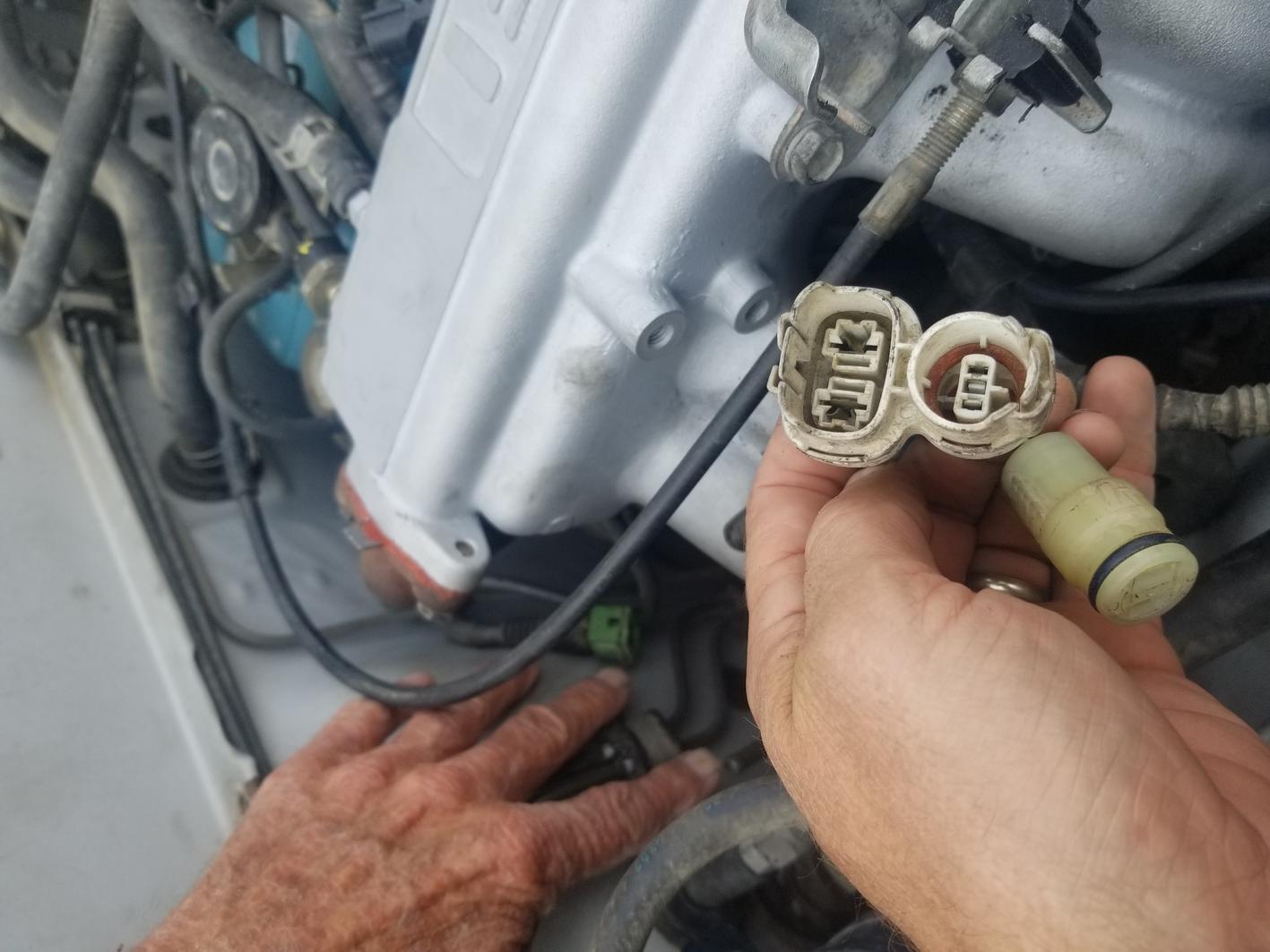

So, I think I have everything but one plug figured out and got the life of me I can't seem to find what it is or where it goes! I'm thinking maybe it goes to something I don't have and that's why it's dirty? The one I can't figure it out is the top oval shaped one in this pic. But if anyone knows what it is, please tell me! Thanks!

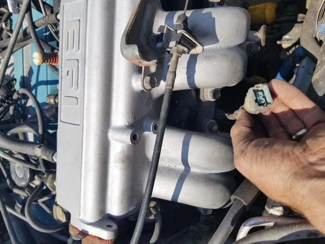

Pretty sure that's for the auto transmission but also don't know where this one goes. Anyone??

This one is for a VSV. Now i'm not to 22RE knowledgeable but check on top of valve cover or passenger side wheel well for a VSV that's not plugged in.
Thank you! Found it. That was (what I thought) was the very last thing i needed to figure out before i put fluids in and started her up. I purchased a performance engine (block, head, timing) and then replaced most of the other parts, plus resurfaced intake, etc. Also replaced my leaky power steering gear and pump.

It the plug for the auto transmission version. Mine is manual.
