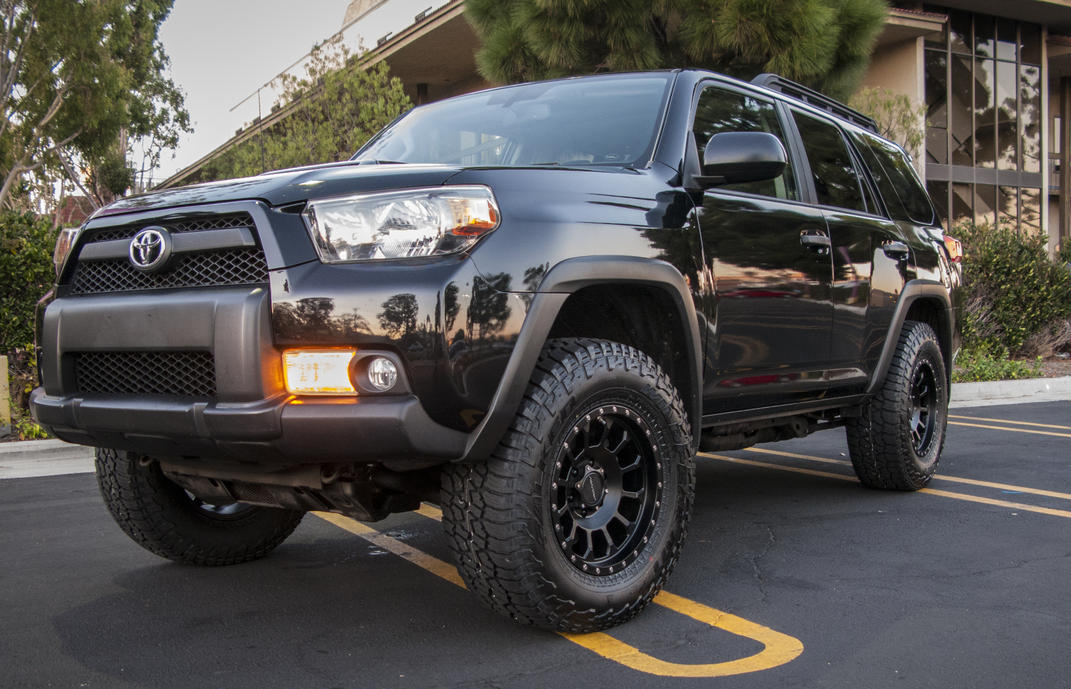

Just had these mounted up today. P285/70R17 and the ride is way smoother, more comfortable, and much quieter than the E-rated Goodyear MT/Rs with Kevlar that I pulled off. Wheels are Pro Comp Rockwells 17x8.5 0mm offset
