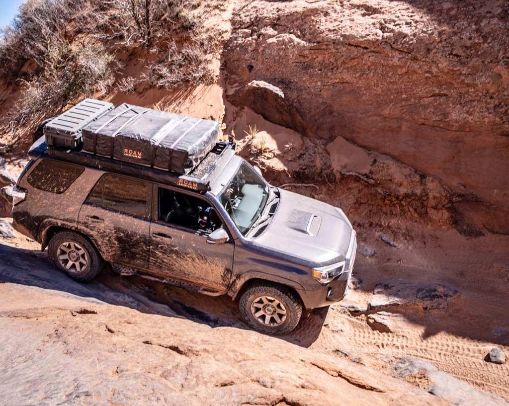

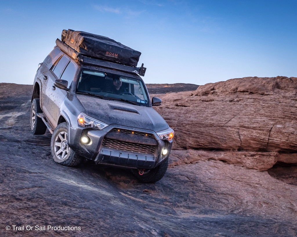

I am confused... P Metrics should not be aired down?
I only ask because I do this regularly. In the pictures below are my 265/70R17 P Metric Wildpeaks aired down to 17psi in Moab at the beginning of this month. At this point they had ~38,000 miles on them...
I ask because I have never heard that before, and I am curious as to why... and if it is going to bite me later on.
Cheers!

Not that they should not be aired down but you have a much greater risk of blowing a bead airing down P-metric tires. The sidewalls are much softer so when you air down they will bulge out much more than an LT rated tire thus leading to greater chance of blowing a bead. I wouldn't air down any to less than 25 psi with a P-metric. Don't worry about any long term effects or consequences, I just wouldn't air down too far in the future on a P-metric.

There is a YouTube video out there that demonstrates the difference by driving over an object at different tire pressures and seeing how many times you can run over it until it fails. I'll see if I can find it. I think that the results were that the P metric tires were more likely to pop (not talking about losing a bead) when aired down compared to not being aired down. But if they are fine aired down to 17 psi and you haven't had any problems, I don't see a problem. Just make sure you have a spare. :-)
Found it. According to this test, aired down you are less likely to puncture it. Not sure if there are any tests for losing a bead and at what PSI you would be at risk. Sounds like 17 PSI if you have not lost a bead actually will help you avoid punctures off road.

Thanks for sharing that! Yeah, we always have a spare, and it looks like we will have 2 in the future since we got some rims donated to us. We've run all kinds of terrain in the P-Metric A/T3Ws without issues around 17-20 psi. So, I think we will stick with around 20 psi.
Having run much lower than that on a regular basis, I'm not too worried about it - mostly the long term effects which don't seem to be a problem. This does make me wonder though... I have tried E-Loads Duratracs and a few others. My wife really didn't care for the stiff and harsh ride. I didn't care for the additional rotational weight (MPGs took a huge hit)... I wonder if the LTs do a good job of splitting the difference.
Cheers!

Here is the thing. There is ZERO testing of P metric offroad that I have seen. But I since I have done a lot, I no longer care either. You and I are literally some of the very few folks who 1/actually offroad on P metric and 2/post about it on forums.
I am at about 4,800 off pavement miles on P-metric tires, of which 1,826 on the Wildpeaks (yeah I log all unpaved mileage). Speaking of the Wildpeaks we have done
at 30-34 psi:
--544 miles in UT, including most of the Maze district and Moab trails like Tower Arch, Fins and Things, Deadman Point, Hurrah Pass-Chicken Corners, Rainbow Rocks/Terrace.
--605 miles in Montana, mostly mild stuff, two rocky trails but the rocks were not sharp at all.
--677 in Arizona, including everything from Double Crater volcano (we actually claimed it and drove on the rim), most Sedona trails (had done the balance previously), north of Phoenix trails, west of Phoenix trails, and west-central AZ.
I only aired down for Double Crater and then once later.
I got one puncture at 33 psi in the desert, when moving at a good pace (well, stock suspension so not great pace), that was on Red Raven where lots of small sharp rocks are embedded in the surface of the fun, mild trail.
Because of that, when I did our next trail in that area on a different day trip, I decided to air down to prevent the classic case of "balloon" puncture. I moved about twice as fast as the Jeeps. Six miles later I tore a sidewall on the rear driver side tire bead to shoulder. No idea why exactly. I was in the lower 20s psi so not really low and the terrain was mild with a ton of small sharp rocks mostly pushed to the side. I may have scraped one of the bigger rocks on the side, I don't know. We were not crawling so I was not paying too much attention to wheel placement.
Bottom line is, there is always a higher chance of puncture when using a P metric tire. If at street pressure, the danger is puncture through the tread. If aired down, the sidewalls are exposed. This is the predicament of the SL.
So why do I do it?
It is all about personal use and location. I am no fan of airing down and up, which is required with LTs for comfort. I much rather stop at nice places on trail. Most people I know either use MTs or LT-Es ATs. But they either have dedicated trail rigs or do a lot less highway than I do.
So at 140/tire and free replacements it works for me for now.
When will I walk?
If I burst a sidewall at 30-33, where I have been fine for so long on different tires and vehicles, I will have no choice but to get tougher tires. Until then, I am happy with the Wildpeak value. My offroad tires don't last long so value matters.
What will I get if needed?
I have my eyes on the brand new Firestone MT2 in 255 75 17. It is only 47lb, it is LTC, and yet has a three ply sidewall. It is MT but the newest one around alongside KM3, so I would expect highway manners to be acceptable. But yeah not great for those trips from Arizona to Montana.
Not that they should not be aired down but you have a much greater risk of blowing a bead airing down P-metric tires. .
Yes and that's why I don't air down, actually. They flex great at 33 so traction is not an issue and are comfortable enough as well.
Cooper Puncture Test
Yes, that is a good one, thanks. That's for tread punctures though, not sidewall punctures.
That's the trick with a P-metric. You either take the puncture chance or the sidewall chance. I prefer the former! Plus, I don't want to air down/up.
