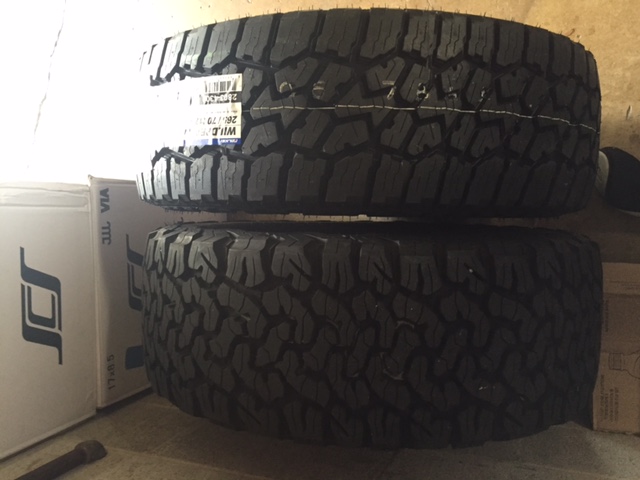

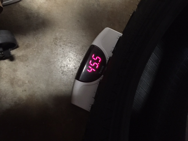

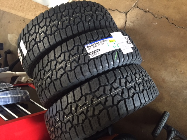

I just received my 265/70/17 Falken AT3 tires for my Ray10 SCS wheels (going on my 2006 4Runner).
The sidewall is quite soft compared to my KO2 E-rated (2ply vs 10ply).
