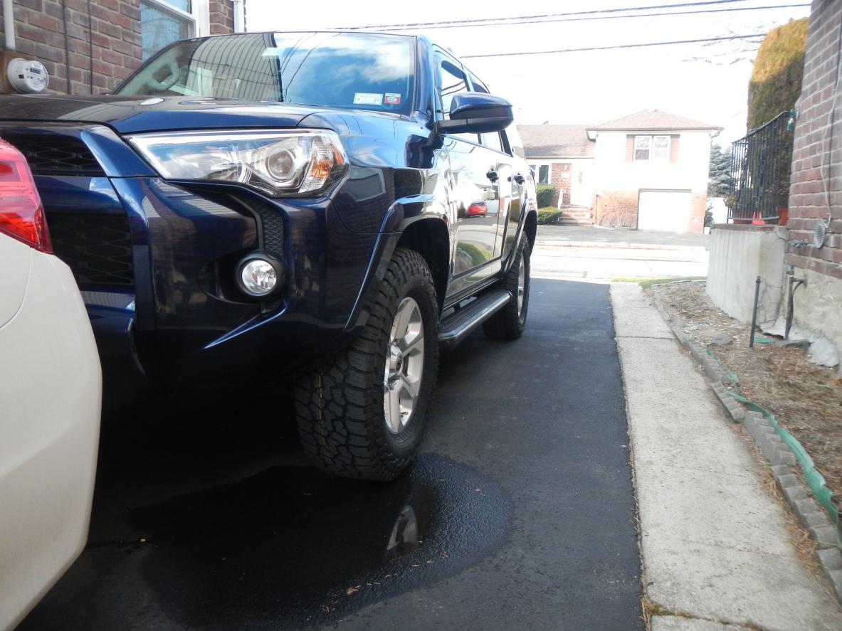

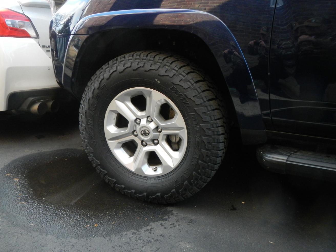

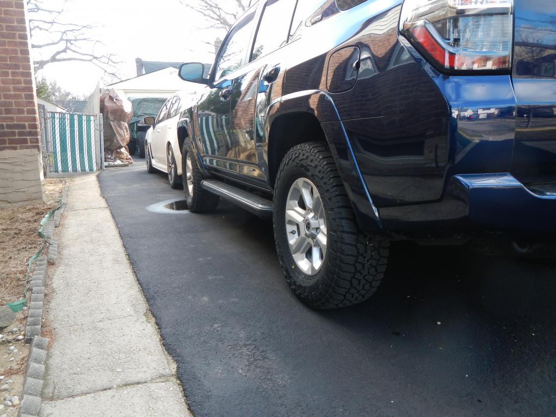

I got the Wildpeaks put on this morning. This is how the 4Runner should look! I'll paint the wheels black come the spring then I'll be all done with mods on the truck. Yeah, right. Stock size SL load rating. Cheaper, lighter and only a little shorter than 275 LT's. Took it out and got to 75 MPH with no vibrations at all so the shop did a good job. Quieter than the Grabber AT2's I had on my Grand Cherokee so I'm happy.
Did you notice any power/ acceleration loss?
